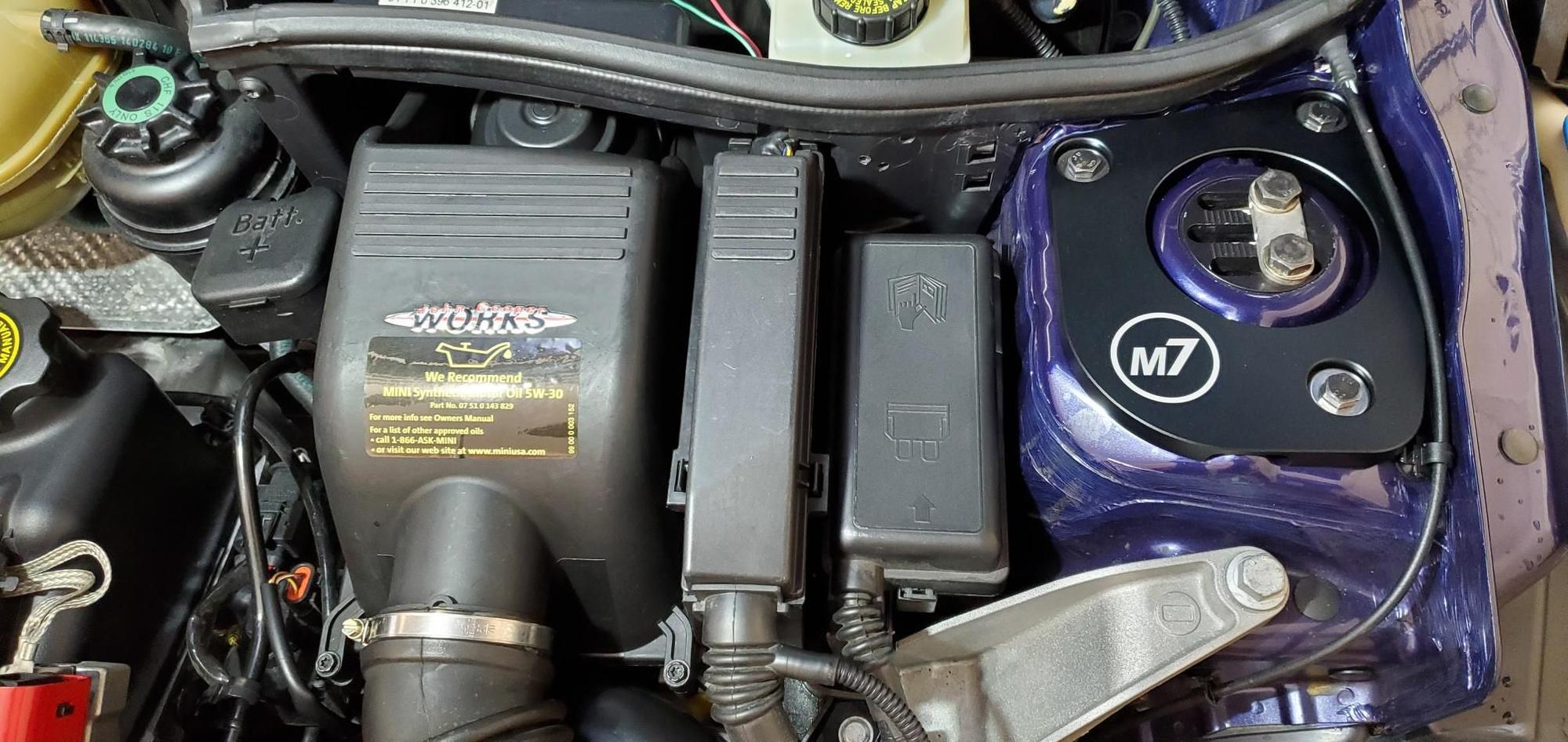

I was able to purchase the set shown below (not from ECS) prox 3 years ago, which were then available in a BMW Germany warehouse location. Those P/Ns worked quite well for my lightly optioned slicktop R53, with specific spring rates meant to correspond to as-built vehicle weight. Further, I reused the thick Helix adjustable camber plates (NLA) which were installed as part of tracking mods when my car was new, which resulted in combo of ground clearance and stance that appeals to me visually, as well as ride compliance vs the Eibach lowering springs which I removed at that time. With all that said, seems JCW "reds" should also work well with the Vorshlag plates?

^^^ Camber plates assembled on struts as a unit and "sandwiched" between tower sheetmetal and M7 plates. Very rigid combo! I bought that B&D Workmate new for my late father, regretfully sold during garage sale last summer before I moved from there.
