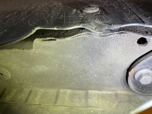

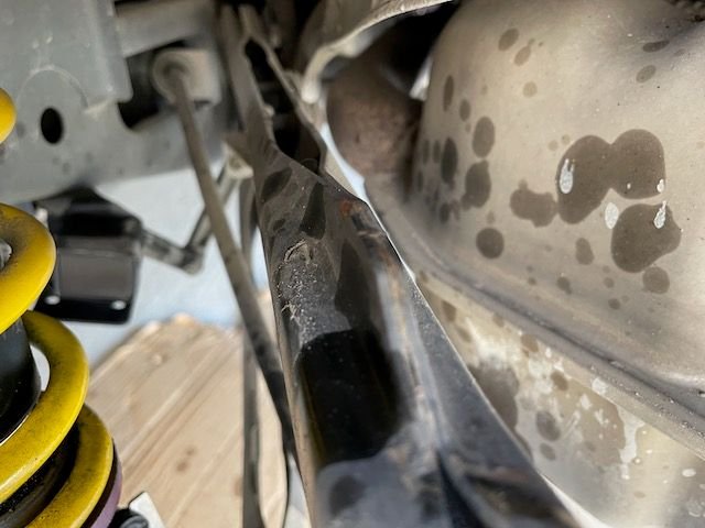

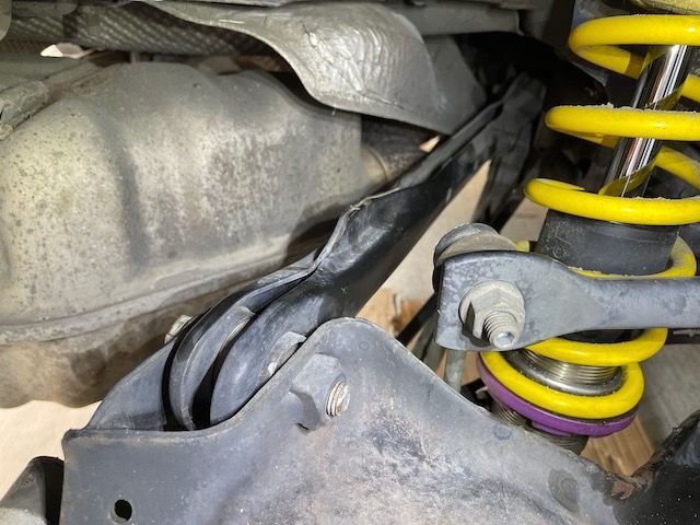

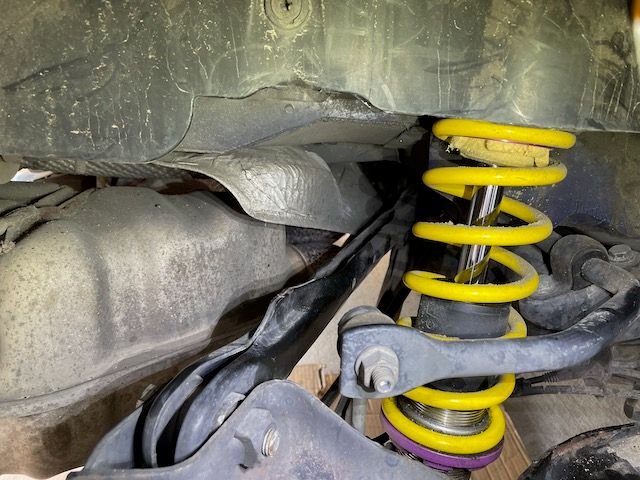

over the weekend I lifted the springs. I'm at 16 threads from the bottom of the shock to the bottom of the adjuster. as a reference to anyone with kw v1's. the springs just start to compress there. so I stopped.
the wheel arch is right at the top of the tire now.
tested it and no more bottoming out.
while I had the wheels off I discovered the source of the banging sound. the trailing arm was hitting the frame. I'll post some pics. the bump stops are smashed.

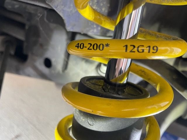

Also found what is think is the spring rate on this kw kit, 40-200 lbs/in progressive, I think. post a pic of that also. so very close to stock if that is right.

so the question remains. what's the right spring rate?
these calculations:
I'm sure someone has these numbers for the r53
