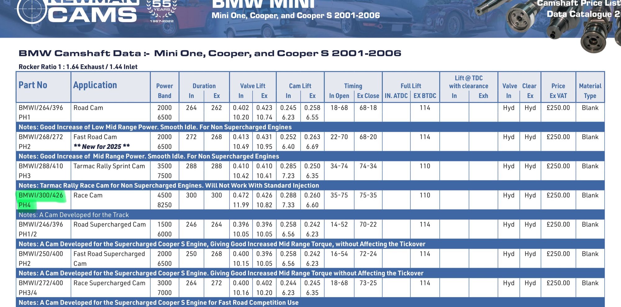

• ph4 Newman cam

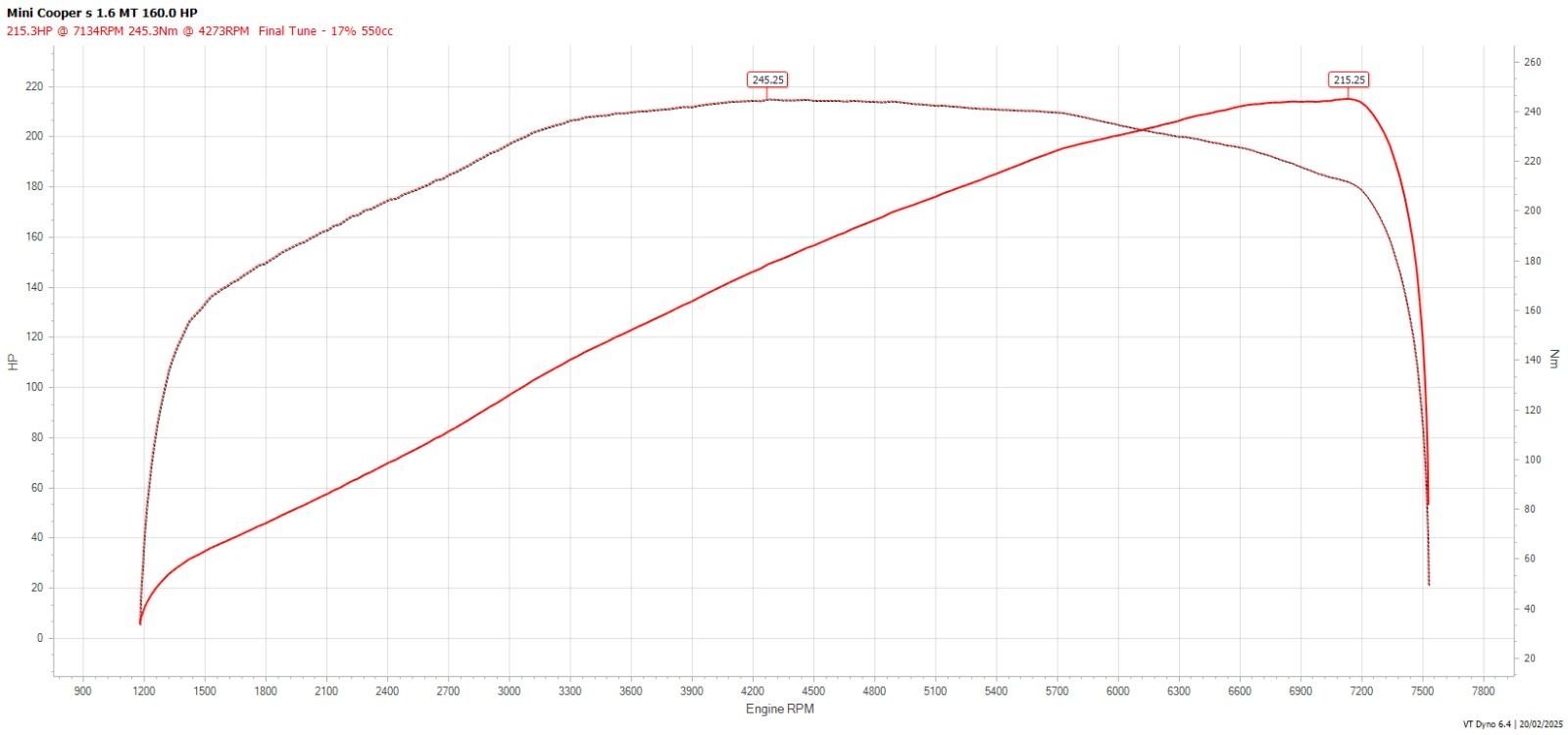

Dyno printout.

It was mapped on 99 fuel, haven’t looked into any other injection sources yet, probably won’t depending on cost.
I would have thought the engine was warm when the garage did the tests due to it being on the dyno that day, but I wouldn’t be able to say for sure.
I’ve looked up the cam info on Newmans site but as far as compression and what not I’m clueless.
I don’t know what type of dyno it was their website says it is a V-Tech 4x4 dynometer (state of the art).

Your dyno is showing ~215hp at the wheel which is ~247hp at the crank. To get much better than that you would need (as BlwnAway says) much better breathing that equates to much more cash spent and then your gains would only be minimal. Your engine's small displacement will carry you only so far.
BlwnAway said 240-250WHP with a BVH which would go with what the dyno guys were saying. That’s what I’m trying to understand alongside the top end ticking they were hearing and the low compression, they said it could of been the timing chain rattling or I thought it could be the rocker arm dampeners either seized or not gapped properly. Not sure what the gap is supposed to be I can’t find manufacturer specs for this. But I could quite easily check chain tension by just taking the rocker cover off if it’s not that then checking the rocker arms but my main wonder was what else could it be? Apparently it gets louder and more pronounced when it’s running at higher revs.

I can send a link to the manufacturers site n a picture of the specs, maybe you would understand what it’s showing. Surely there’s a point where a cylinder is completely closed for combustion? Can you manually crank for a compression test or not really possible? I’d have to get a gauge either way as I don’t have one.

PH4 Newman Cam

The PH4 is for the supercharged engine, the notes are for the above cam. Notes for the PH4 is “developed for the track”
could you explain each of the columns and what the numbers mean please so I know for future reference. I’m clueless on it atm.
I am not knockimg tour tune or tuner capabilities but i am wondering if you would benefit from a tune revision by adriancl on this forum . He has been known to have looked over some well known tuner files and had to adjust them. Just an idea.
. What are your afr readings at higher rpm? Those 550cc if not tuned properly can definetely cause power issues, but then again you may have had engine code show up.

Simple explanation is lift is a measure of the cam lobe height. The higher the lift the longer the valve stays open. Duration is the amount of time the valve stays open. Both combine to allow more oxygen to either enter or exit the cylinder depending on whether it's an intake or exhaust stroke. An engine, at its most basic, is simply an air pump. The more more air you can move through the engine, the more fuel is required (hence your larger 550cc injectors needed because there is more air flow with that cam), and the more power it makes. Power band simply indicates the RPMs where the cam is most responsive. In your case, the PH4 cam is meant to maximally operate and create the most power between 4,500 and 8,250 RPMs which is where it would be most beneficial on a track.
Yeah, Orranje lists the PH4 as an R50 cam. It’s probably better to verify with Newman themselves, but that’s what I thought I remembered from when I bought my PH2 (which is still sitting in a box because life happened). You should probably also figure out whether you actually have a PH4 or a PH3/4.
