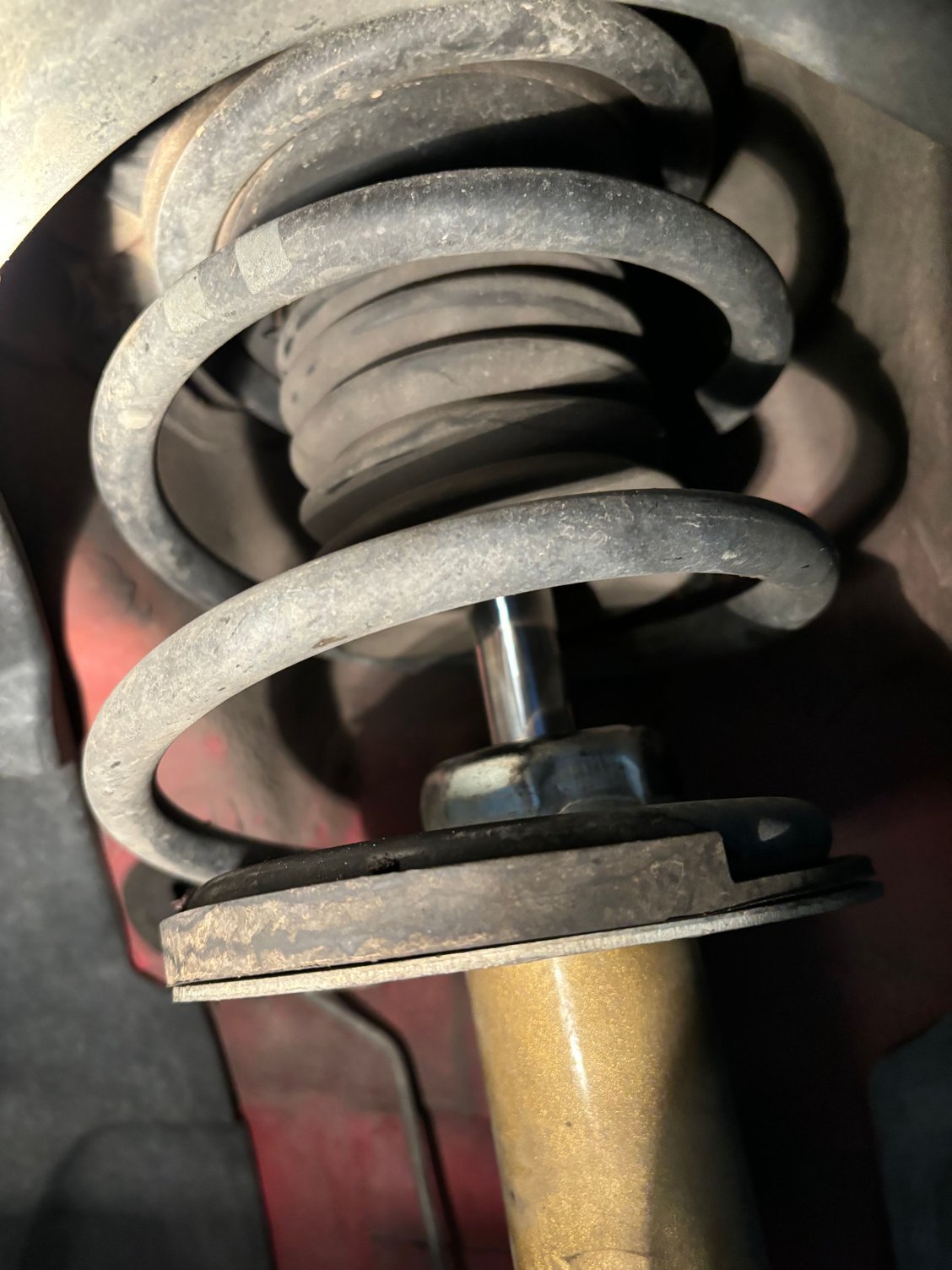

I’ve got a right front suspension loose noise over broken pavement that I’m trying to diagnose. It sounds like a torn bushing but the control arm bushings look ok. I replaced the axles and end links and double checked the torque. There is a slight clunk when moving the road wheel from the 3 and 6 positions so the inner tie rods need to be checked. The sway bar bushings are the prime suspect. I’m trying to get through autumn before dropping the subframe.
This car has 10 year old Koni FSD gold struts (which require stock spring length) and the sport + springs which are 10mm shorter than stock. The strut mounts have fine cracking but aren’t torn.
Sport + front springs

At the risk of sounding officious (I'm not a mechanic by trade); I know it can be a PIA - but if your going to pull your front struts; I would recommend inspecting/replacing your top mount bearings.
Even if they don't appear cracked or torn - You might just be surprised at how compressed they are compared to new ones. With some brands even after only 25k .
Spend the little extra $ on OE or OEM. You should at least get 2x the mileage from them in the long run.

I agree wholeheartedly. And while it’s out I am seriously considering installing lighter springs (sport) and new rubber bits to tame the harsh ride. Still, I don’t think that is the source of the noises. I may have to drop the subframe sooner than I would like.

Thanks Buggy for the info on the rear strut mounts. My current issues are in the front. I’m dropping the subframe next week to replace the sway bar and control arm bushings plus the inner tie rods. The inner ball joints look new.
The car came with Koni FSD gold struts with factory SS+ springs which are 10mm lower than the stock springs. Since Koni doesn’t allow lowering springs with these struts they may be damaged already. I’ll be going through them soon to determine why the springs don’t move at all when pushing down on the corner of the car.
