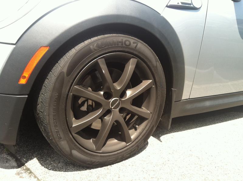

Post a picture of your car, and give a height from the ground to the top of the wheel arch. That way we can see how low you like it. Also give some other info, like tire size, purpose of car (daily driver, autocross, etc) and your budget.
Mike
Good call Mike.
Spirited Daily driver. I bought it for my son, but I get to ring it out often. Trying to keep the budget under control.
Riding on 16" Borbet, with Kumho 205/50ZR16 87W tires.
F: Two fingers between tire and front arch, 24 1/4" from ground to arch
R: One finger between tire and rear arch, 24" from ground to arch
BTW, sorry for the dirty wheels.

That is a reasonable ride height, looks like the car should have from the factory. That is pretty close to the same height as I'm at with TSW springs. I have heard that they are on back order, though. I'm very happy with my setup (koni yellows almost full soft).
I have read good things about NM springs and Koni Yellows as a combination. You will also need to trim your bump stops (or get aftermarket). I have also read that several people are happy with swift springs.
