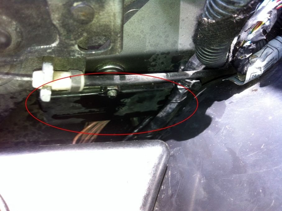

Since your Mini is a 2003 - you may have this "ballast" (with cluster of wires connected to it), mounted to the frame (on the left or right side of the engine compartment), secured by a single 10mm nut.
This 10mm nut grounds the ballast and all the wires connected to it.
My 2004 pre-facelift has 2wo - one on each side (L & R) just underneath the hood latch release cables.
I discovered one of the ballast grounding/securing nuts missing. This missing nut caused all sorts of intermittent voltage issues with my gauges.
Check to see if you have this/these "ballast" on your 2003. If the nuts are loose or corroded - clean up the grounding contact surfaces and make sure the 10mm nut is clean, nice and snug.
If you don't have this type of "ballast" - Trace the wire from the oil temp gauge to the oil drain plug and see if there is a loose connection or short. Check it's ground wire (most likely the cause) too for corrosion.

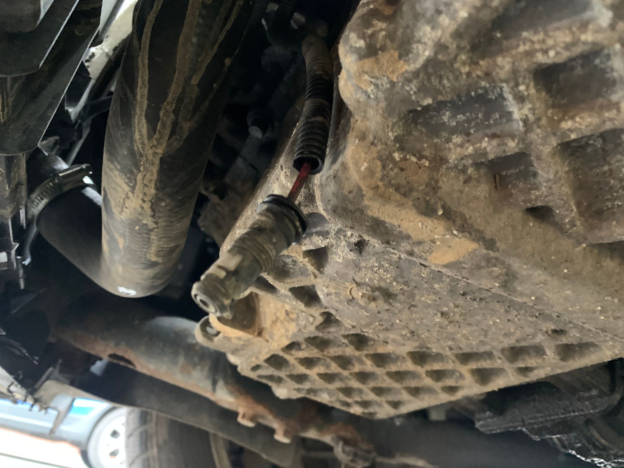

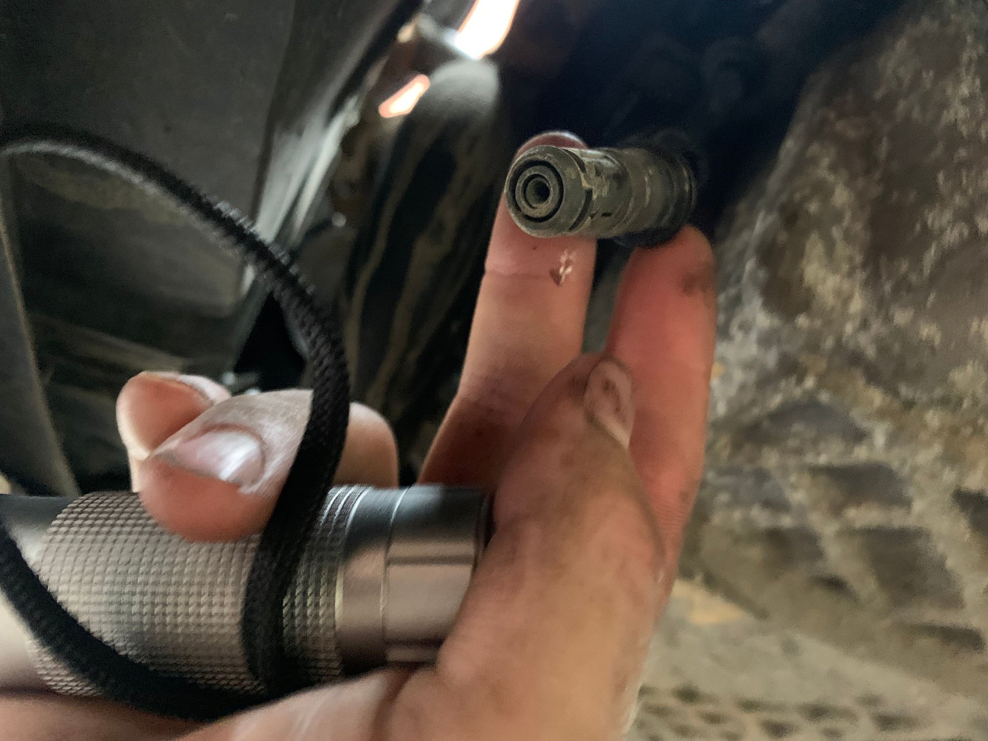

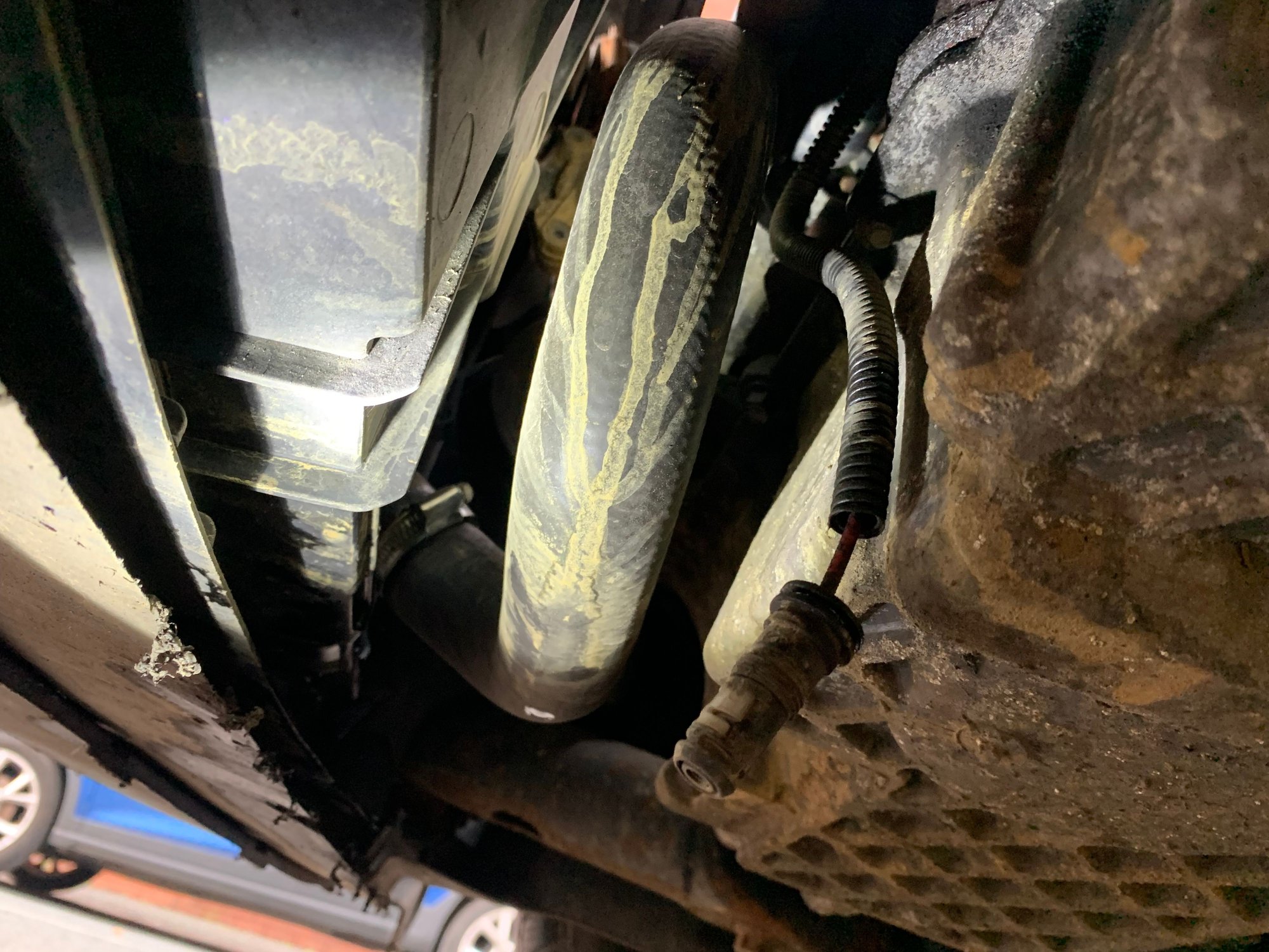

Not the bolts they seemed to be in good condition a little dirty but unlikely the cause, the coolant system was clogged full of sludge and crap so cleared all that out. When undoing the radiator hose i noticed this lose wire under the car this is pictured below, anyone know where this should go

It seems unlikely for an R53 - but that end connector reminds me of an R50 hydraulic clutch slave connector (?).
I've not encountered that wire/connector as of yet on my R53 and I know very little with regards to an R50 - So, I'm sure my preceding comment is way off.
I would be very interested to know what that is myself.

Plugs into the back of the Alt or a/c compressor. can't remember which. It will be obvious when you pull the nose.

Its on the A/C compressor.

Thanks for the confirmation on the mystery connector.
(I'll be replacing my oil pan gasket in the future and will have to move the AC compressor out of the way. With my luck this wire/connector may become unplugged and I'll also wonder where it came from).
