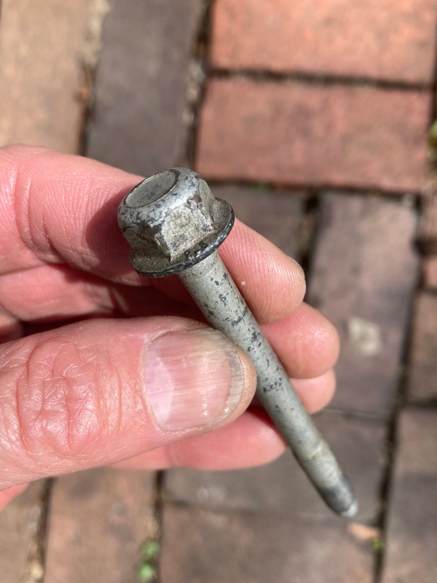

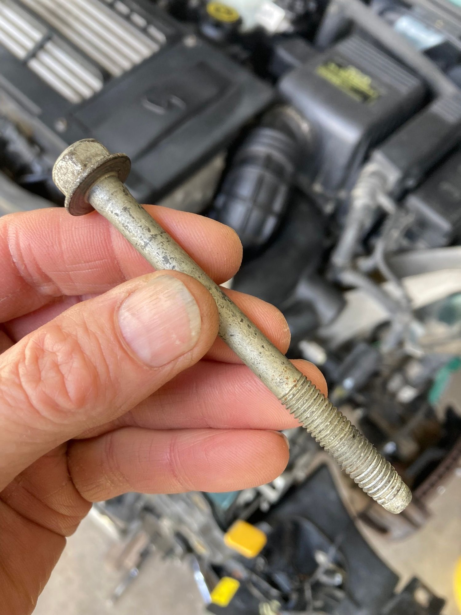

Hello,
I'm almost done reassembling my 2003 r53 , inner fender liners, and front bumper, and came across this bolt in my parts that were to reassemble.

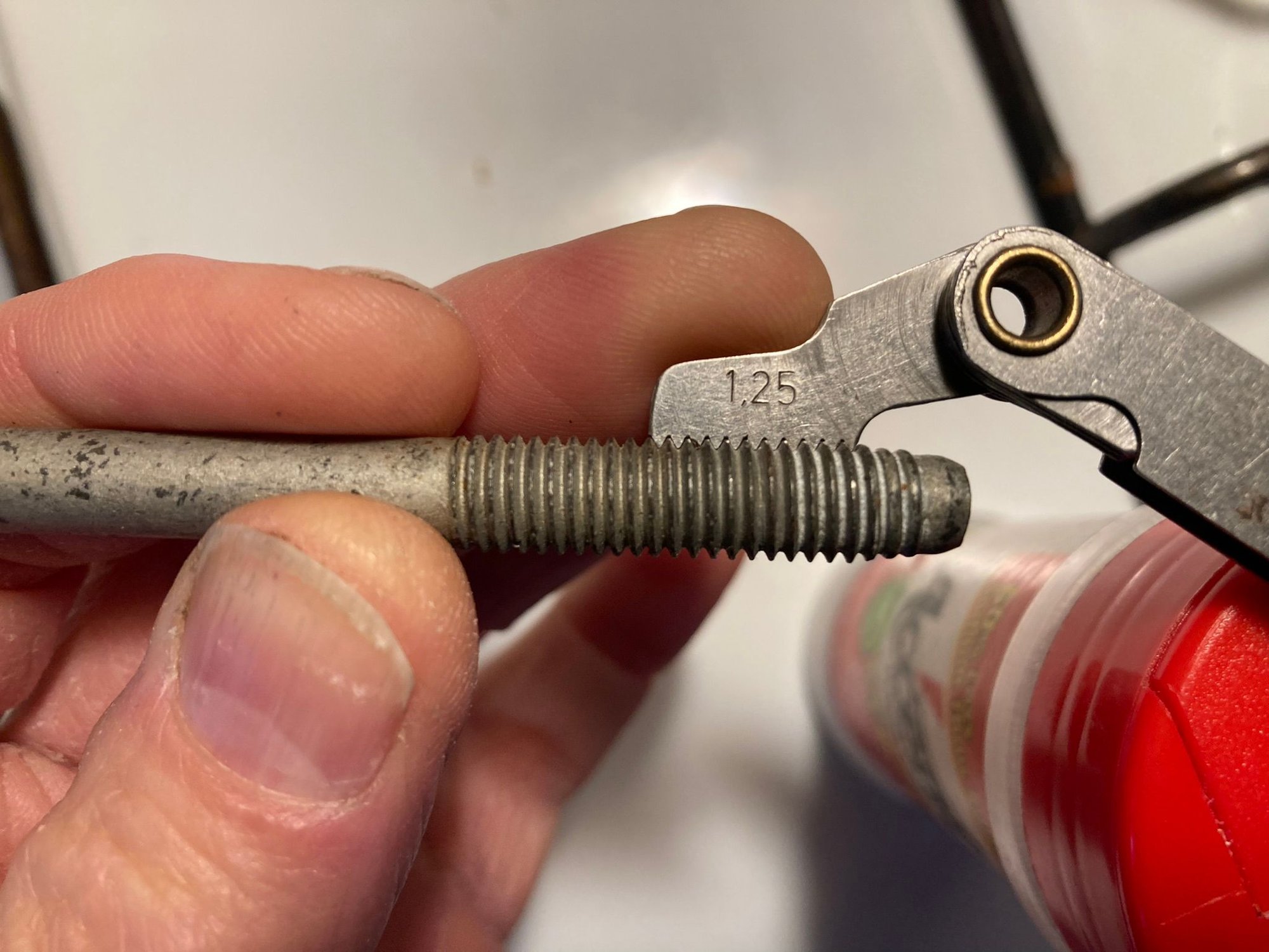

I don't recognize it, do you? It is an 8mm x 1.25 x 90 mm (3.5") long. 13 mm head, and no strength designation.
Old Mar 30, 2024 | 11:55 AM
RB-MINI's Avatar
RB-MINI
Joined: Oct 2009
Posts: 2,424
Likes: 516
It looks like one of two bolts used to support and slide the front end on when in service mode. Did you originally do the disassembly or was this a box of parts you got with the car?

SOLVED!
RB-MINI,
YES! You did it!
Until you mentioned "supporting the front end in service mode" I didn't remember.
Thank you! Working on the MINI is new to me, I usually work on Saabs and forgot about the unique pulling of the front end away from the car operation.
I was concerned that the bolt went somewhere and it did, solely to service it.
Yipee!

This thread explains it in more detail, I just used some bolts I had in my parts bins.
It is an 8 mm diameter with a 1.25 thread pitch.
