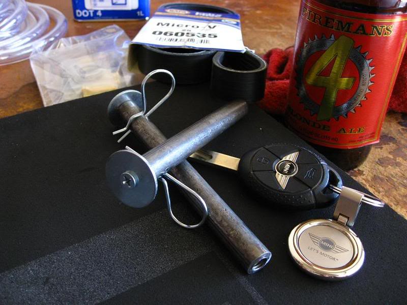

I've made two versions of these extensions. The first set was when I went, "oh crap... I need these NOW" and quickly fabbed up 4 of them out of a hardwood dowel from the local Ace, drilled and tapped for the threaded studs on the body. These worked for one use but had started to crack by the time I was done. Still not wanting to spend the money on the BMW tool, the next set I made from steel rod, cut to length (a bit longer than the BMW version), drilled and tapped (never underestimate the usefulness of a good tap & die set). This set works very well... and won't crack. Cost: about $10 and maybe an hour or so of my time and I still have more than half the rod left over. Tools required: drill press with some type of vice that will hold the stock firm and square; drill bits (even on the slowest speed and using cutting oil, I used three bits); good T&D set (I have a Craftsman set - not the best, but works, unlike the H-F set that I threw into the trash years ago).
I also added a fender washer on the end of the top two extensions to make sure the MFE doesn't slip off the end of the extensions.

Anyway... I was industrious yesterday and managed to make 4 sets (pairs) of the extensions. They basically look like the ones on minimania's site (the only camera I have right now is my phone). I even added the hair pins to hold the MFE in place (wish I'd had those when I used them). I will say they are not 'perfect' in the sense that the 8mm hole isn't quite centered in the rod. It seems that consistantly getting a hole drilled centered in a dowel requries a tool I don't have... yet... However, these holes weren't centered in the original sets I made either and it didn't seem to affect the function.

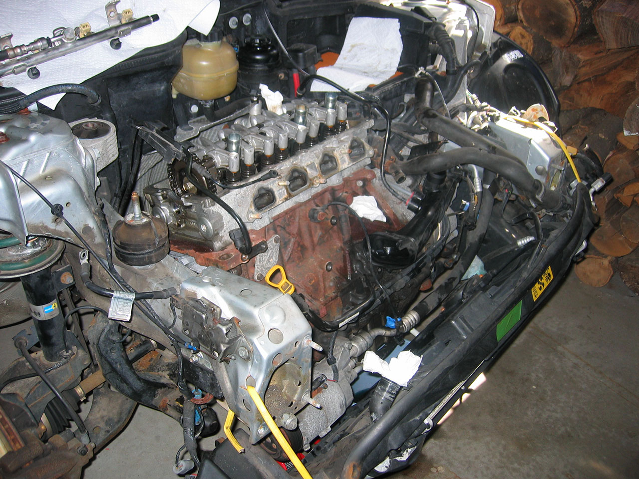

I am reviving this thread and hope someone can post pictures of these in actual use. TIA

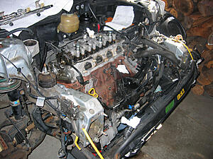

They thread in and allow you to slide the MFE (black plastic radiator surround with radiator and attached goodies) forward a few inches but still leave it "attached" to the car so you don't have to pull all the hoses and such. Puts the front end in "service mode" so you get a few inches to get you hands in for servicing the stuff that's between the engine and the radiator (supercharger, water pump, etc.)
