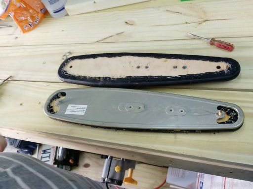

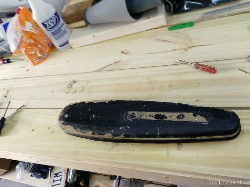

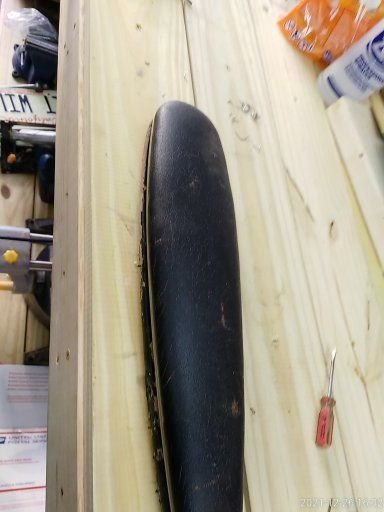

Can anyone tell me what armrest this is? I haven't found one on google yet. It is in terrible shape and obstructs the use of the e-brake. I don't think I like it.

A NAM member @Jonny (I think) posted a picture of (what I believe) he referred to as "MiniFini" ? (spelling?) somewhere, last year in the "what did you do to your Mini today" discussion thread.
I cant seem to locate his particular post but it seemed to me that that armrest maybe rather rare.
Might be worth keeping and/or restoring!

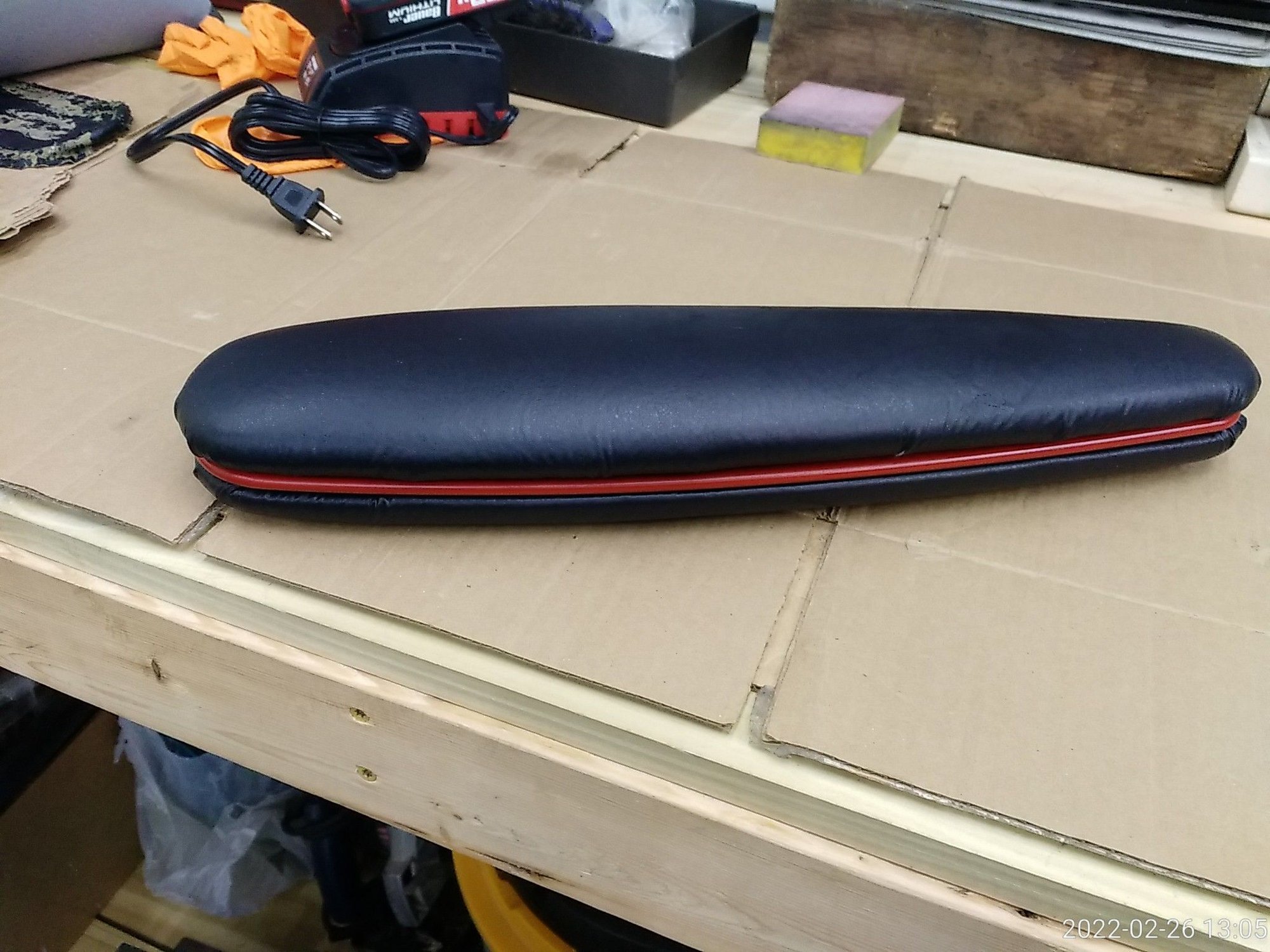

I have this arm rest on Red Thunder II. It does get in the way of the e-brake and for me it's mostly up until I am on the highway cruising. Then it's great- not flimsy like many other ones you see. If you decide to get rid of it let me know, I'd be interested in taking it off your hands. Here's a few pics of the resto:

Yep that's the old MINIFini armrest.
At one point it was sold as a Genuine MINI part till they stopped doing business with them.
I think I may keep it for now but will let you know. I am so new to this that I don't know what I don't know. Maybe I need an armrest? I had an FRS and they don't have an armrest and I didn't mind. Maybe a Mini must have one?

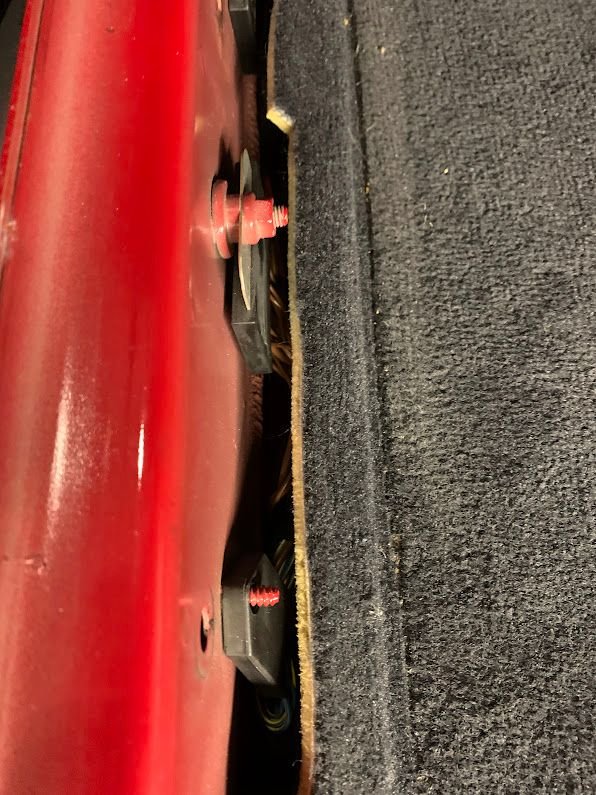

In the picture below there are two grounding screws; one has a nut on it and the other one doesn't. The screws have different threads on them. There are two on the drivers side and one on the passengers side. Am I missing some nuts?

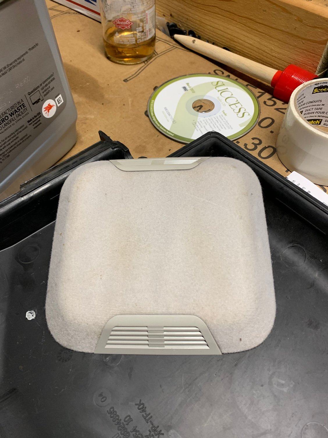

How do I recover this?
I have redone my headliner and it looks great. Actually, perfect. One tip if you are doing this is it turns out way better than you think it will. I kept rubbing and rubbing the material making sure it was even and stick well. It looks better than I thought it could.
i do have a question: what do you do with the back vented gizmo? It seems to have a thinner material than I used. There doesn’t seem to be any foam on the back of the material. I could clean it up or attempt to redo it. Thoughts?

I had re-done my headliner a couple of years ago -including this immobilizer cover. I attempted to clean the yellowing fabric from the cover but was unsuccessful. The material I'd chosen was a bit thicker but matched the original headliner very well. I was able to remove/detach the original fabric from this cover with MEK diluted with a little bit of water. However - my plastic grilles literally crumbled when trying to (carefully) remove them. I ended up scoring a perfect one from an '06 at a salvage yard. I was able to remove and replace the plastic grilles without damage off the salvage cover. Mine were just too old.
BTW: The only reason I opted to use the MEK solution was due to difficulty removing the fabric cleanly from the old adhesive. I chose not to use "paint thinner" due to the fact that I'd felt that any residue may interfere with the adhesion of the spray adhesive when recovering.
I would guess you may not even have to use any solvent to remove the fabric from yours.

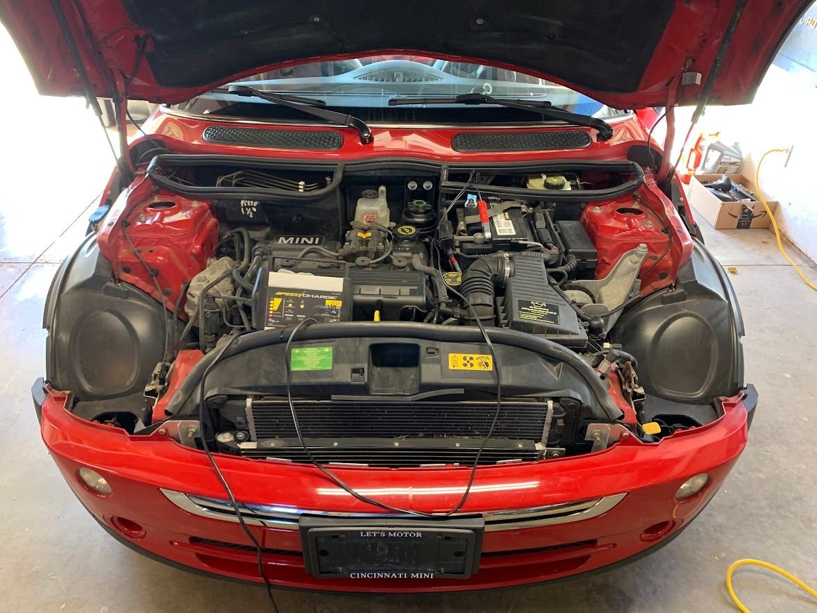

Going to start on the engine soon. Do I need "the tool" to release the belt tensioner? On an R50? I know it would be convenient.

You need "a" tool. Either you fabricate it or buy it, but unfortunately you cannot use a regular tool you're likely to already have in your toolbox because of the weird shape.
Engineers decided to make our life hard by not including a regular sized nut or hole we could use a wrench on...

Just buy the belt tentioner tool for your R50. (R53 tool is different ). You will be glad you did in the long-term.
