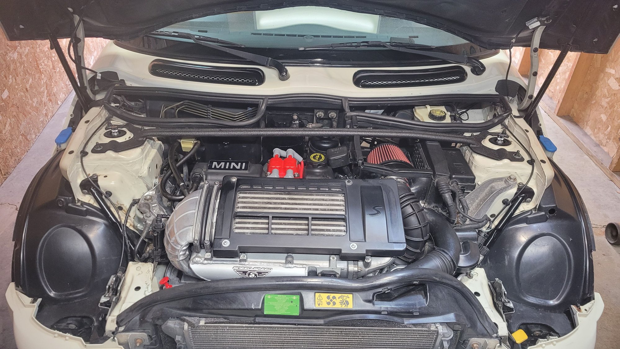

mods are :
ported facelift sc with 19% pulley , ported ic horns and ported throttlebody and intake , ported sneedspeed intake Manifold , xforce catless 421 headers and Milian exhaust , 380cc injectors , msd coil and wires and facelift ecu with factory GP tune

The car ABSOLUTELY LOOOOOVES these sparkplugs. I just swapped out the plugs and fuelinjectors both of which had only a few 1000 miless on them but were about 6months old and HOOOOOOOOLLY CRAAAAAAP.
LOL tire frier in 1st gear , it has such better throttle response than it ever has. Lol it has better throttle response than even my fully built grey mini ! 🤣
it ALSO build 18.5psi SOLID instead of a semi solid 17psi and an occasional 18psi for very last rpm. Now it builds 18.5 when it used to hit 17 and just holds it..
awesome, just awesome..
Do I suggest these plugs to others with modded engines ? ABSOLUTELY !!!!!!
