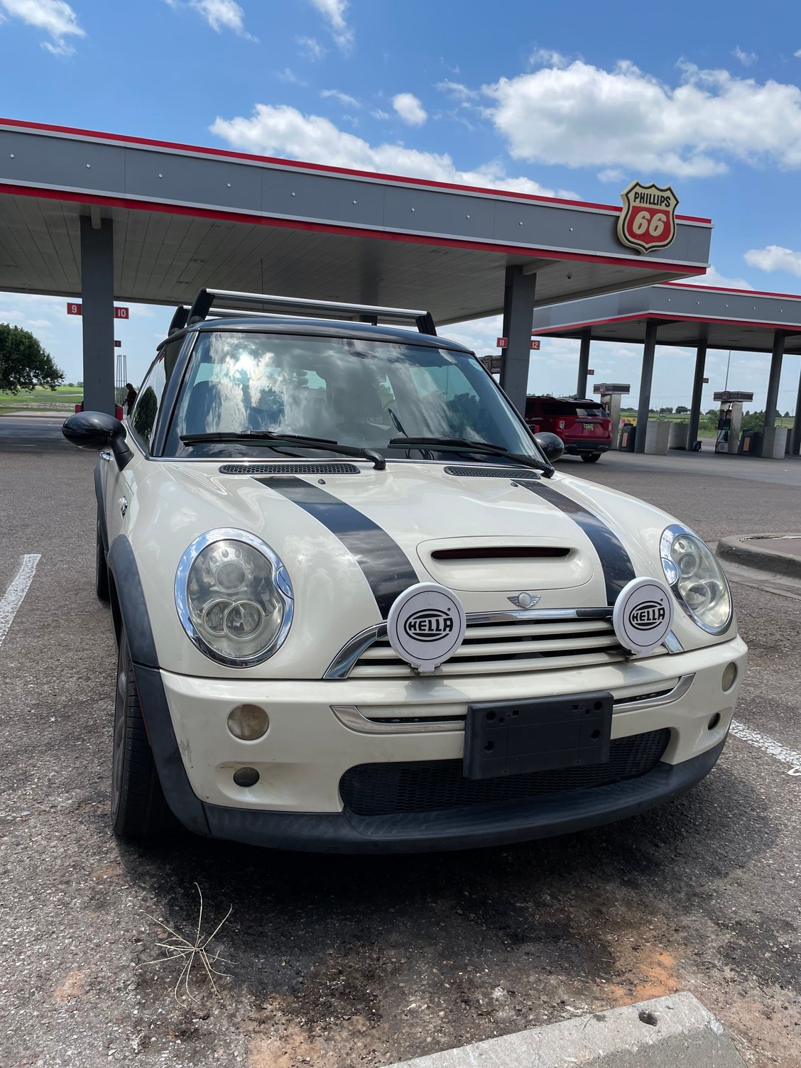

Find this in Big Spring while heading to a Walmart for washer fluid and a quick walk around.
when it struck me, we are driving a German engineered, British built, Brazilian motored, newstalgia version of a 60’s economy car turned into a rally champ off to “look for America” to quote Simon and Garfunkel.
found the Hellas weren’t hooked up to the original driving lights harness, and xenon’s were pointing at floor 10 feet in front of us, but with highs on was about equivalent of normal lows in throw, and I know i20 to i10 to home very well, so we pressed on the 4 more hours home despite mounting fatigue and dark.

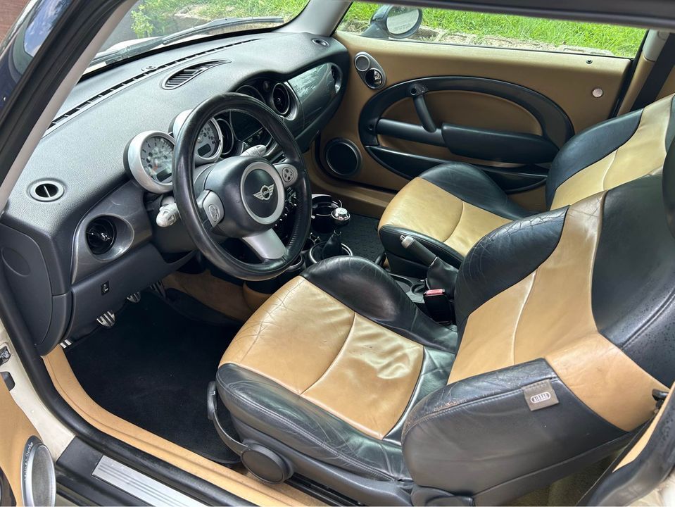

Leather is supple, even though has quite a few cracks around edge of bolster. It is also a full shade lighter after cleaning with Jay Leno s leather cleaner. some one borrowed my good Lexol to save their red leather that was rock hard and never returned it… and Walmart no longer Carries it.

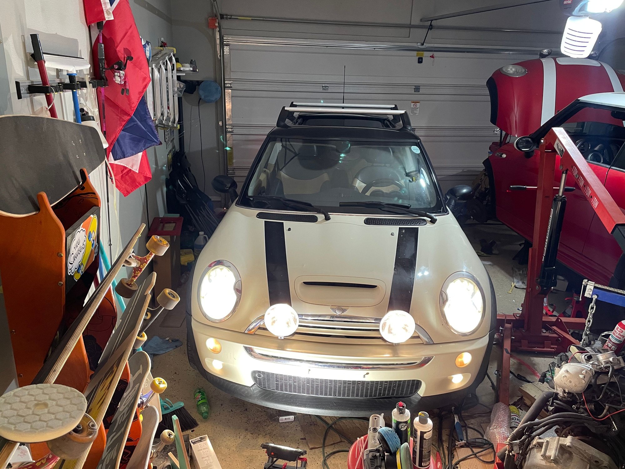

Coded the new mini. All the usuals, fogs with high beams, fogs with park, comfort close amd open, no speed lock, no two step lock, double impulse hazards,etc.
coded cold check off for the rear turn signals since they are LED to get rid of the hyperflash issue. also found where to code out the clutch switch interrupt in ews. But since this one has a sticky starter will have to wait to 100% confirm it till I can test on one of the other ones.
DiS tells me it is the right front abs sensor that is out, iirc it is the left that is bad on parts car so that’s fixable.
polished the hood just to try it out and see how it looked. Polished headlights, they are still slightly yellow but about as good as they will get at the moment.
also started UNfüćking the mess someone made of the driving light wiring. Basically I’m going to want to run new underhood positive wiring cause they cut it in random places, the big ugly fuse box is only connected on one side with the other cut off, etc. wire gauge seems a little small too. Will do more research on what it is supposed to connect to, and try to replicate that. Was able to confirm with a jumper wire that both Hellas do work. So once this gets fixed I’ll have some decent lighting at least.
Yanked the Alta diverter off, will swap for parts car’s OEM diverter and iC.
trying to decide if I want to paint it silver like a JCW with black iC face, because that looks subtle but fabulous on Alex’s JCW, or perhaps go a custom color on the diverter and a few other accent pieces.
the red accents would be great on a chili, but I’m not feeling it on the Panda 53. (Those who have watched Initial D will get the reference) so I think I will convert to factory airbox, but keep the Alta foam element. Alex’s has one as well. Can always mod it for more intake noise with one of my many holesaws, got everything from 1” to 6” sizing.

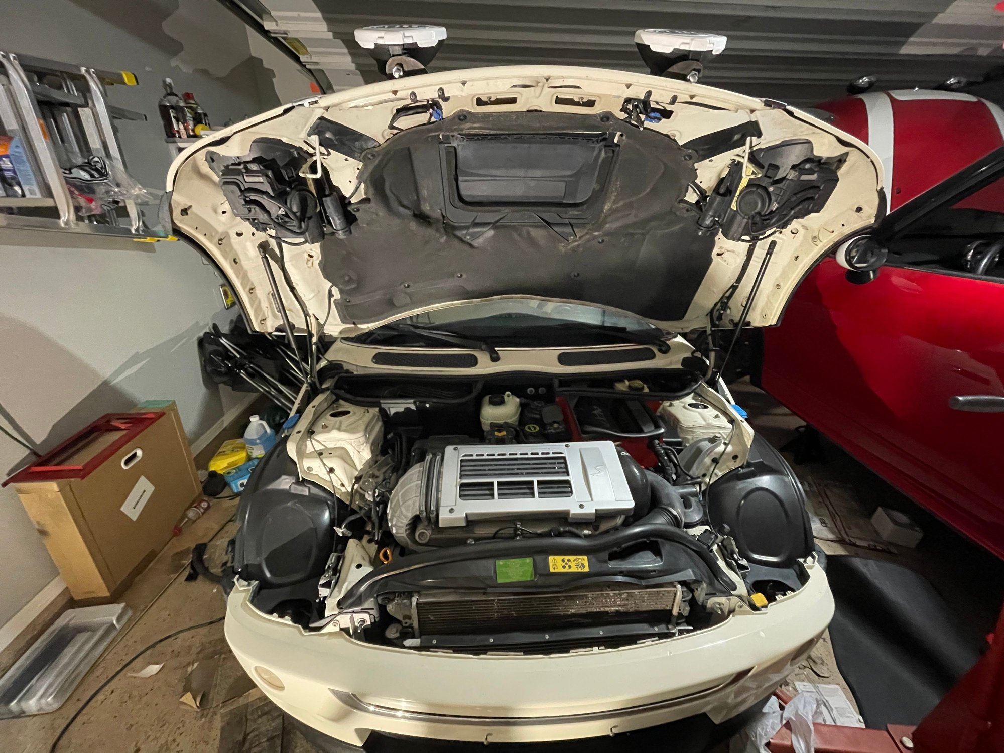

Swapped parts car to other side of driveway so I could get into the shade and partway into garage with PW. Needs a name, I suppose.
Alex’s is “Chili”, wife says her white Atlas SE is “Becky” cause it’s a basic b..ch. I suppose I could name it “Kicks”. Cause I got my “Kicks” on Route 66.

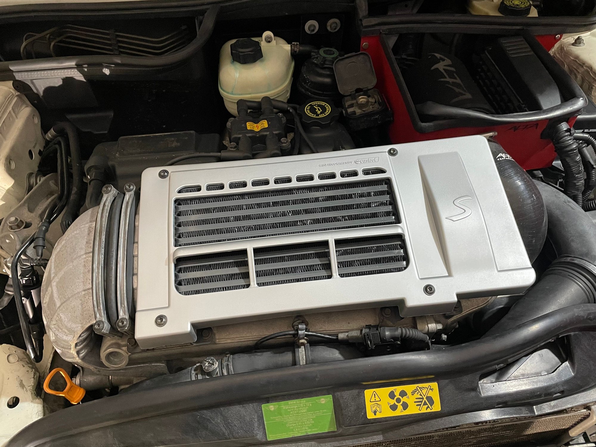

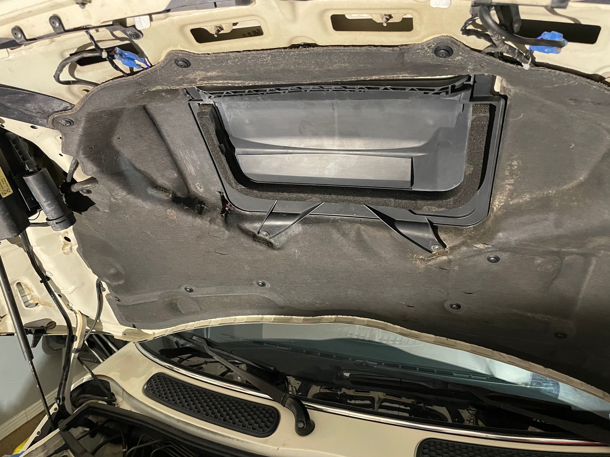

Painted parts cars’ OEM diverter silver, and got the hood scoop liner off the parts car. got those installed after I Dusted my IC grey after a good clean of the fins. I’m an OEM+ guy but compared to JCW, the S is pretty *ahem* plain. Just needs a little visual impact with out going to the extreme of Boy racer Red. Red looks cohesive to me against red, or even blue, but not on this one. Eventually I’m swapping a modded OEM box in to replace the Alta red (near) open filter box.
Re IC paint. According to actual white paper research we found (and real world+dyno testing) back in my DSM days 20 years ago, the difference is minimal (as in less than margin of error between runs) between raw aluminum once it has already surface oxidized and any thin coating of paint, etc... I personally prefer them painted so they look nice and can be kept clean. I did Alex’s in a matte black against JCW cover. Wanted mine different than his. If you feel like having it raw is better, you do you! Different strokes for different folks!
Also peeled the faded mini sticker off, it literally lifted off just by hooking a fingernail under the edge and tugging gently.
but looks like Facelift (or at least mine (07/22/2004)) don’t have the embossed 1.6L 16 valve lettering under the sticker. Just plain black.

Looks like fun. Really dig the driving lights... Can't wait to see what you do with it.
