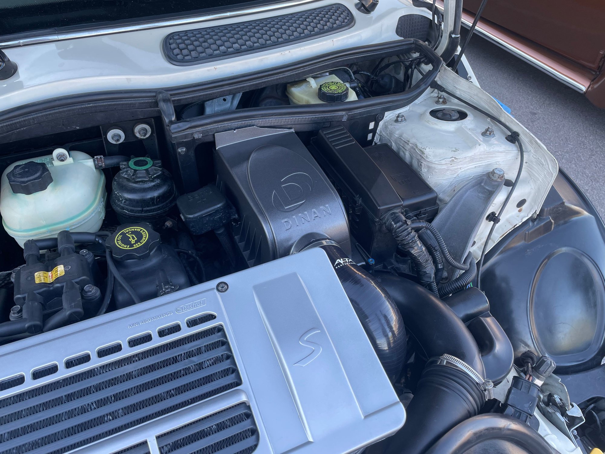

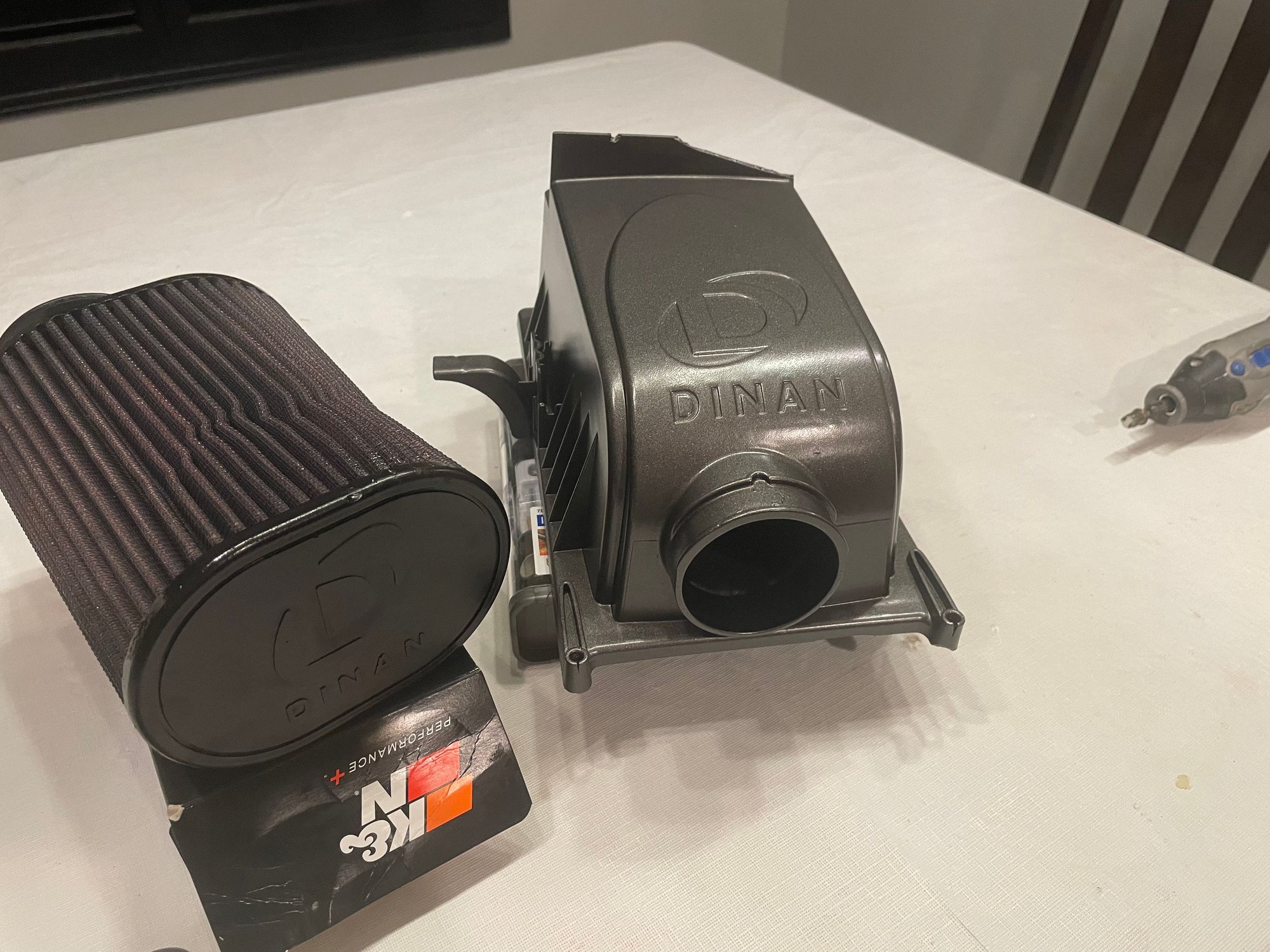

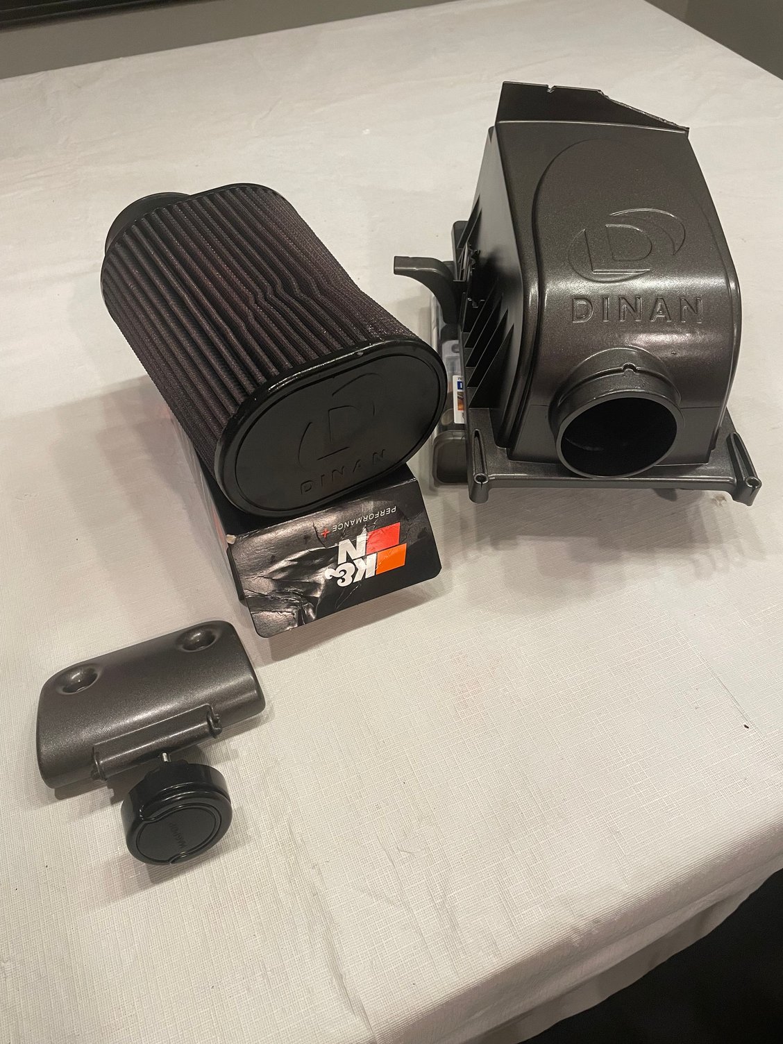

Worked on red mini for a bit. Went to muffler shop to see if they could change out the 02 on PW for me, they wanted $90 to chang3 an o2. Keep in mind I’m supplying the 02, amd was only interested since my garage amd all jacks are occupado with the red minis.
said no thanks, amd went to junkyard where they used to have about 8-10 r53s last year to see if I could find a broken cup holder to make another phone mount.
they only had 2 minis left, but one had anthracite which matches my cars interior, so I unscrewed the mount, and the mounting holes crumbled to dust. Worthless.
Grabbed the silver one from the other car, and saw a complete airbox sitting in the floor of the car.
flipped it over: Dinan.
Looked inside opening and it still had the Dinan filter element too. Took the lid off it with the dirty filter and took my two items to the front, leaving the base there. So I got both the Dinan box, Dinan filter and cup holder base for my phone mount for $50. Dropped by Lowes and got some paint to see if I can at least get a semi close approximation to anthracite, and then came hom3 and started pulling the Alta airbox and filter off the PW, and the rear cubby wall from the parts car since the Alta install didn’t have one.
cleaned everything, massively cleaned the filter, and once it seemed clean I dunked it back and forth in a full 5 gallon bucket to make sure I really did get all the dust out of it before giving it a recharge with a K&N recharge kit.
I painted the Dinan Lid too for that bit of subtle bling, plus it hid the micro scratches pretty well. Looked good under the hood, but no more supercharger whine in cabin. Will take some getting used to.

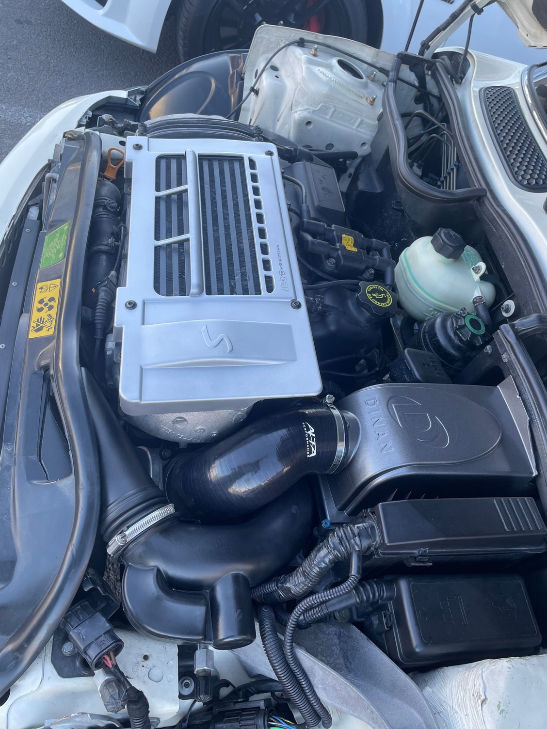

Of course, with stock exhaust and Alta box, thing sounded like an oversized electric RC car… no exhaust note just whine, so it totally changed the character of the car.
In 6 hours I have to be up for Donut Garage’s monthly Rides n Coffee, will be able to better determine the color match then, as well as take an underhood picture. So far though I think it looks good.
I bet I do NOT have 25 young people pointing the DINAN out to their friends like I did last month with the Alta though, lol!

Just found the directions and realized Dinan wanted me to chop up the back wall.
https://www.northamericanmotoring.co...ml#post2373316
Dunno why, it clears it fine. I’m guessing to make it easier to install the lid by tilting it into place, cause it was a bear to get on.
But I might add a couple 1.5” holes to top edge of recess above where the filter box is open, and dremel between them to make an oval slot to get some supercharger noise back.

I, too, had been concerned with cutting a hole in the back "wall" where the airbox sits so I sourced an extra at the junkyard. I tried a modded stock airbox that asked for a larger hole and it worked ok - better s/c noise too. Recently switched to the M7 as it removes the whole wall and the filter is like a foot long (it's huge). And the top is covered--I just couldn't run something open to the heat of the engine bay. Noise is good, but not crazy. For me, the loud whine is part of the fun!
Old Aug 20, 2023 | 07:31 AM
  #54
jcolletteiii's Avatar
jcolletteiii
Joined: Sep 2003
Posts: 1,352
Likes: 486
From: ND, USA
It's so that the added high pressure source of cool air available from the cowl vent can be utilized. Many of the CAI's for the MINI and the DIY CAI that puts a K&N filter inside of a stock airbox utilize a hole saw and a big hole in the back of the airbox through that plastic divider panel. It really lets the air filter element breathe and liberates the wonderful noise of the supercharger!
what’s funny is I did a big 2.5” hole in the back wall of divider above the factory one, didn’t make a lick of difference, because the Dinan has its opening facing up. So I will have to pull the box and divider out and open up the top edge of the divider recess that is right above it.
Think I’ll do just a couple of holes with one of my hole saws, then join the two holes with a dremel cut off wheel to make a big oval slot opening to let the sound out of the factory Dinan top lid opening.
I don’t see any reason to chop a huge section of the wall out like they want you to especially since the raised box edge doesn’t even line up with the OEM divider like I thought it might.
Old Aug 20, 2023 | 01:16 PM
  #57
Onizukachan's Avatar
Onizukachan
Joined: Oct 2017
Posts: 571
Likes: 369
From: El Paso TX
Addendum, was room for 3 “speed holes” side by side, so that is what I did cause it was easier.
Got about 50% of supercharger whine back compared to Alta “box” +no wall. + Alta foam filter .
It’s about the same as the JCW airbox + Alta filter From what I remember, maybe a little more muted.
pretty sure the real difference now is the Dinan filter is closed ended, vs the Alta which is open ended and thus a direct path to intake tract noise, cause with that SOB you could hear everything!
if I ever decide it isn’t enough, I”ll mod the Dinan with a couple speedholes on back wall of it too.
But ~50% of Alta whine in the cabin is a nice compromise and Works for me!

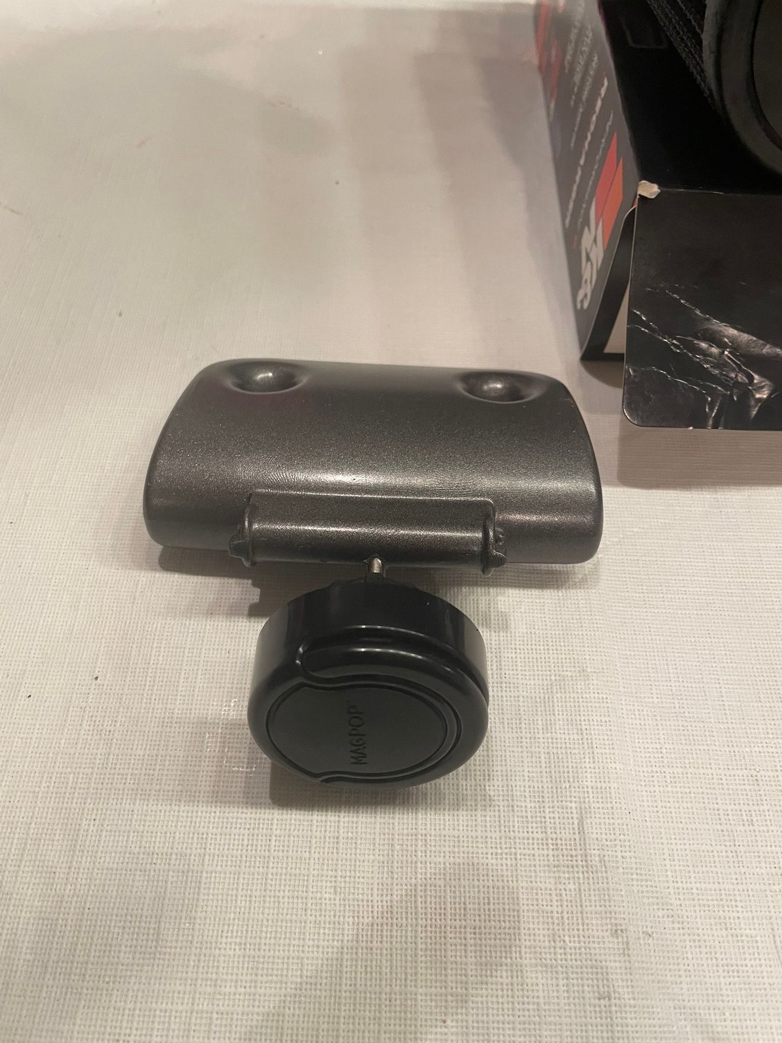

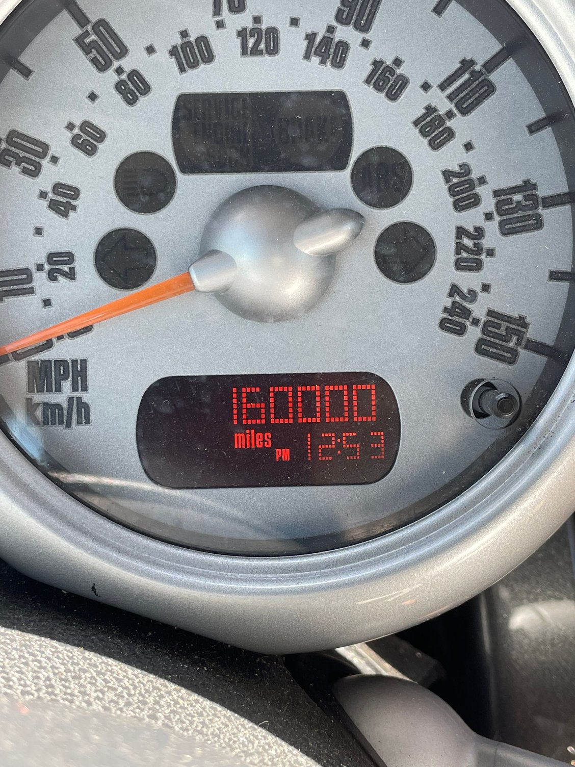

Went back to same junkyard looking for some more parts, thought I’d check the Dinan car for a Dinan TB for @MiniManAdam , but was stock, TB, probably because was autotragic. Did find the needed glovebox ac hose in it though. . Was looking for anthracite rear cupholder ring as well since mine is missing. The R50 with anthracite actually had armrest. Mine doesn’t. No go there,
so Alex & I pulled the entire rear console and armrest out, to swap into mine. $60 out the door.
while there noticed the Dinan r53 had had m7 bar, because the mounts were on the towers, and found the bar itself stashed under the back seat.
The young lady, Demi, who was coming over to buy my Alta diverter today had mentioned she had the m7 airbox.
once she arrived we got the Alta installed on her 06 chili, and I took her to that same junkyard to get the M7 bar for her since I had right sized tools to pull it.
also found the torx bolt once we got there to attach bar back to the mounts squirreled away in the car. Owner charged $50 for a complete m7 bar!
brought her back to my place, got the STDs off, and new one mounted.
hmm, that actually sounds a little dirty. But overall a decent day.
oh, amd this happened pulling into the driveway

Nice scores! The yards near me really have a dearth of Mini's. I have to be checking every day if I want to find anything and that's not feasible. It's always nice to find some great deals. If you find an intact shifter boot trim ring *(the inner part the boot affixes to- not the exterior ring) - I would be a buyer. I swapped the worn boot on Red Thunder II and that stupid ring decided to crack up. I really wish someone would 3d print that piece.
Anyway, congrats on the 160k!!

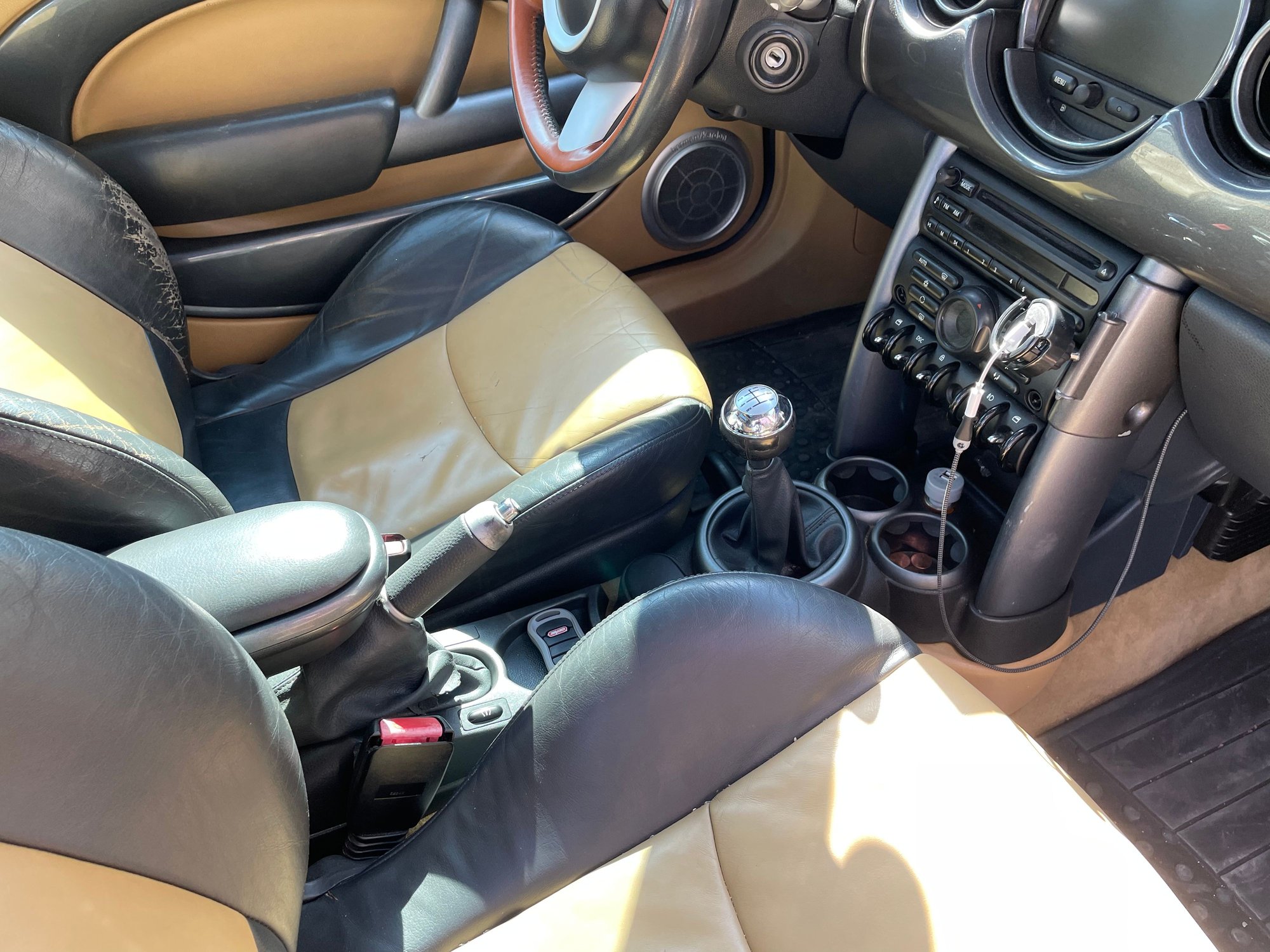

Ditto for the dearth. One of the two minis left in this yard is the one I pulled facelift tails off of A YEAR ago for Alex’s JCW. The other 6 are long gone.
here is what I have learned in this retrofit.
You can swap a later facelift rear armrest console into a super early FL or PFL (with rear console), if you have the complete thing, armrest, plastic “cover”, and base.
However later FL have a slightly smaller/shorter abs module which mounts under the base, under a “domed section” vs being mounted above it as with the flatter PFL… this causes interference with the bases enclosing top and you can’t get it down all the way To the floor.
Solution: chop/cut the square ‘lid’ or squarish domed roof off just that section of the base with a rotary tool, cutoff wheel, or similar. (It was dark AF so no pics, sorry)
By doing so the base has room for module to sit higher, and it only sits about as much higher as the domed roof height plus actual roof thickness was… ergo no interference with the base nor cover.
now you can just bolt it down using the 4 PFL hold down locations, attach the armrest with its 3 screws to the base, Slide the cover into place snap down, etc etc as normal.

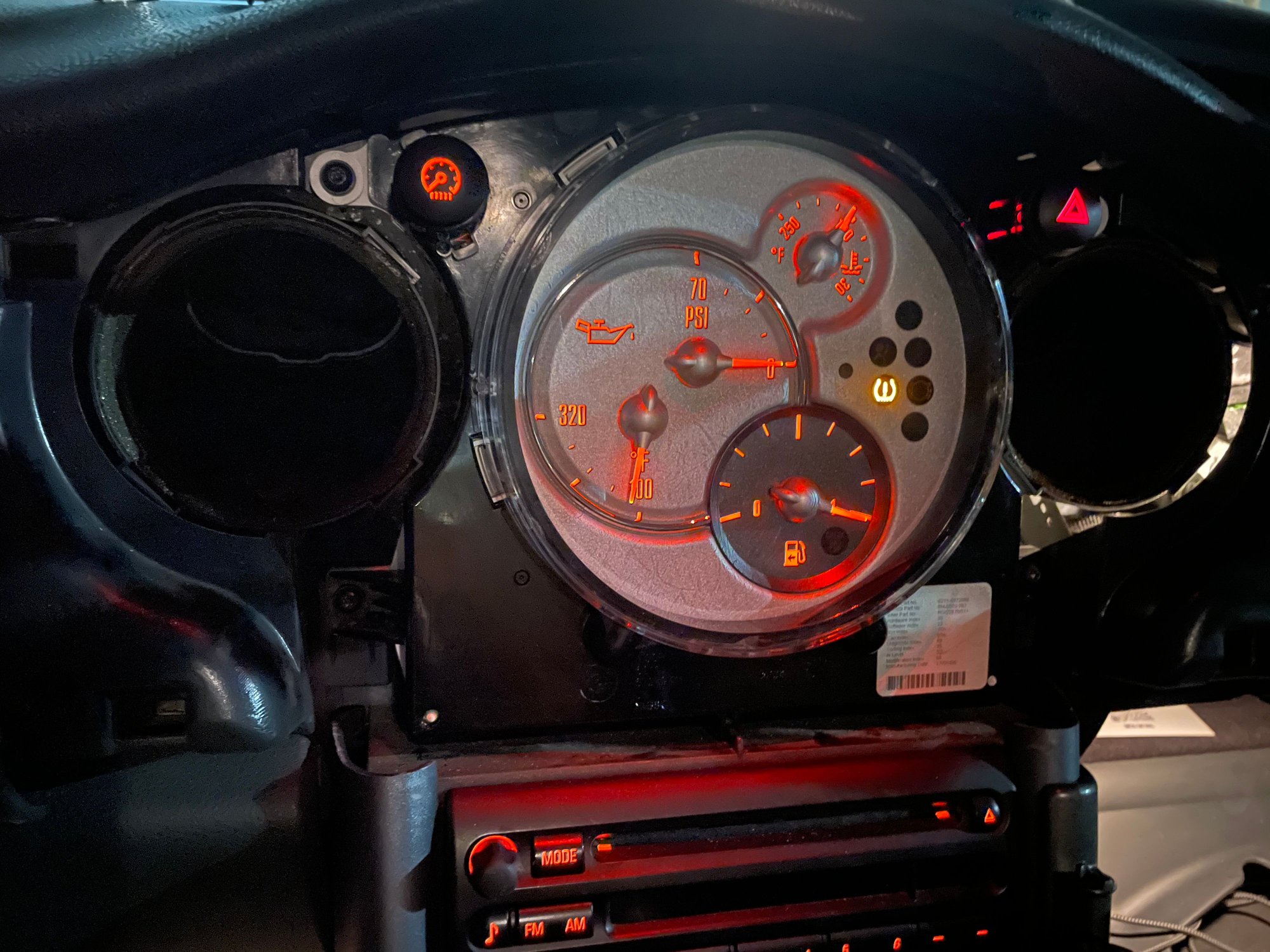

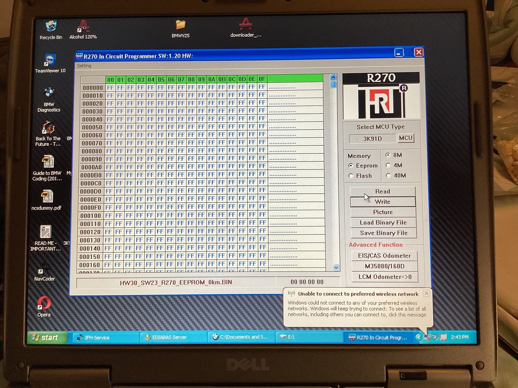

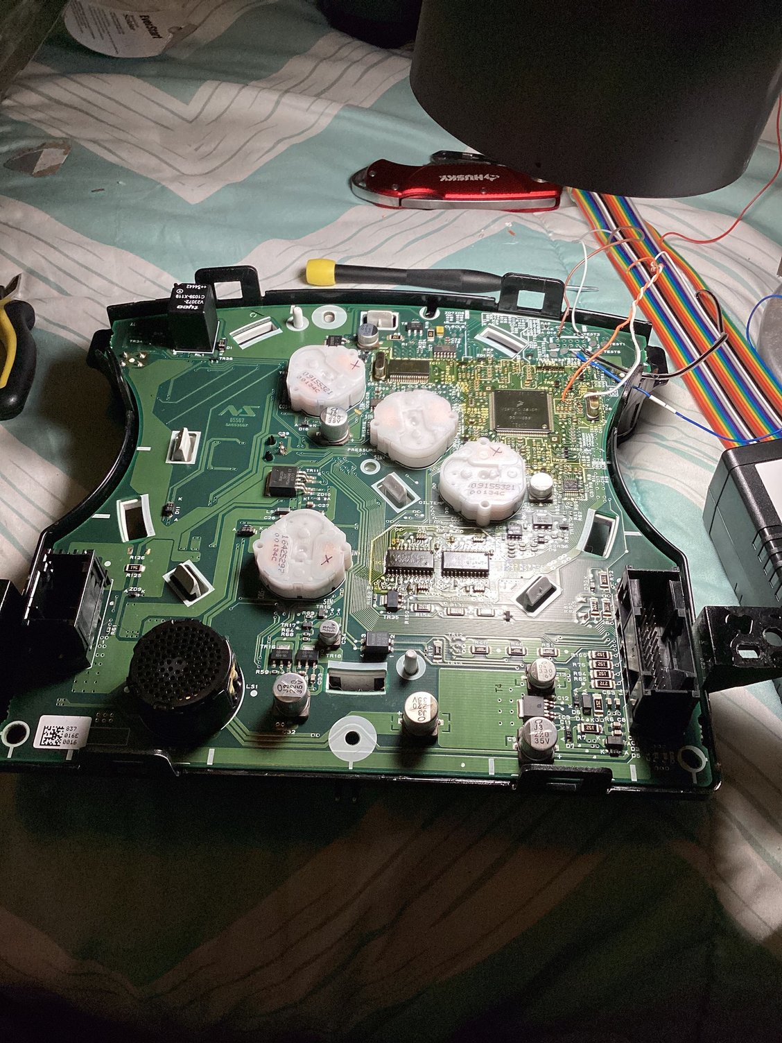

Tested Chrono yesterday for functionality, amd it worked.
just re- virginized it.
Later today or tomorrow after work I can try installing it again and loading my vin onto it so I have correct mileage.

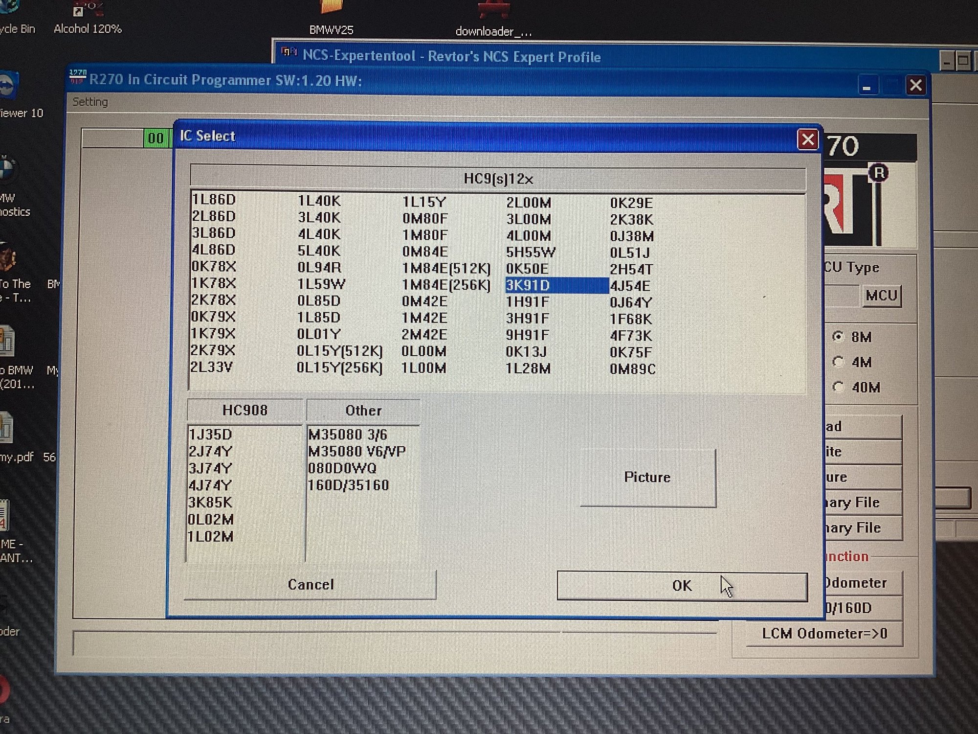

I puzzled it out just following directions on git hub.
I do like the chrome rings on Alex’s, so I’m keeping those on the new regular Speedo /chrono mounting plate, but also putting the anthracite vent rings from the nav plate safely away incase I ever want to get an anthracite center ring and switch them out.
Old Aug 29, 2023 | 07:51 PM
  #66
Onizukachan
Joined: Oct 2017
Posts: 571
Likes: 369
From: El Paso TX

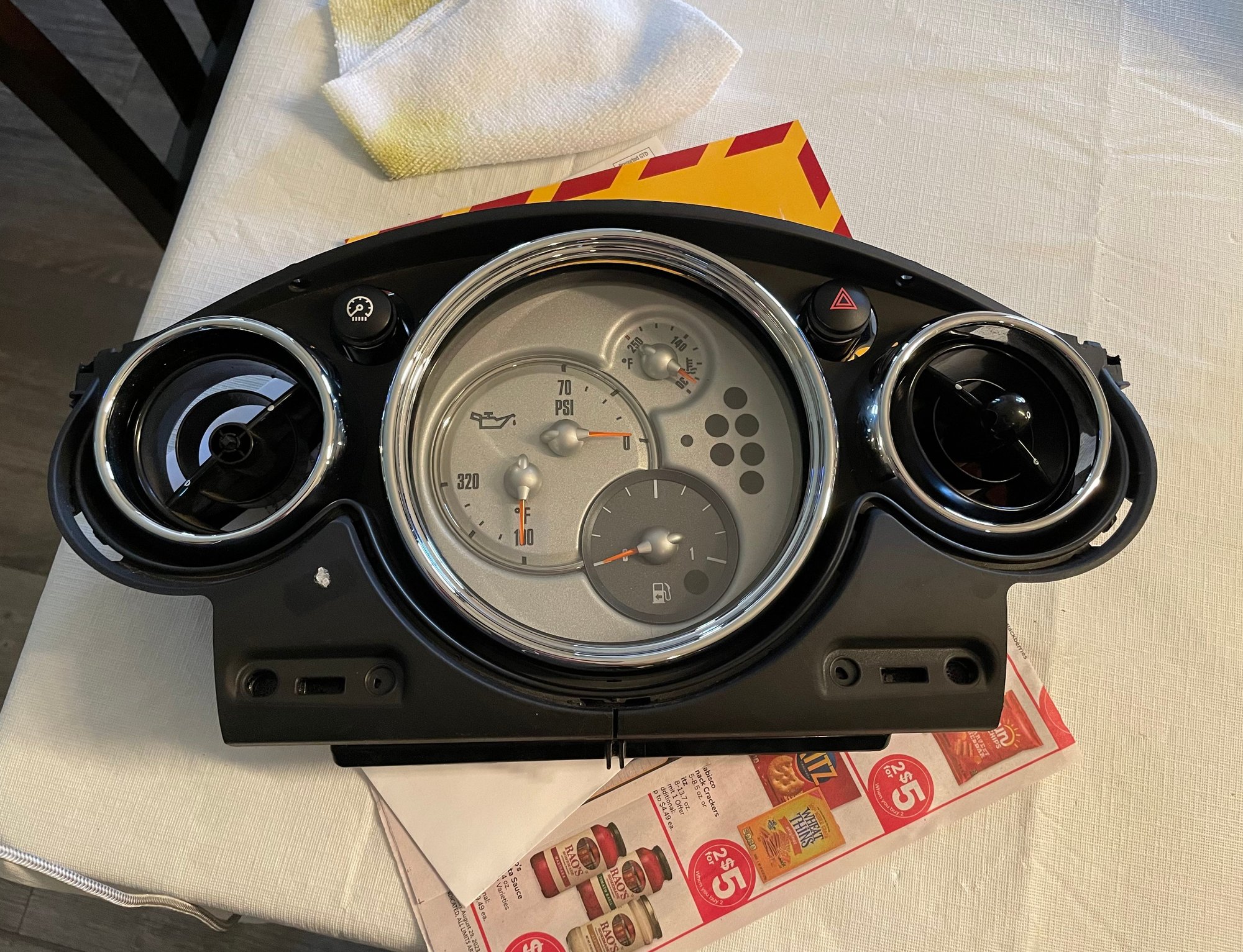

Fully functional.
I used bmw scanner aka PASoft to Move the data over. It’s easier than doing the ncs expert directions on GitHub. Still had to NCS dummies code it for US measurements though.
now to figure out how to move the air vents over from Nav trim panel to the other Speedo/Chrono trim panel and I can finish up.

Complete!
well except that I need to take the seat out and pull the drive out of the floor permanently. But that is not functionally nor cosmetically critical.

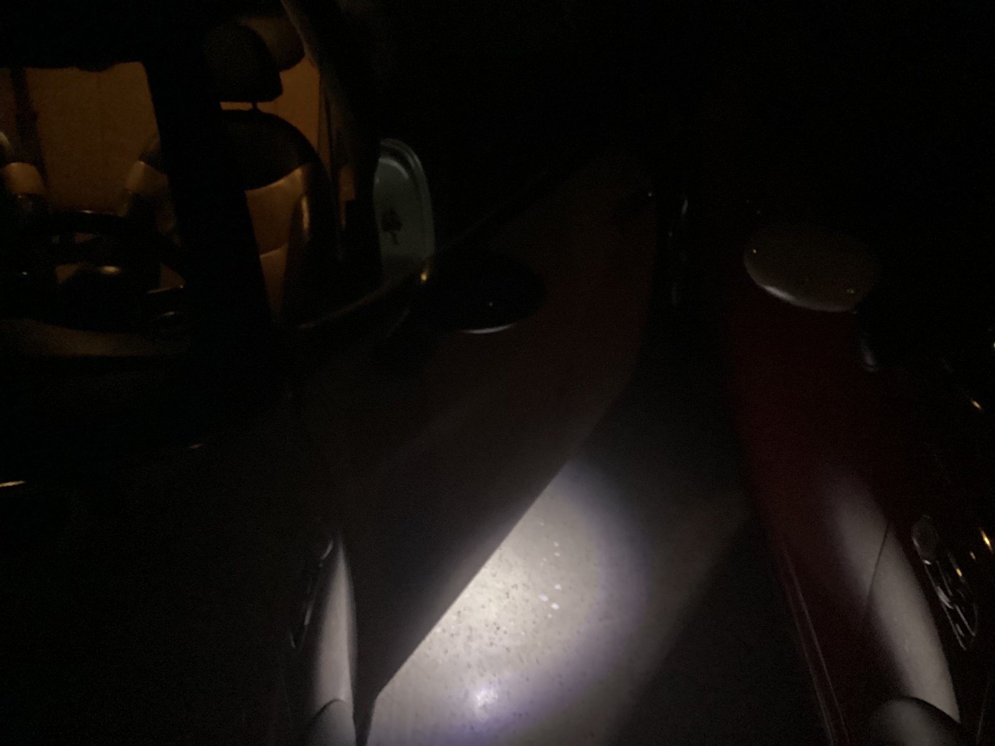

Most of the effort went into Chili, but I finally did another minor mod.
I have a bunch (like 4-6) “Grolish” branded f30/31/32/34 LED door puddle light/logo proj3ctors. The slides that insert between LED and projector lens fade out of left runni* to long/hot, and they are so cheap ($17 for 4) it was always far cheaper to buy new set than fix the old ones.
pull the M logo slide out, and you have PnP led puddle lights to replace the factory incandescent ones.
they are 5k white vs incandescent yellow white, amd about 2x-3x brighter as well.
bd pic but colors amd brightness es are pretty accurate.
compare to the interior light brightness to the puddle light.
can actually see puddles, gum etc with these.
Hope this helps someone!
