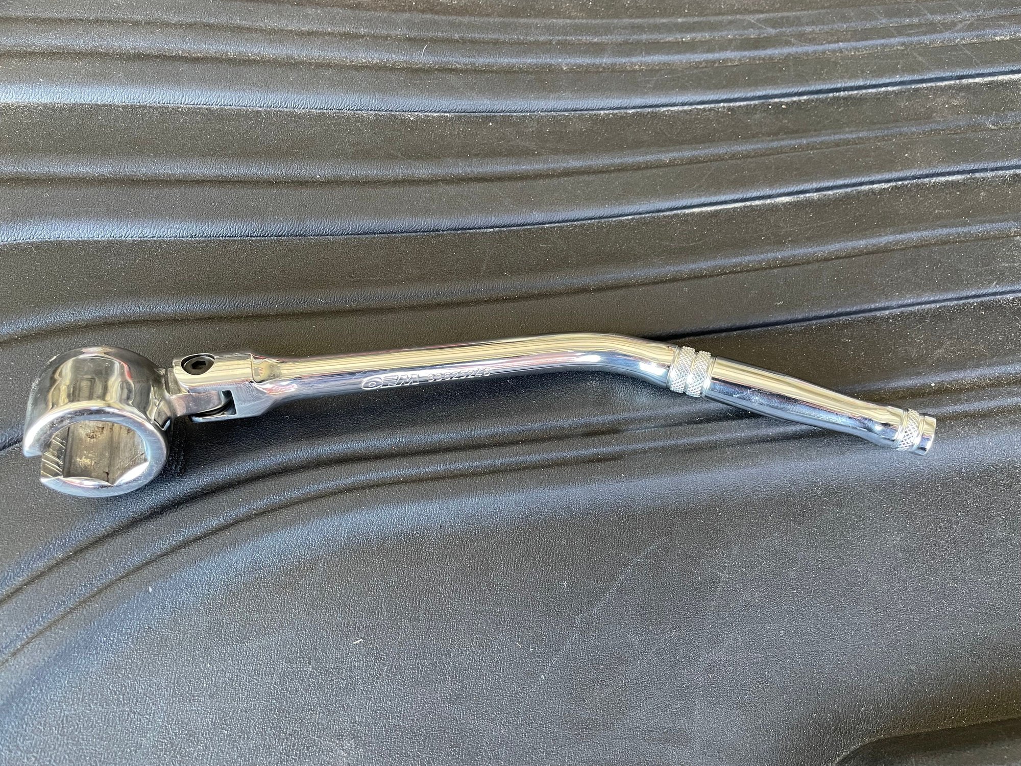

It’s been a long time and Rt66 has been parking in my garage for over a year now. Had to get a new battery yesterday, and
I had gotten a new 02 tool from autozone a while back and it did clear the header so I finally got the front o2 changed to the good used one I salvaged from parts car a couple years ago.
so that finalyl fixes everything that was required to pass inspection and emissions (wheel bearing, suspension, sensors) and have no CEL or warning lights… though the state got rid of inspections in the meantime.ah well.
now what is left to do is the SMF Valeo install to have it be driveable again

This was th3 o2 tool I finaly found that would fit.
