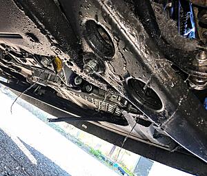

The belt had shredded itself completely and in its destructive process took out both oil cooler hoses so coolant had spewed out everywhere. The ATI damper was slightly scored but otherwise undamaged appearing.
About to go out and re-inspect plus clean up the mess.
Was driving on a work-related trip for a job in Lower Alabama, was driving on 65 highway which I'm thankful for because such a breakdown on some isolated back road would have been more added hassle --- I deffo favor the alternate route twisty backroads but tend to drive them on return home trips due to lack of time constraint.
Did not hear any cataclysmic armageddon happening which is surprising when I saw the massive damage. The radio was not on but windows were slightly cracked. Noticed the battery light come on and pulled off at the first next exit which was Verbena.

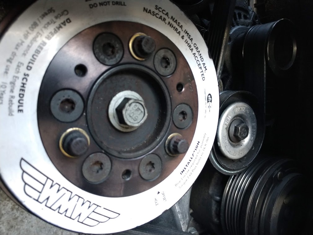

I do not think that there was a problem with that belt, it seems like a tensioner failure and I'll be able to more critically inspect it when I get it off and put the new one on.

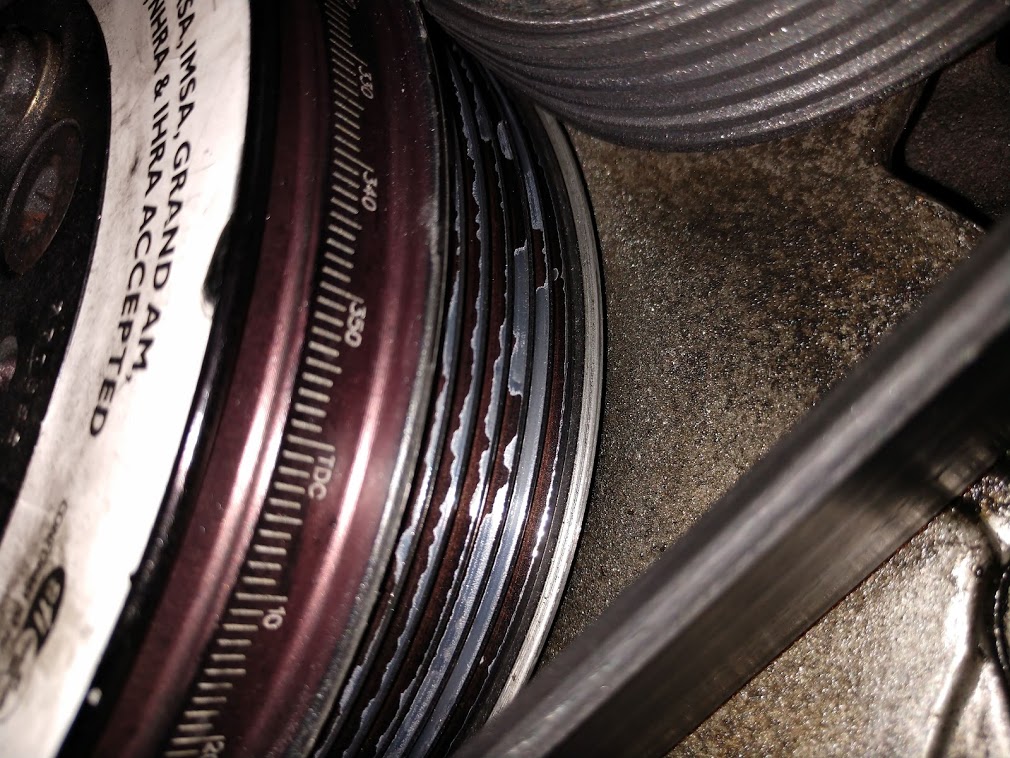

I feel quite fortunate that the crank pulley survived, even though there is some surface scoring it wasn't as brutally assaulted like this one:

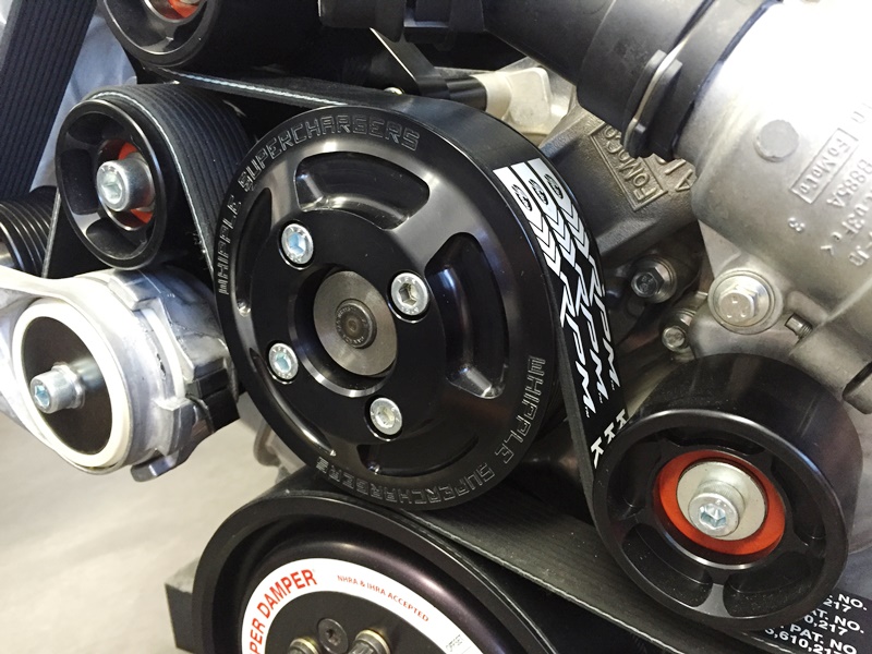

Extreme examples of belt wrap:
Also,
Grip-Tec treatment really appeals to me, they offer a service for adding texture to the s/c pulley.
https://www.z-industries.com/griptec-micro/
It is said on various forums I read that the treatment does decrease belt lifespan for obvious reasons, but the added aspect of better grip traded out for that is a win in my book.
I haven't investigated any further yet but may try it out in the future.
