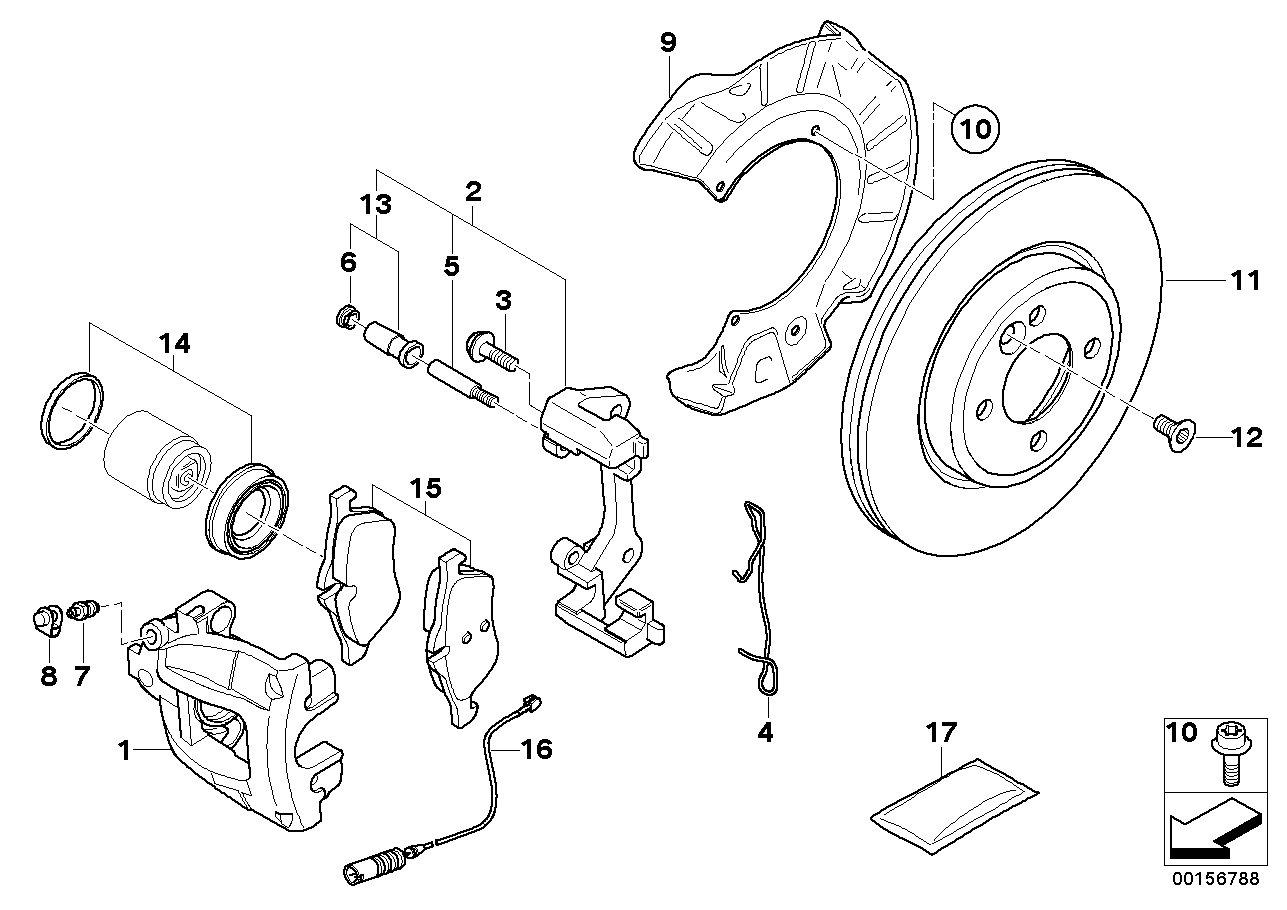

in this pic,
the yellow arrow is the pin/slider I was referring to. pull those out and clean them well, regrease. Maybe replace the boots if they're bad.

Originally Posted by Subw00er
in this pic,
Yea, there's a thin layer of deposit on these pins. (maybe it's from the rubber boots?) I'll clean them all. Thanks.

Originally Posted by mathewkhng
Your explanation sounds legit. Thanks!
What I thought was, when I let the pedal up, it generates sort of vacuum in the brake line and pull the piston back in.
I don't have glides on both front and rear callipers. Maybe they don't exist on Stock R53.
For installing the pads, is it okay using hi-temp copper grease for lubrication? or specific brake-pad paste? Thanks
FYI: My 06/R53 has Guide Pins on both Front and Rear. Calipers are stock. Item 6 on your diagram is a guide pin.

For clarification, I am talking the glide not guide. The glide is the C/U shaped item in Post # 4. Both glide and guide should be cleaned during the pad change.
While the OEM is displayed, when the calipers are stock color, I like to paint # 4 red. It gives it a nice contrast.
Thanks for clarification. I’m wondering, it seems that it’s a must to have the glides for fitting the pads. But I couldn’t find them from parts diagram nor online car parts shop.
Haha I never think about painting the little clip. Sounds interesting. If I need a new set of calipers I would powdercoat to pepper white as the body paint colour.
Do you have those C/U shape clip glides in your Stock r53 brake calipers?
