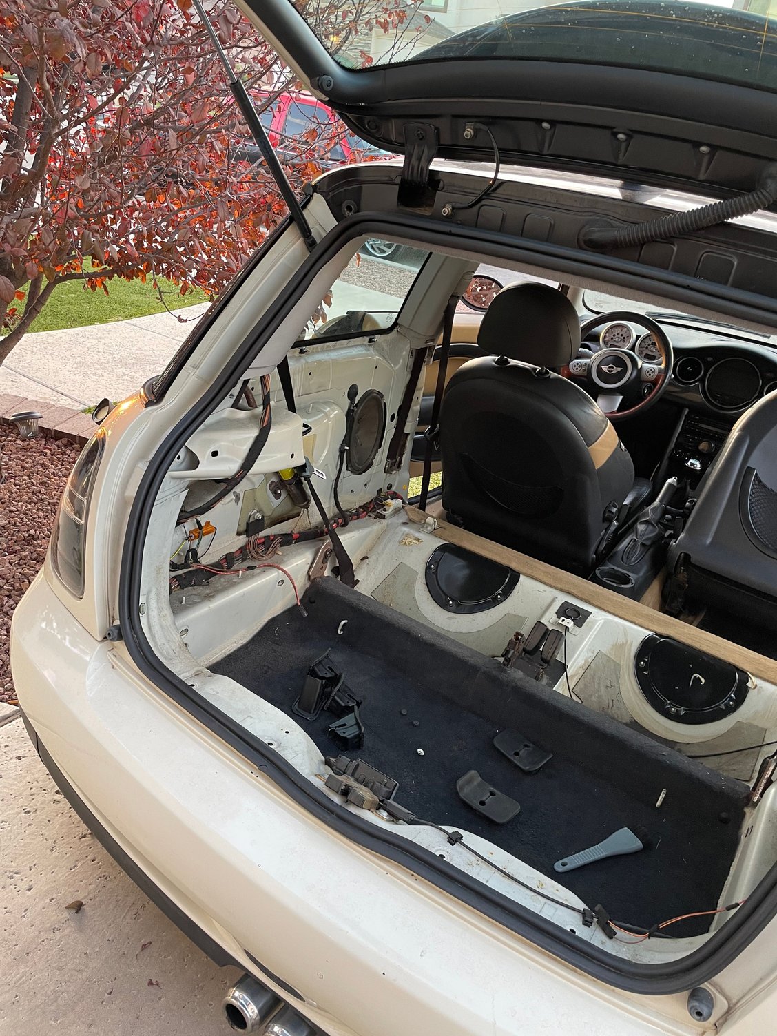

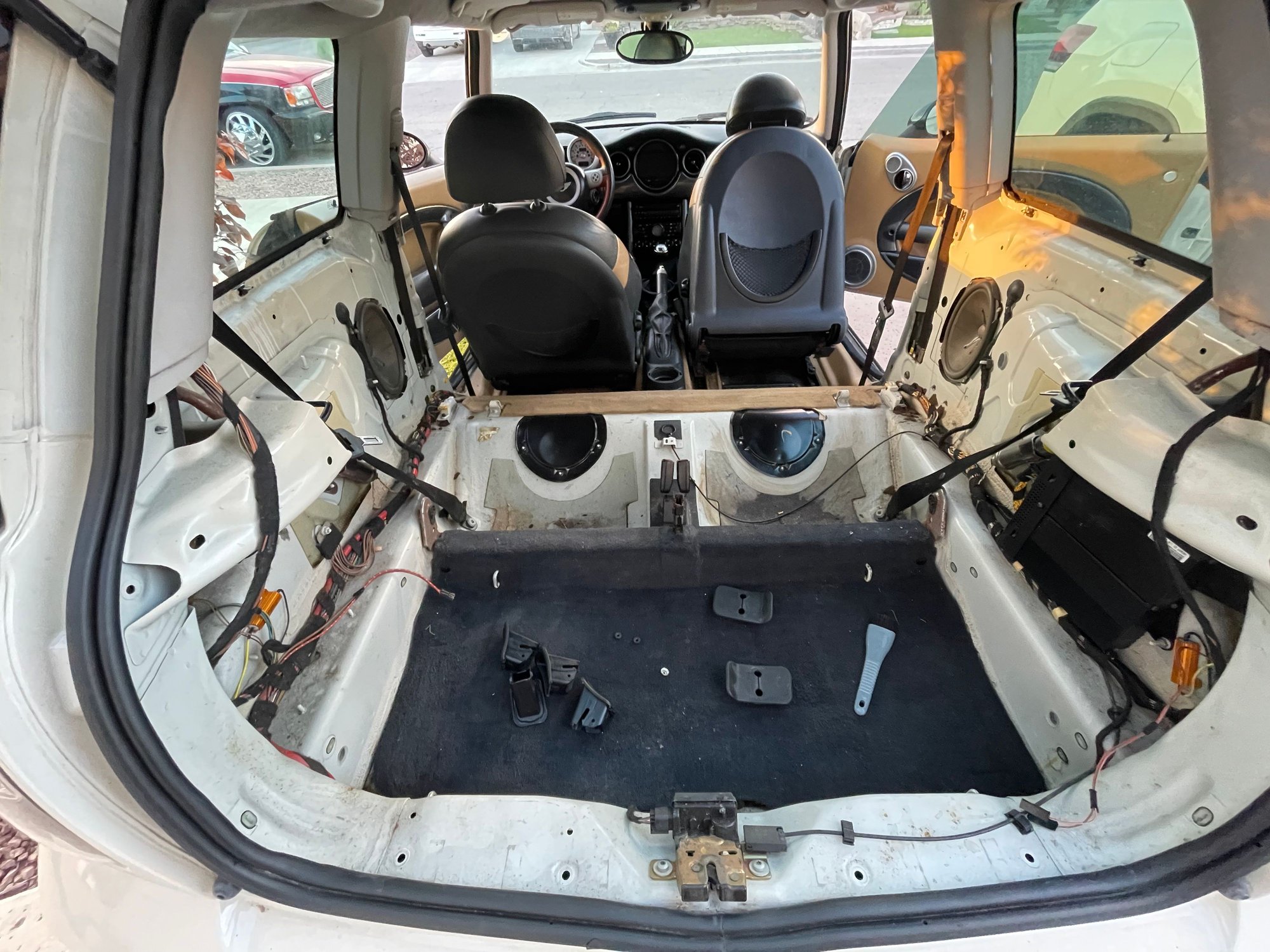

Finally got it back together. Weirdest thing, it was the amp that was bad but only for festival mode. The other modes worked fine once I changed all the speakers to the ones from the parts car. But festival still screeched like a mad banshee.
popped the parts car amp on and all is well.
while rear panels and seats were out, I cleaned underneath and gave them all a really good cleaning.
still need to finally vacuum out and clean the boot under floor and battery tray, but next project will be uninstalling the working iPod adapter from parts car, and getting it installed.
On this one, rather than flip flopping tpms switch with the console blank then installing it in console blank on right side like Alex’s, I think I will put the aux jack in the glovebox along side the iPod adapter.will be the first time I do one “normal”. E46iT has it literally in the eurotray’s pen holder, my wife’s former e83 I extended wiring and put it on rear of center console, Alex’s is in the blank on the center console though I had to solder on a different jack for that to fit there.
I also need to install the yellow Nokya bulbs in the fog lights as well still.
Oh, and I still need to flip flop the sunroof control with the mic blank, I like it better on right side, falls more easily to hand when you reach up from the shift ****.
but got a good bit accomplished today!

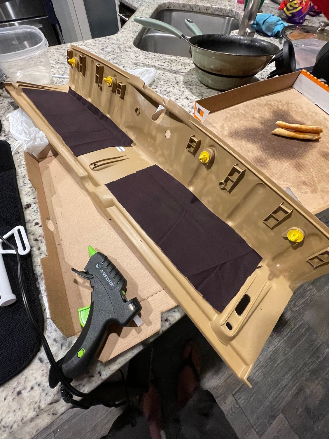

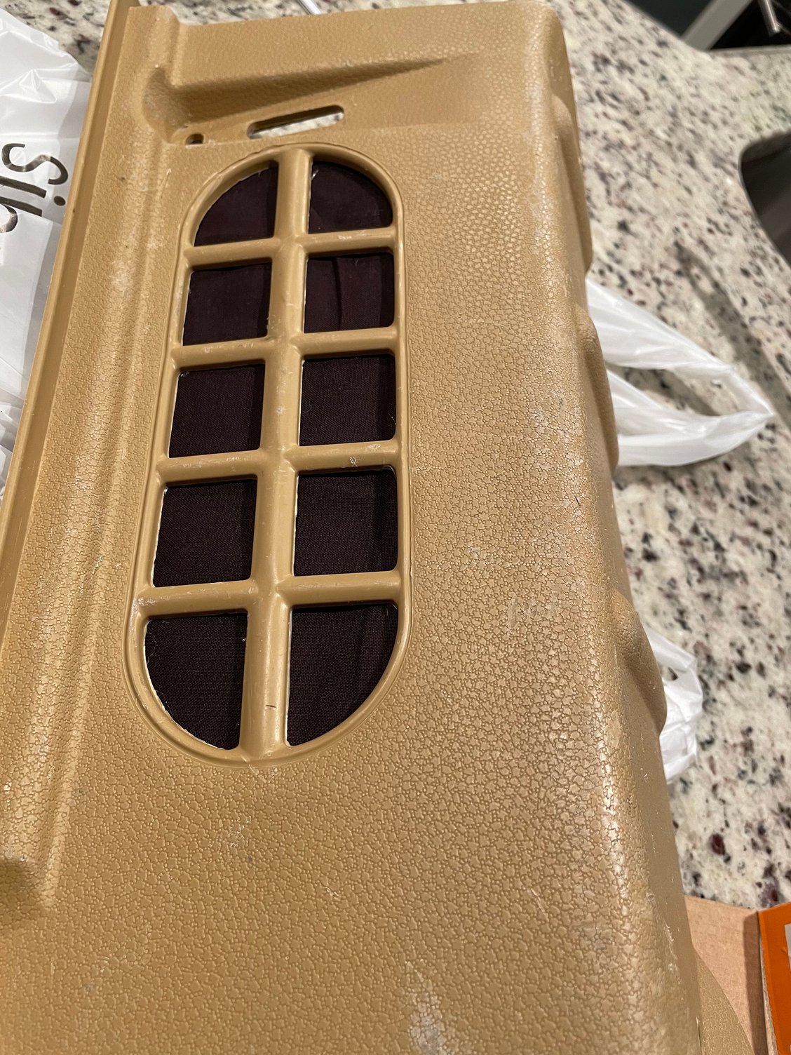

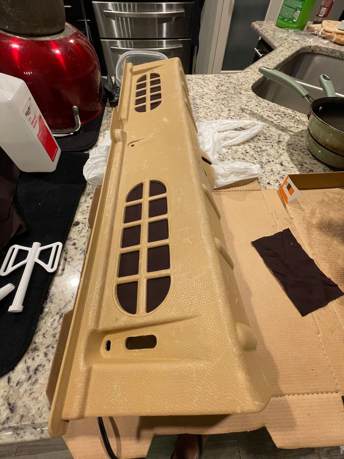

109 today, peeled old bonnet stripes off. Got to see what pepper white looked like 20 years ago. Much more buttermilk than the current vanilla color it has faded to.
also stuffed foam into the holes behind the rear hatch vents, and replaced the fully decomposed foam with a dark brown cloth hot glued on back Sadly not speaker cloth but also not super high quality cloth so it is still semi porous to air.
hopefully this will help with my issue of hot air and some exhaust fumes being sucked thru them when windows or sunroof are open at highway speeds.

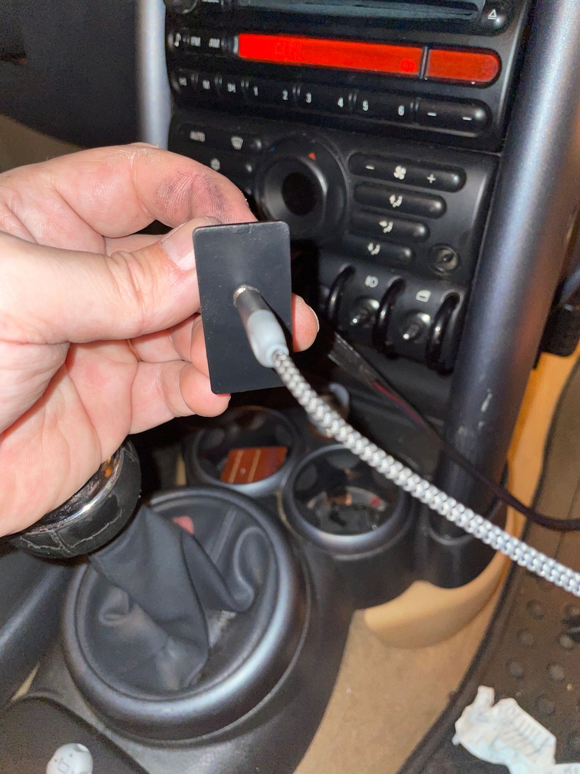

last night once temps were cooler (it’s been105-115 everyday this summer) I finally got around to doing the switcheroo between mic grill and sunroof control. I like it better on right side as it falls more easily to hand.

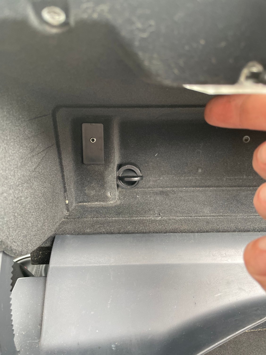

So I pulled everything apart to install iPod adapter… realized when I got to the last step that my sons old harness had a blue 3 pin connector… not black 12. Why? Because his car actually does have the Sirius iPod cable already installed. So I ixnay on that.
finaly figured out why the aux jack was a total POS, the little board with the smd resistors and capacitors, was broken free of the wiring.
Solder all back in, then realized the board itself had cracked traces, probably from being stepped on. So I ripped the board out. Aux is still detected when something is plugged in like iPod, or if you have a lightning to 3.5mm adapter on end of your aux cable. And frankly it sounds a hella lot better. It was low volume super highs, then ok on level 5, now quite good but I had to turn aux level down to 1 from 5.
in keeping with my history of having cool OEM/ discrete aux jack locations and installs, I installed in the glovebox…
i need to find the glovebox AC hose in a junkers still, parts car doesn’t have one either. And figure out a mount for phone in this car.
But at least I have tunes between the HK fix and aux fix now!

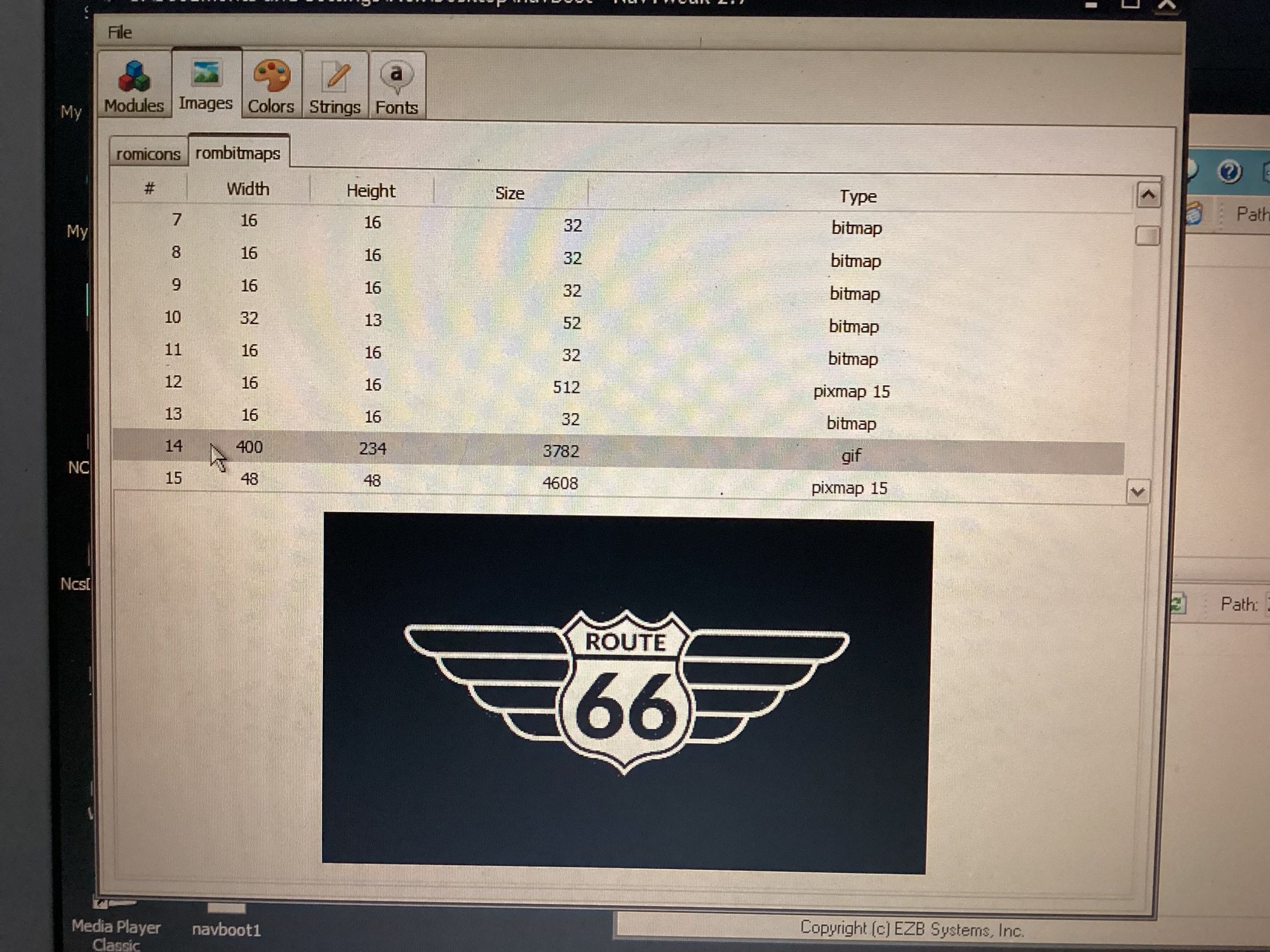

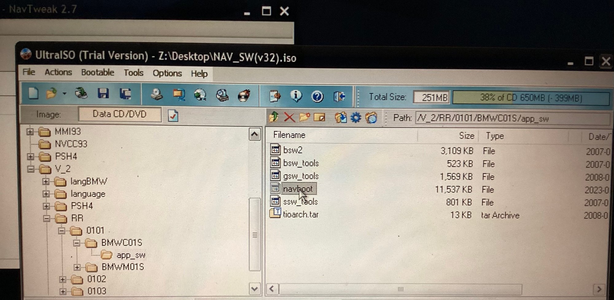

Thinking about doing this as the splash screen on the Nav, at least for now.
cause all I can find for OS update is the bmw v32 I already have from the e46, and not a mini version.
and I don’t want the bmw logo on it. Lol. So if I’m gonna hack it, might as well make it personalized.

I followed the directions and made a custom splash screen and put it 8n the place indicated on bmw how to forums.
minis somehow know they’re in a mini and use a different splash screen in a different profile. I may play with the file and see if I can figure out which profile had the mini boot loader, just for group knowledge, but I also probably won’t bother doing it.
As it turns out, The cd laser works, the dvd laser doesn’t. So I can do OS updates, but can’t use any maps or navigation. pretty much determined I’d rather do Chrono than invest in a new Nav drive.
I could still switch the splash screen, but since it couldn’t get the drive to work it would be all for naught.
I did figure out how to use inpa to change from US Span French female, to GB US Span female, (you do need an OS disc) so no need to make custom/hacked firmware except if you want a different splash screen.
I Just didn’t want bmw splash when I updated to v32 OS to get the temp always onscreen and disclaimer auto timeout etc. As it turns out that was not an issue!
And I still have one of the old good downloads of plain v32, if anyone needs one in the future, since they all disappeared from net. I used it on the e46 years ago when I replaced the drive on it and had to update the “new” one, amd used it as the base of my “custom that actually wasn’t” update.

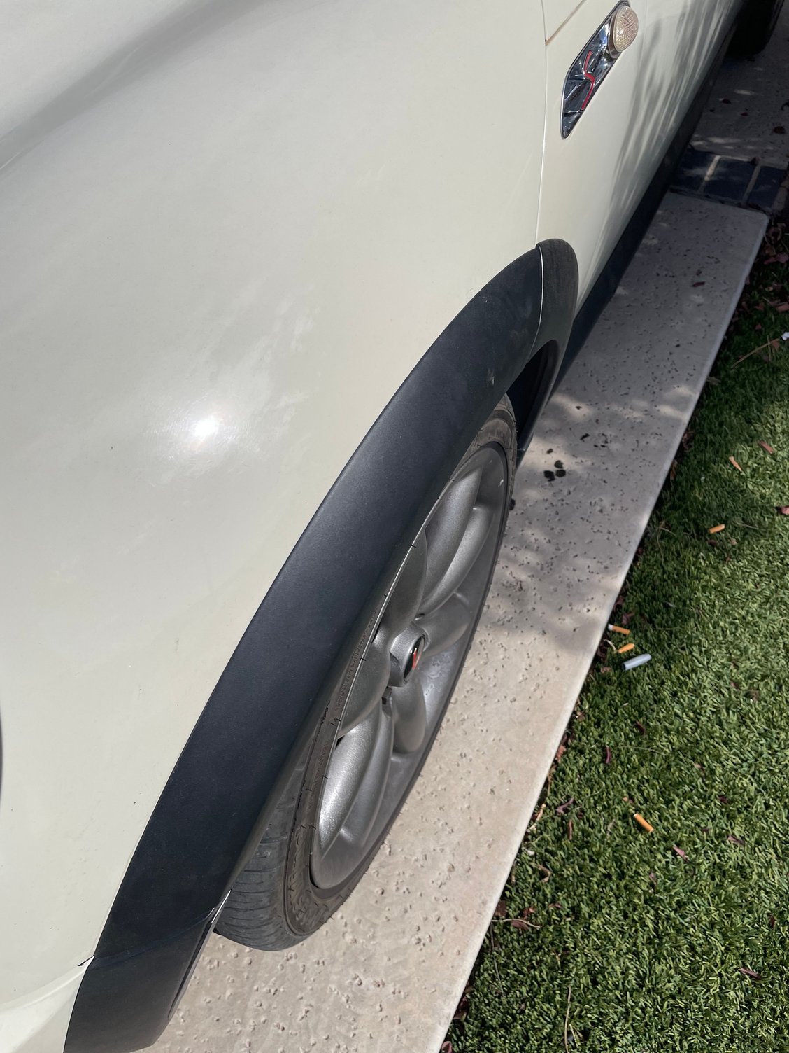

Flood Trim renewal pics
This is after applying the latex based Floetrol with a small chip brush and leaving to dry overnight. Any mess that got on the paint wiped off clean with my finger. As you can guess, the lower aero grill did NOT get treated, but believe me the upper grills were very much the same if not worse looking. These pics were taken after a quick drive in light rain, no signs of dripping or weeping onto the bumper paint were detected. The stuff seems like a solid product, the rag I used to apply it to the wheel-well liners dried up and had a mild stiffness due to the latex, this makes me wonder if the product will begin to eventually peel & flake away or will it slowly disintegrate, revealing the faded color again... time will tell.

Figured out where the mini logo splash screen is, as promised.
same place, same folder, etc, but is option 110 instead of 14.
you will need a windows computer, some sort of ISO program.
Using the ISO program, find the nav boot in the folder, extract to desktop, then use a program called navtweak to see the contents and replace the 400x234 mini gif (located at 110, bmw is at 14) with a custom 400x234 gif of your choice,
sav3 the modified navboot back into your v32, then burn the disc to cd and update as normal
Location of splash screen in the v32 os update.
Location of mini splash in navboot.#110
Location of BMW splash in navboot. Leave this one alone, modify the mini one @#110

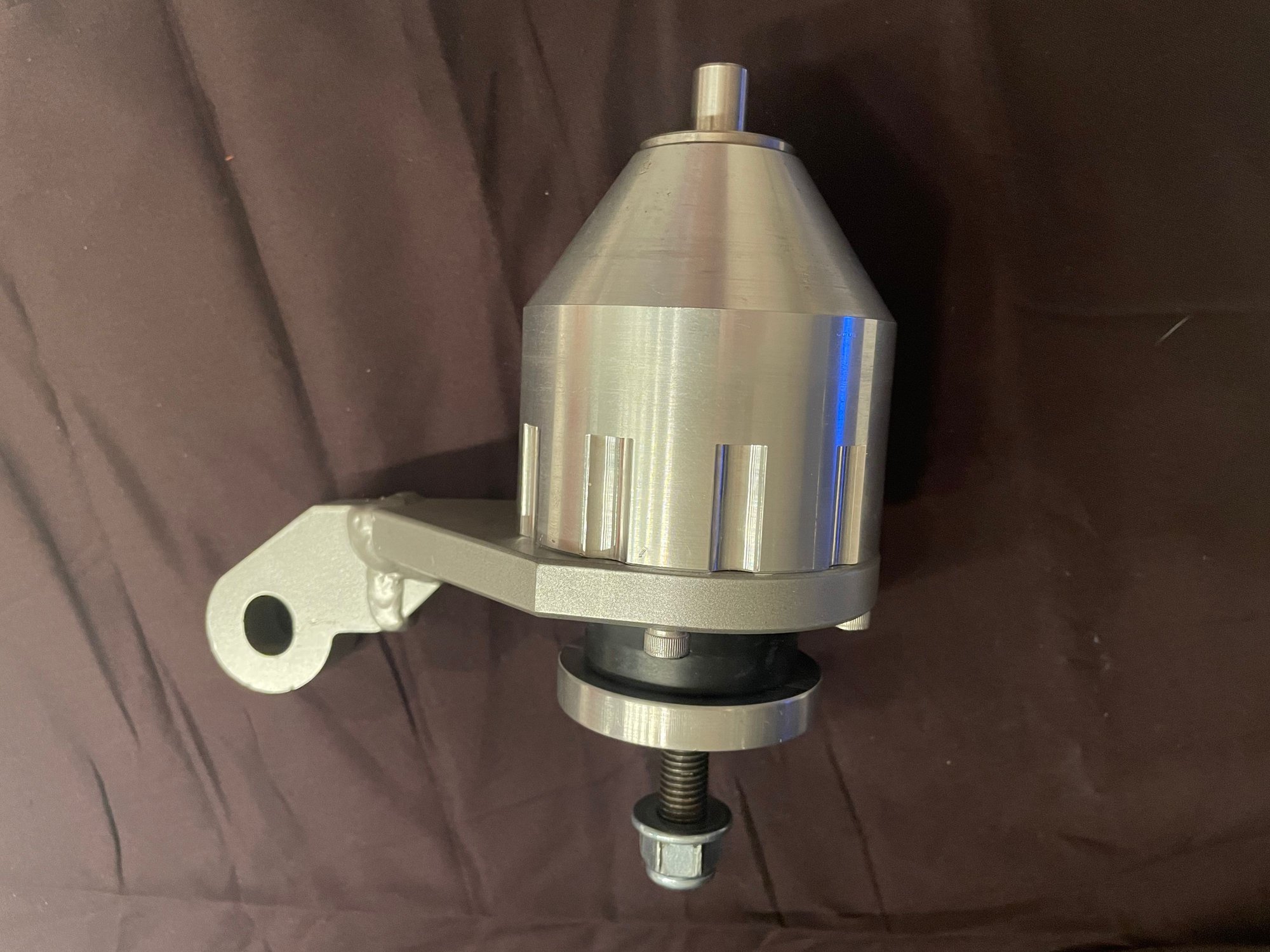

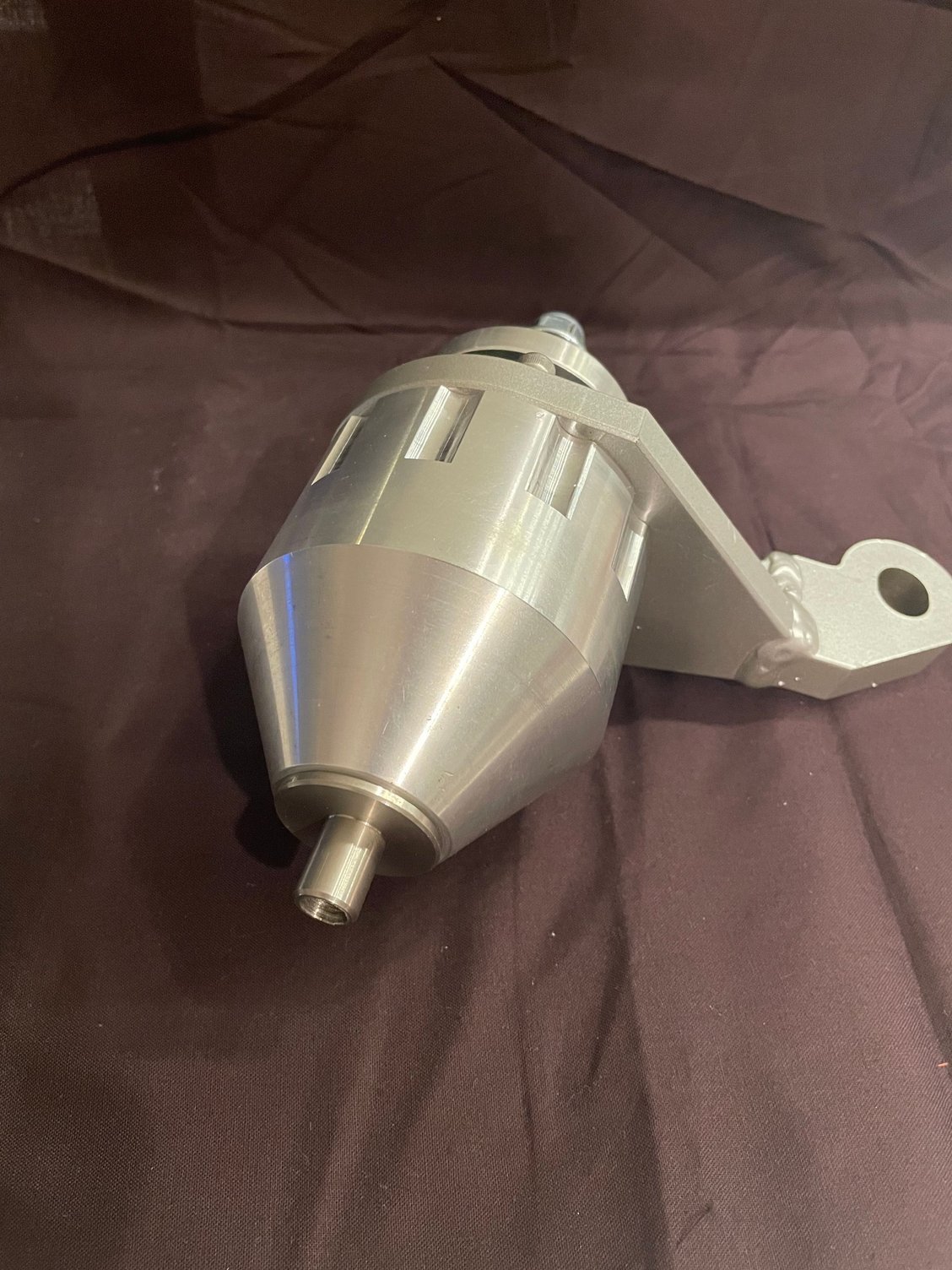

Got this today from @MiniManAdam . Fast shipping and easy transaction. Much appreciated.
this thing is F’ing beefy!
EDIT: it also makes my car feel like you are driving inside a woman’s intimate toy set to high… so it will be coming out to go back to a Corteco FL…, or to back date to PFL style. Probably ok for track only full race car use, but absolutely not worth a damn for street driving.
