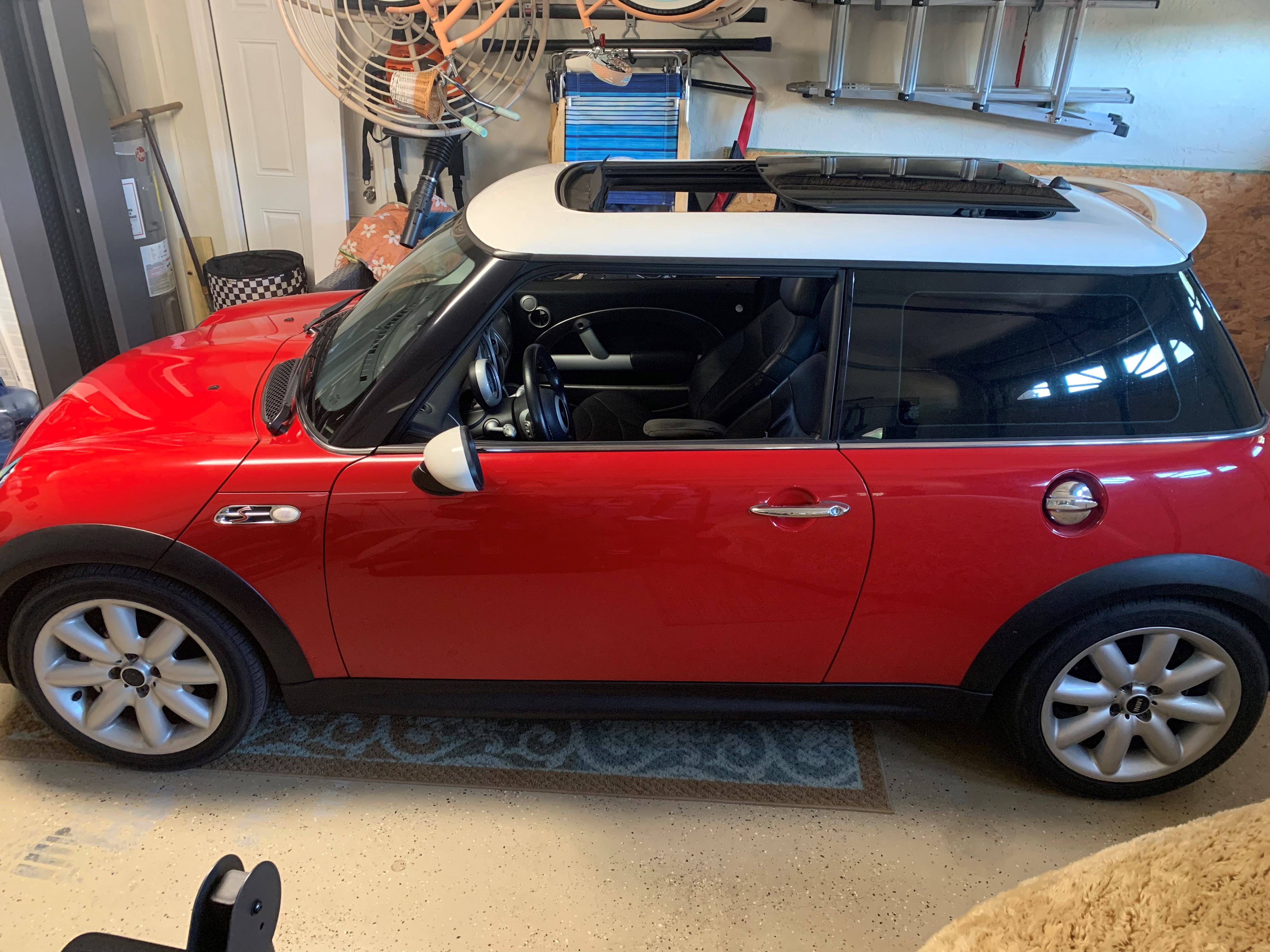

I will be posting my build progress here, as I have already started and accumulating parts to fix it up and modify it as much as I can. Its a 2004 mini cooper S. I got it about 2 years ago knowing it was leaking oil, so I drove it about a year leaking lots of oil, about quart every other week. Oil was coming from the valve cover and crank sensor mostly, maybe front seal also. I purchased all the gaskets for everything except the head (good compression) car has 160k miles on it. It also had a broken belt tensioner on it when I got it and I still drove it like I stole it LOL. Here is a pic a few weeks after I got it home.

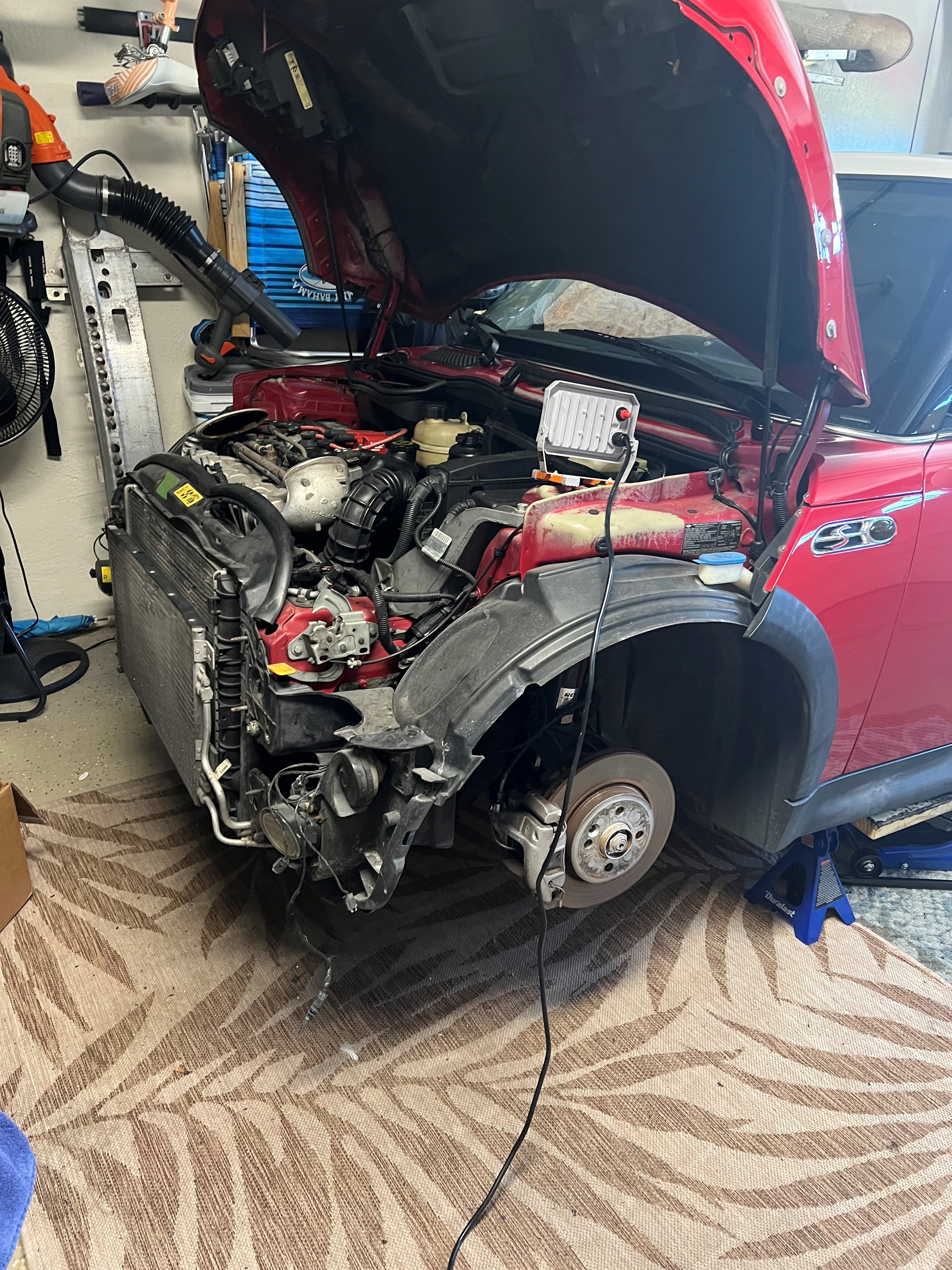

So here is the current status as of last weekend. Pulled engine and trans. It was a mess, at least the oil leak prevented any rusting LMAO. Oil everywhere. I used a flat razor to scrap off most of the oil build up. I pulled the stock pulley off and everything else that need a gasket and or attention. New timing chain and guides/tensioner went on first, oil pan gasket, timing chain cover gaskets, new idler pulley, PRW fluidgel Damper crank pulley, new front crank seal also, there is also a little tiny o ring that goes in the center of the timing chain cover with the bolt as a washer, that I wouldntve known about if I didnt look at the assembly print. Now I had to work on getting the stock SC pully off, I highly recommend using the SC pulley tool! I ended up going with 16% under pulley recommended from Jan at RMW, at first I was going with a 4% over lightweight crank pulley, but after discussion with Jan I opted out, due to stock supercharger RPM. I also replaced the oil filter housing gasket and oil cooler gaskets and all hoses.

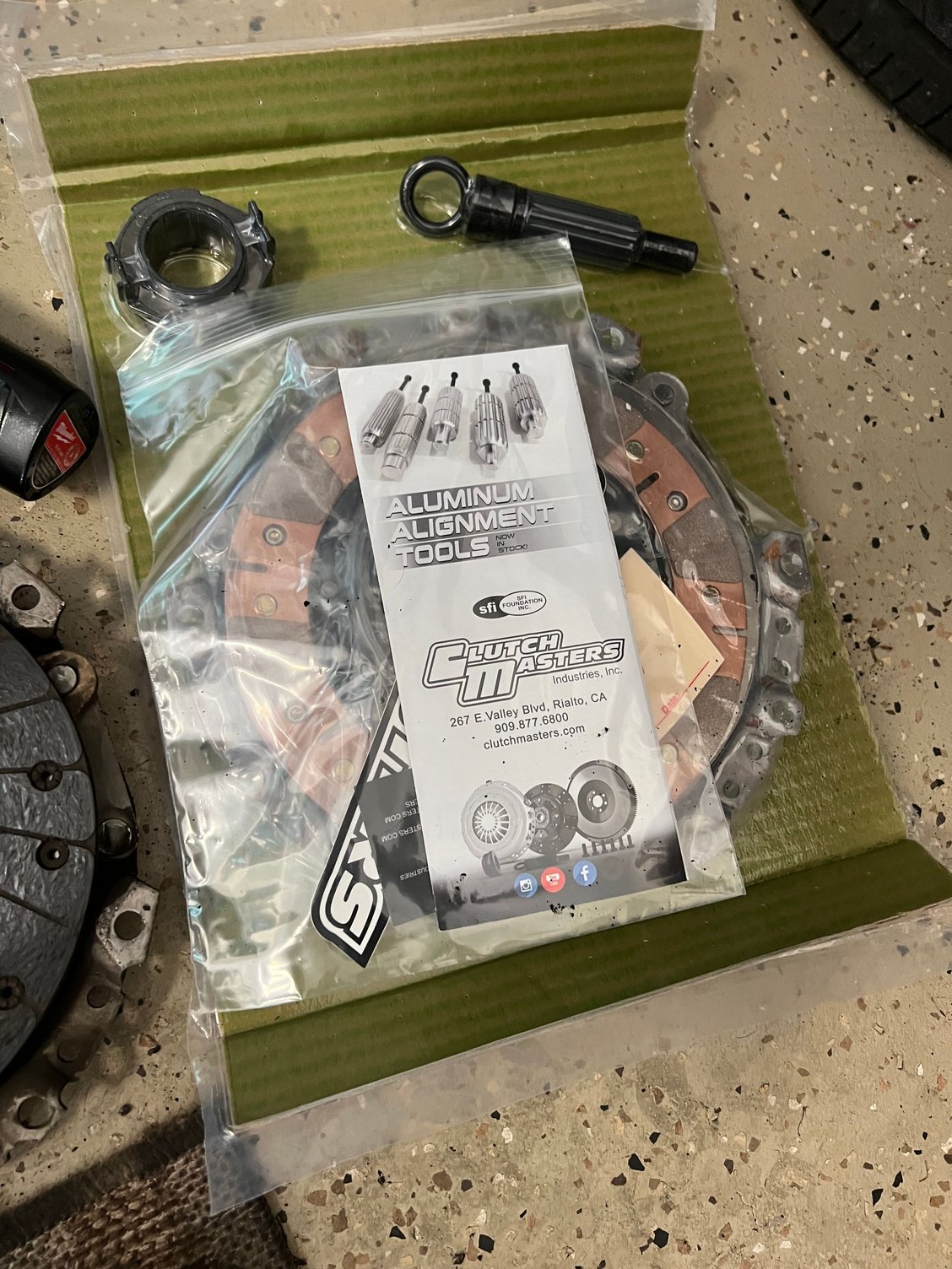

This weekend, involves removing clutch and trans to get ready for new fx400 clutch and new one piece steel flywheel. And quaife LSD on the way. Pics to follow.

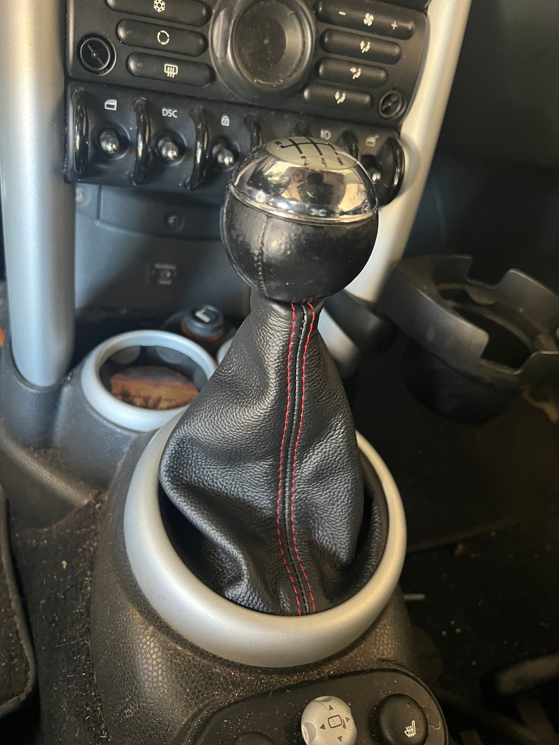

While waiting for parts today I replaced the old worn out shifter boot and e brake boot/handle

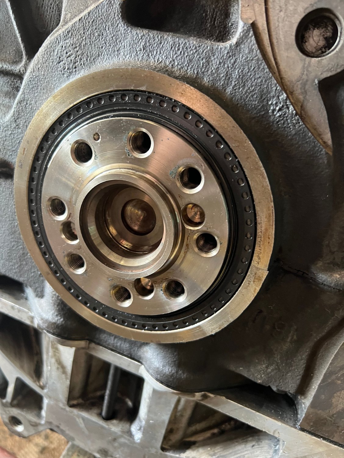

Today, replaced rear main seal, got the new clutch, took the old open diff out, new lsd is arriving today! New flywheel arrives tomorrow I think.

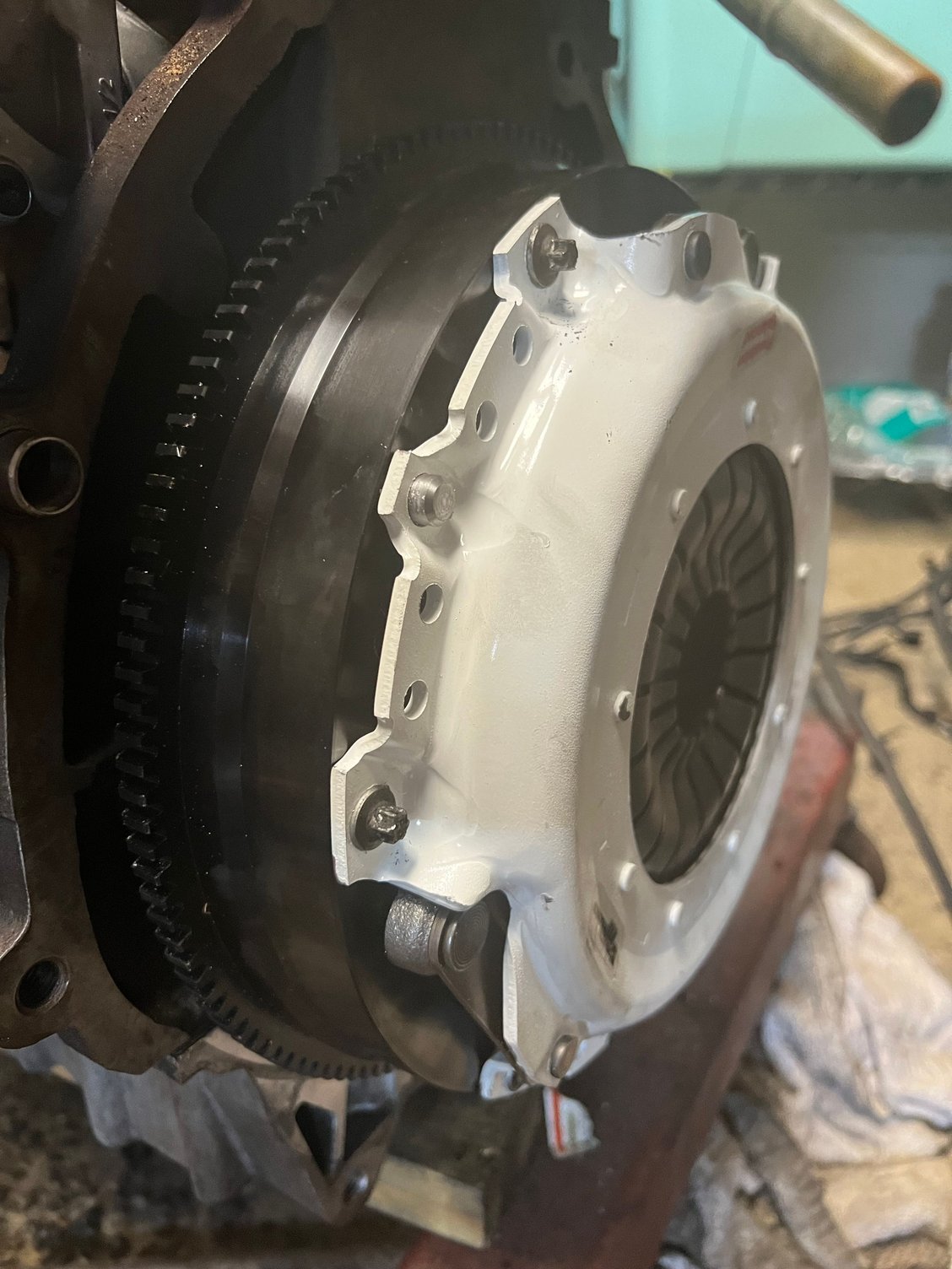

New flywheel and clutch bolted and torqued. New lsd installed and sealed.

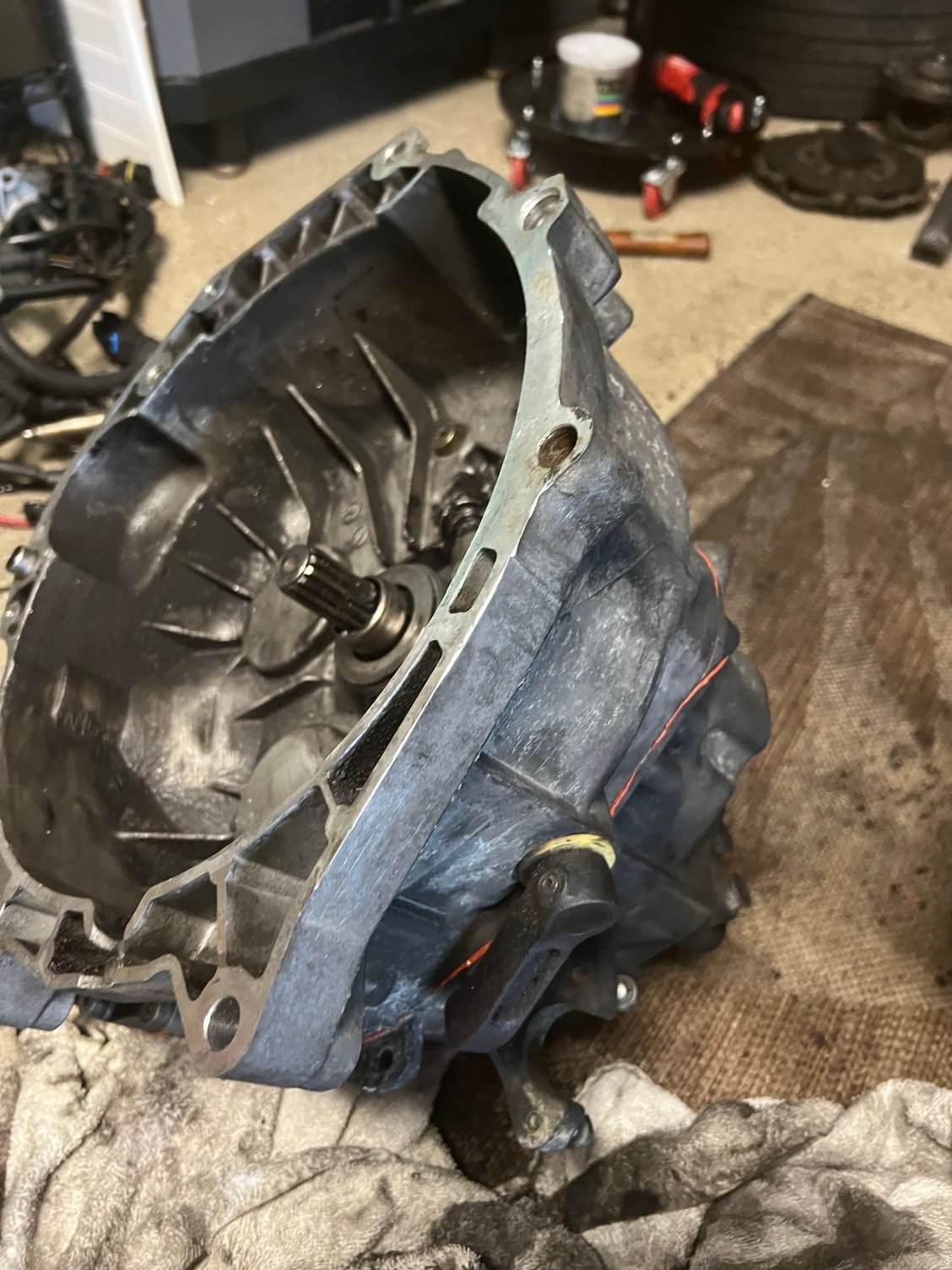

Well my weekend started off with a broken transmission housing as I went to assemble the trans to the engine the back end was cracked in half 🧐. Soo luckily my local salvage yard 1.5 hours drive had spare used one for 350$ I drove out and got it back to start diss assembly of the broken on to get the lsd out to put it in the new used one.
went to remove the broken clutch slave off this used one and both heads of the bolts broke off, ugh. I’ll drill them out later I said.
got everything assembled and back onto the engine!
today I got it back into the car finally! Bolted the new header on, and fished some coolant lines together, now I just need to take my time hooking the rest of this ****.

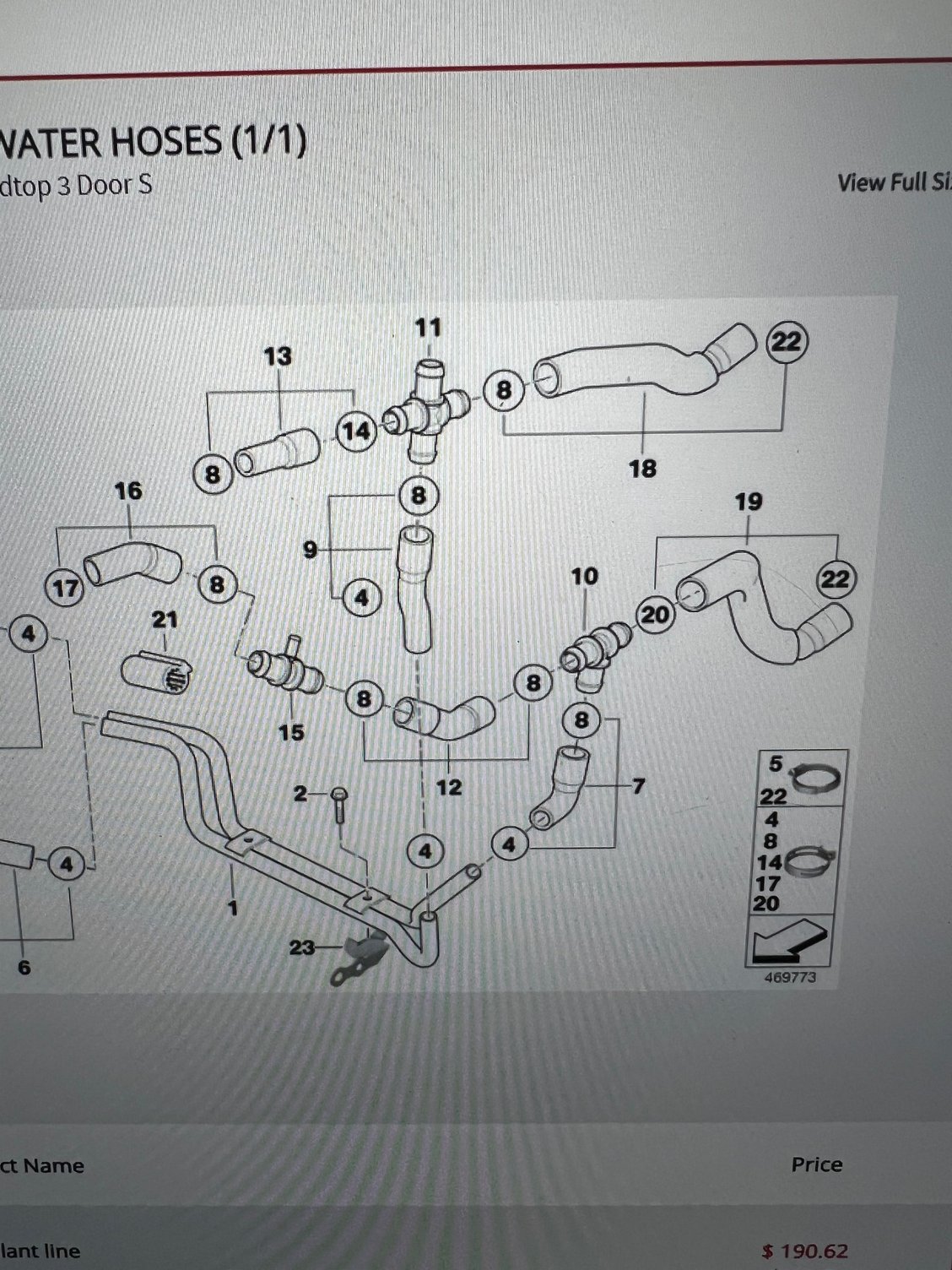

This diagram deff helps!

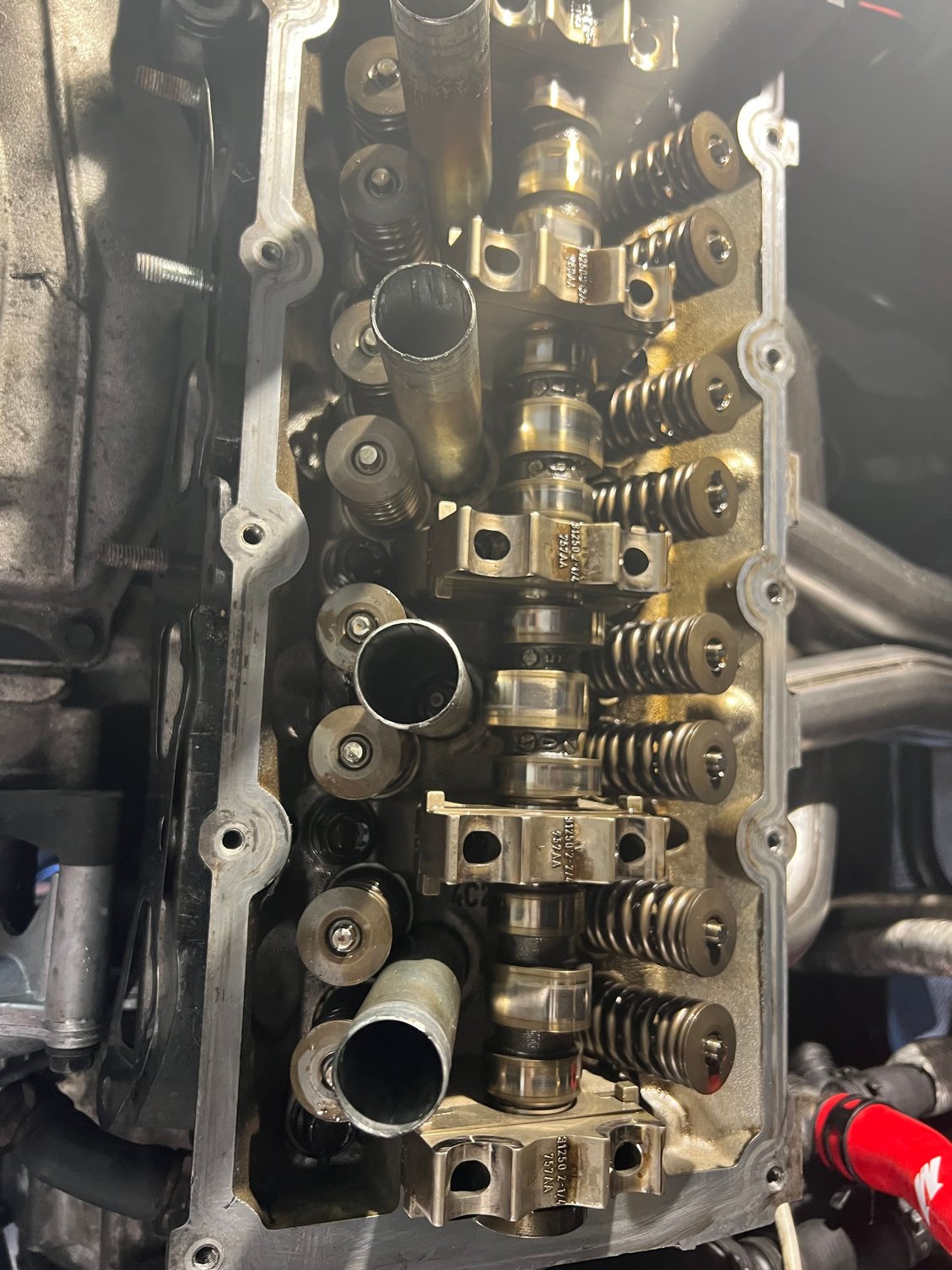

pic before removing stock cam.
one trick was to leave the cam sprocket tool attached to the sprocket as you pull the it off the cam so it never moves or skips any teeth. After removing tensioner of course.
Cam installed and torqued down, partially assembled. Just through the red stuff on to see what it would look like. I also installed the 550 injectors and pig tails. I must have the wrong belts, I can’t get either of the two I have to fit.
you also have to ping in the spark plug tubes because the lobe of cam hits when it comes around about .010-.012 thousands of an inch. I used a ball end of a small hammer.
