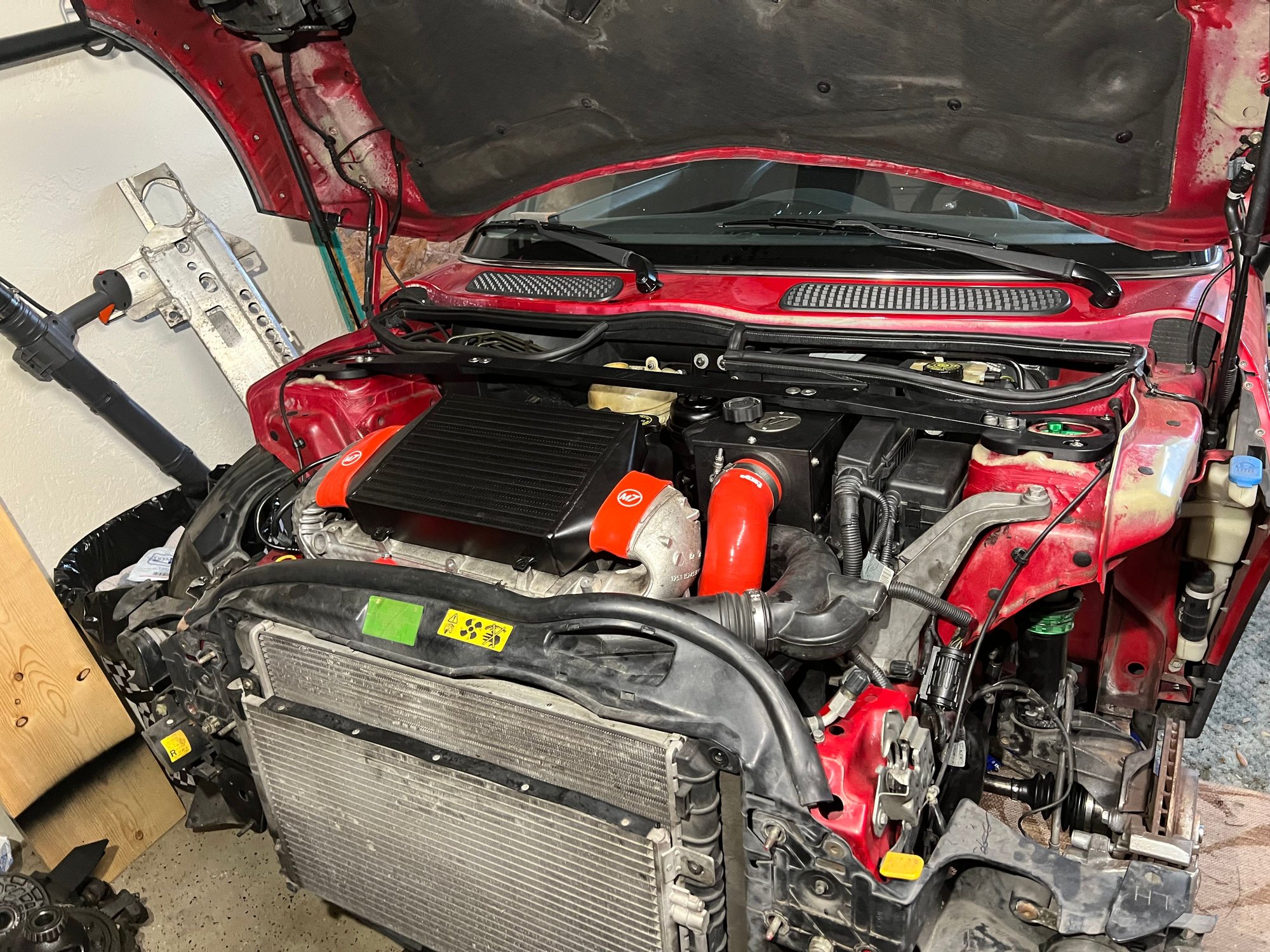

Yesterday I started back on the assembly again, it's HOT af here in florida soo my guess is I lost a few pounds working out there LOL. I wasn't able to get the broken bolts out for the clutch master yet, but I did assemble the throttle body and coolant lines, all the M7 intake box and ECU. Also got the M7 strut tower brace on. Filled the transmission with fluid. Replaced the rubber fuel line on the throttle body also. I need a better air compressor to run a grinder so I can cut the bolts down flat to drill them out better, on the list for next weekend, grind down the little bit of clearance needed to fit the bigger intercooler on top to sit flat so it lines up better. Not too much more to do before I can start it up! Once I get the clutch master bolted back on, I can bleed the line, then bolt up the coolant front end and fill with fluid and bleed that, then start it.

Making some progress today!

Just need belt to arrive today, and I can start it up and flush the coolant!

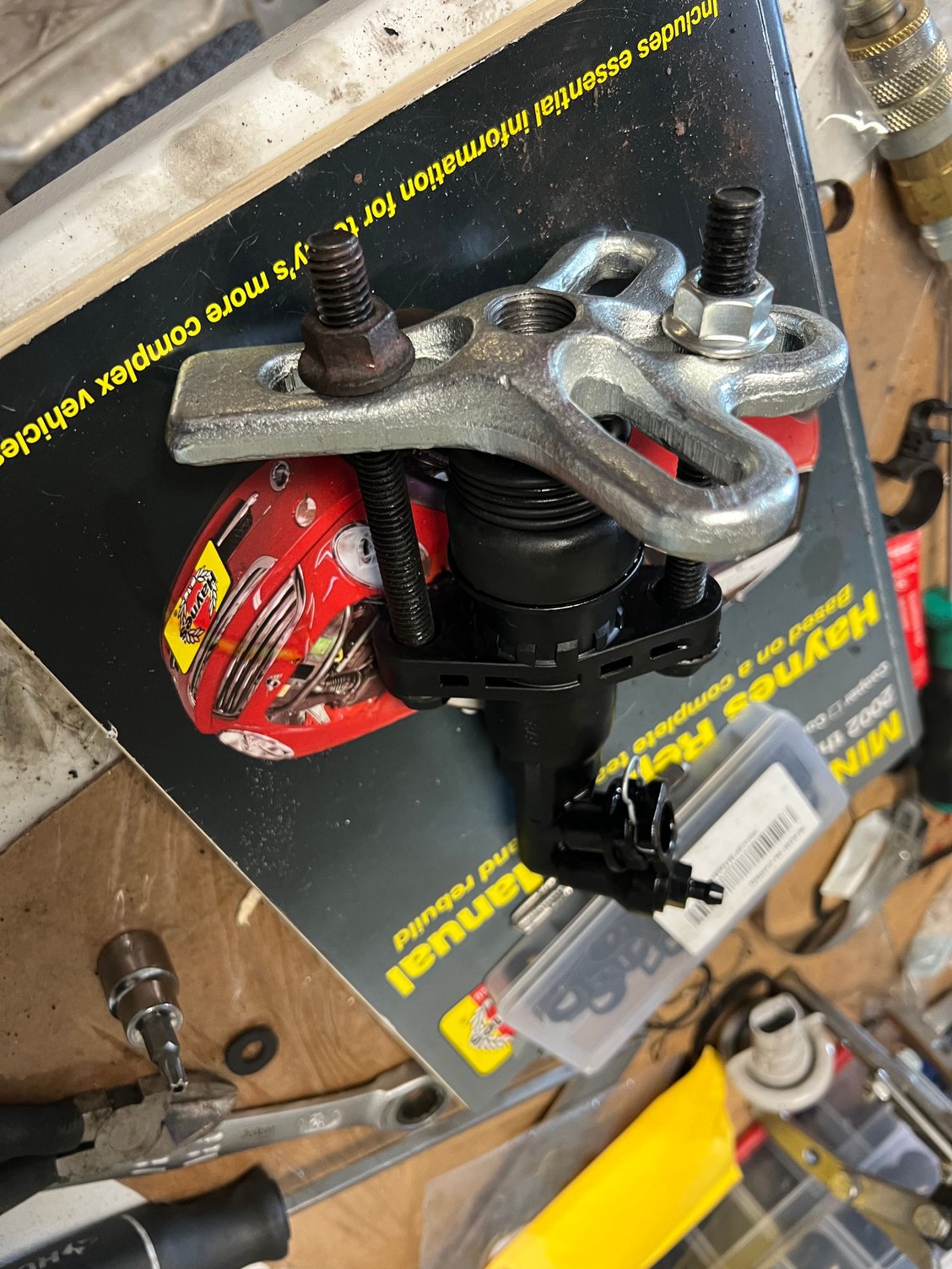

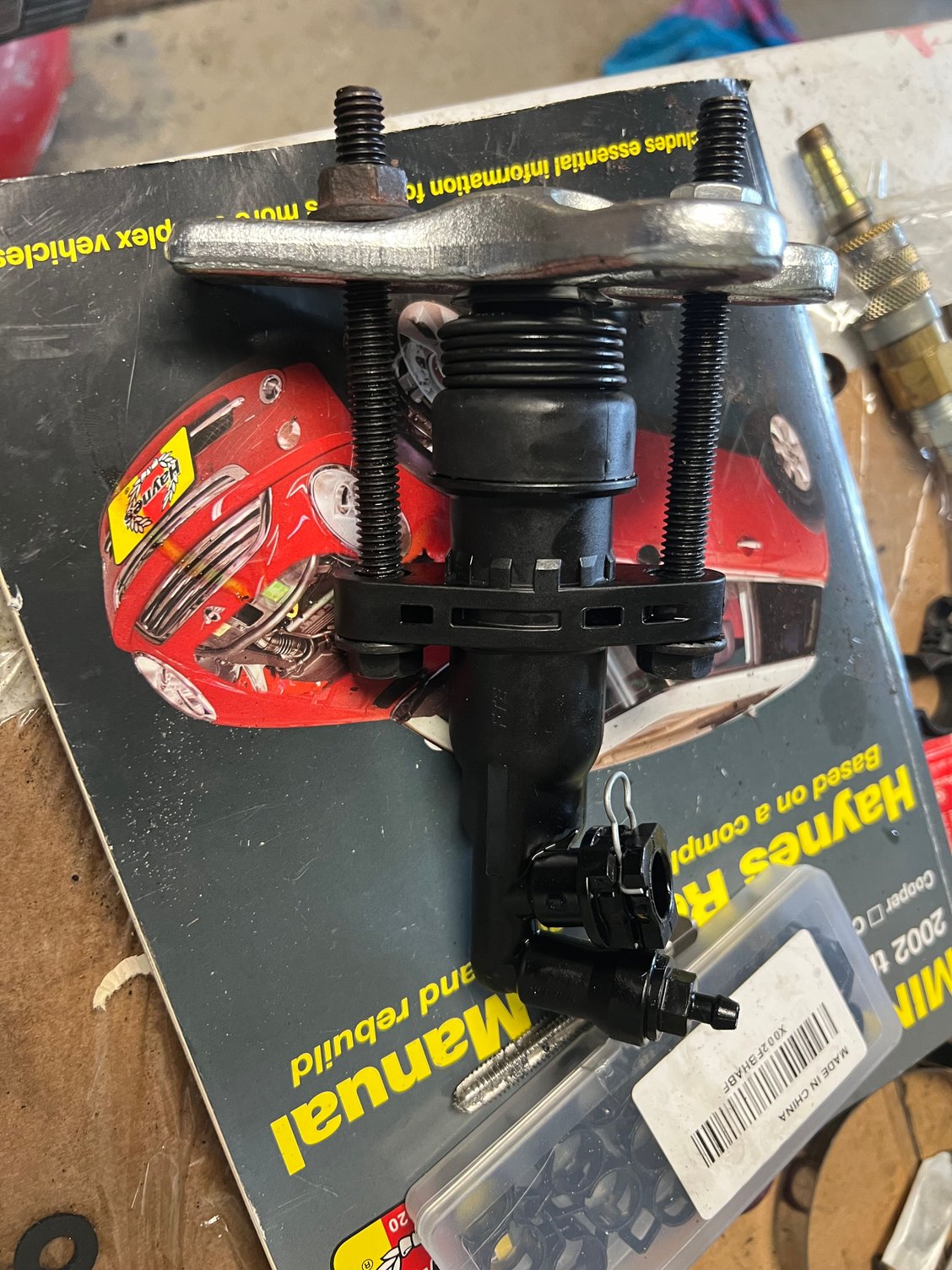

After doing some reading about clutch slave bleeding, I came up with this idea to compress mine, without making something up or buying the expensive tool used. It worked great. I used my crank pulley tool.

Yep that will work. Just watch that plastic on the part, its not a full metal unit like the older Gen 1 MINIs.

Taking the slave off to compress and bleed isn’t that hard. It was pretty easy and clutch feels new. I used a power bleeder to put 16-20psi in the lines.
