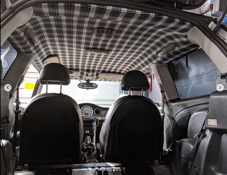

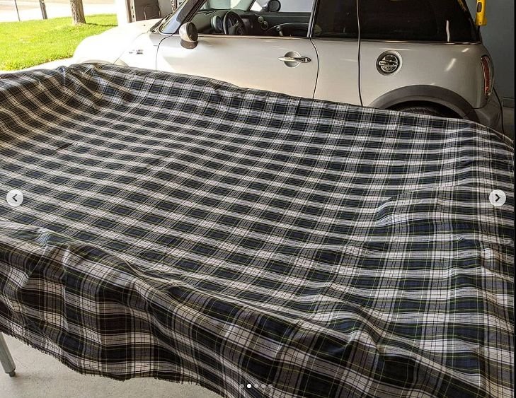

I did mine over the span of a weekend. Again, hardest part was interior removal. I have a hardtop, so no messing about with sunroofs and such.
I bought some random fabric on amazon, because I wanted plaid headliner. Hardest part of it all is just getting the fabric to stick while you're working with it, trying to avoid creases or areas with gaps. Being patient helps.

Plaid sounds cool how does it look?

Old Mar 16, 2023 | 01:15 PM
AngryScotsman's Avatar
AngryScotsman
Joined: Jun 2019
Posts: 176
Likes: 94
It's only really noticeable if you're looking for it. Otherwise, the windows are tinted so it doesn't stand out as much.
I frequently forget it's there.

It looks sharp

I never would have thought plaid would look this good as a headliner.
I have to admit it is unusually awesome. Nice job!
Pretty cool @AngryScotsman

looks surprisingly good👌
