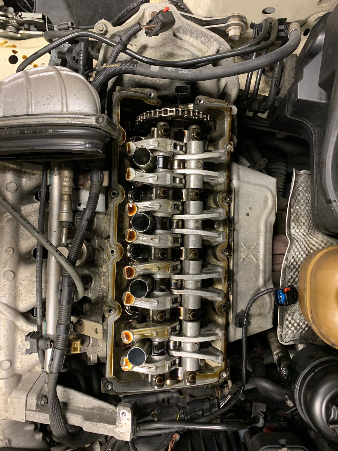

I had recently heard a ticking sound on my new 04 r53. 77k. At the time of purchasing I heard a ticking sound but figured it was just low on oil since I had a valve cover leak to which I replaced the valve cover, got an oil change, and the sound is still there! Timing chain seemed tight and fine. All rockers were tight and snug. I’m really at a loss of what this ticking sound could be. I’ll list the link to a video of the sound. There’s a bunch of sounds honestly. One from the left side of the valve cover(passenger) and one on the other side(drivers) which is what the video shows. The other ticking sound that I’ve heard is from the supercharger. Records of the car does show something regarding supercharger oil but I’m honestly not to sure it was done. It doesn’t seem that way on paper. I initially thought it was timing chain tensioner but I tried doing the tensioner and the bolt is rusted to the block I couldn’t do it. I just started to round the bolt. Any help is appreciated

Could a slight ticking sound come from my valves? I dont know how but maybe the sound originates from the valves retracting into the head creating a ticking sound? I really dont know and its driving me crazy. I will post another video of the sound as its more obvious compared to the other videos I have linked.
