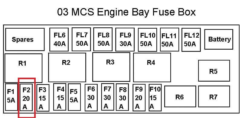

Check fuse F2 is 20A located in engine bay , this one is used for ignition coil crankshaft sensor and injectors .

Fuse is good, new spark plugs. I put an inline spark tester and still no spark. Tested the new coil with a multi meter and it’s good. I am at a total loss.
