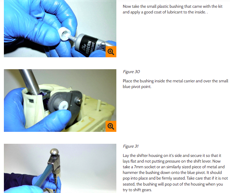

Pelican parts has a great tutorial of installing one.
https://www.pelicanparts.com/techart..._Shift_Kit.htm
Snippet clip which is relevant here:

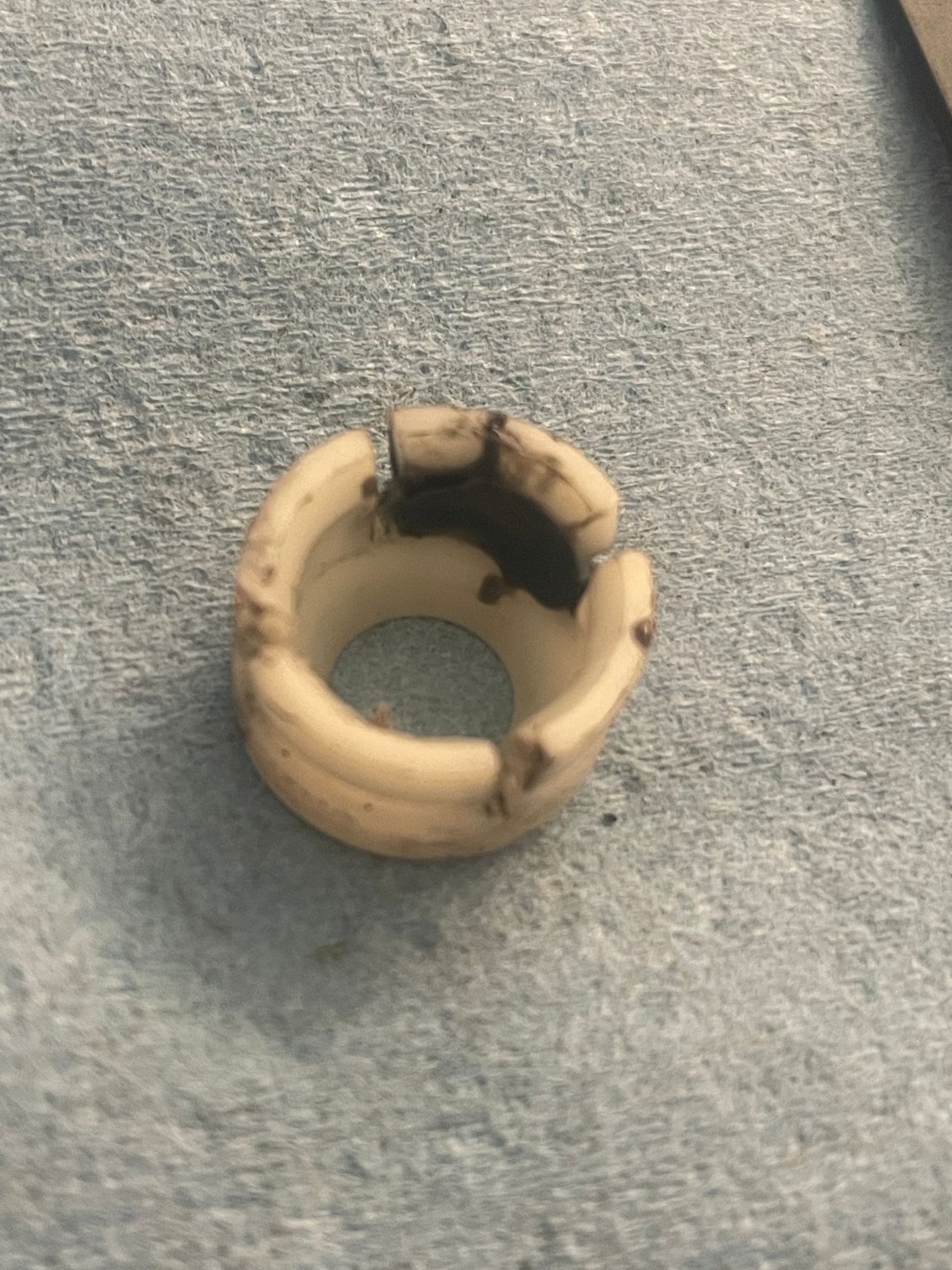

Literally snapped this bushing as i saw this post, but i jb plastic welded it back so i hope it works for now

i need the plastic pivot clip looks like this
