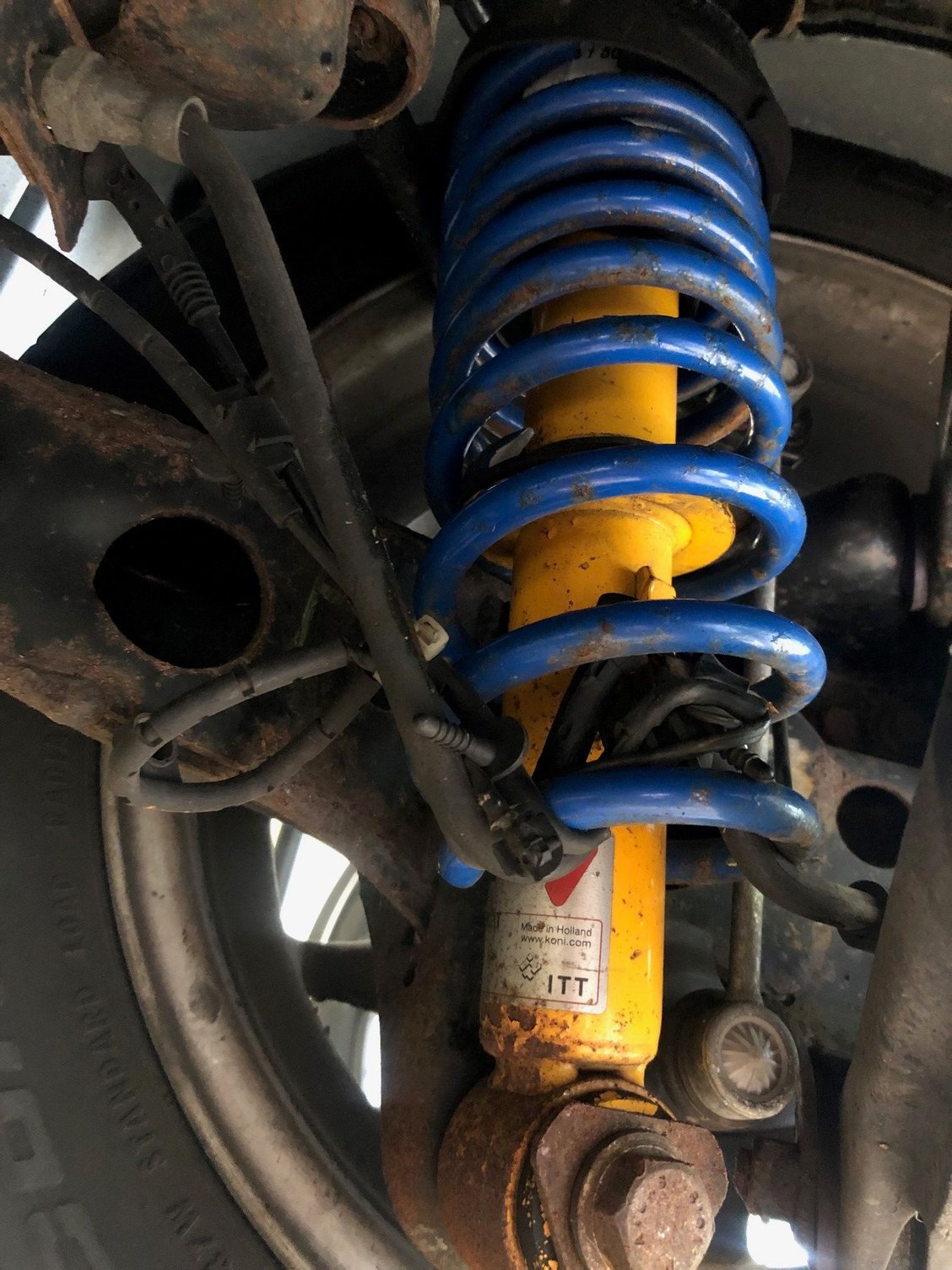

So, driving down the road I hit a bump and hear the car bottom out. Weird, since I've been down this same stretch many times and it's never happened before. Weirder still, the ABS, TC and TPMS lights all come on. I wasn't far from home and the car seemed fine otherwise so I took it easy and made my way back. Pulled a code for right rear wheel speed sensor.
I peek under the car and see the spring snapped and extended itself beyond the lower perch and took out the wire to the sensor.
These are H-Sport springs on the car which I installed because they were supposedly less aggressive than other lowering springs. I'd like to get replacements that are similar, not too stiff and not too low - primarily because I don't want to deal with excessive camber (replacing control arms).
Can anyone recommend a set of springs like this?
While I haven't gotten the car up on blocks yet I'm sure the rubber brake line has been compromised - it's also the original factory hose, 18 years old. So I'm looking for a set of SS brake hoses. Any recommendations on those? Cheapo ones off ebay won't do it. I'm looking for something high quality.

I already have Koni adjustables on there, which don't have a lot of miles on them. So, the desirable route is to just replace the springs. I did some searching around and it seems by best options are H&R, Swift, and TCW. I saw some unfavorable reviews of swift, so I crossed them off. TSW look good but I'm not convinced the linear spring rate is what I want. So, I settled on H&R. Probably the most aggressive of the three but close to the H-Sports I have.
The only problem - NO ONE has them in stock (thanks Covid,I assume). So it's a waiting game. I'll probably throw the stock spring on there for now just so I can move the car in/out of the garage.
I think you're right about the hoses. If the factory ones held up this long then that's a good reason to stick with them. FCP is my go-to for replacement parts - I have them on order along with the new sensor.
It should be fun disassembling this mess, there's still lots of tension in the spring. I think I'll just cut through the hose (carefully). It's contained by the shock so I shouldn't get impaled.

Fyi, you are missing the rubber boots which shield the lower bolt of the rear struts. Number #22
https://mini.7zap.com/en/mini/r53/co...ce/33/1186/#22
Old Sep 1, 2021 | 10:10 AM
mrbean's Avatar
mrbean
Joined: Aug 2003
Posts: 839
Likes: 225
Yup, fully aware. One went missing so I removed the other for the sake of symmetry. Probably a mistake, I should get a replacement.
