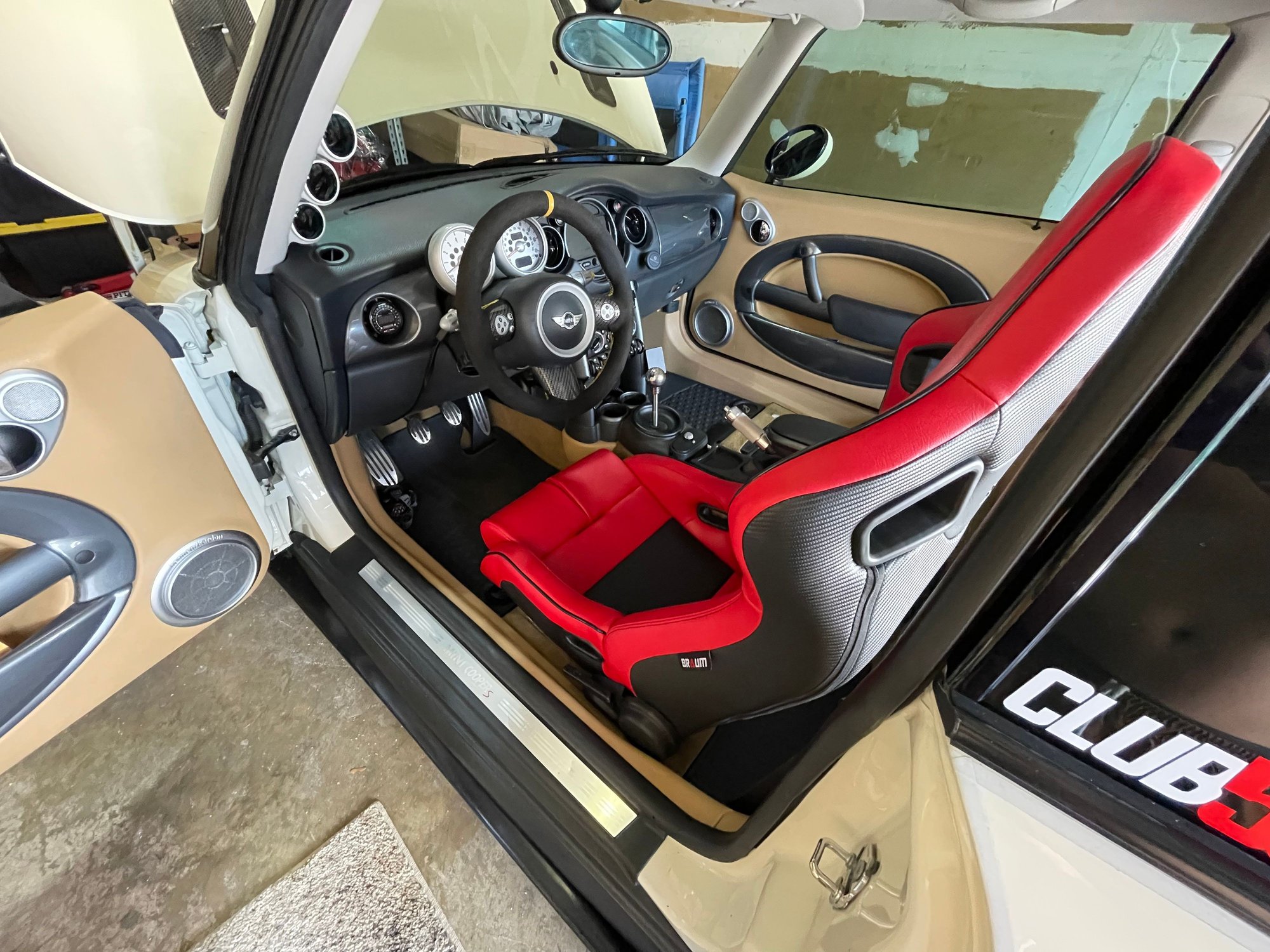

Was so excited to instal my BRAUM Racing seat today. Getting ready for the car show tomorrow.
everything was planned out. Did my researched. Even soldered resistors to a spare abs and seat belt plugs.
then come to find out the seat brackets didn’t line up to the BRAUM seats.
i original wanted to use the OEM sliders with my set up. That why i chose that bracket.
so, learned it the hard way. Have to send the brackets back. Still waiting on their confirmation.
had to put the OEM seats back and forgot to plug it in. FML plug the battery and started the car , now i have the damn AIRBAG light on. 😡
Here’s a sneak peek of the seats. Photo up with no brackets.

Planted Seat Brackets fits perfect!
FYI if you have a NAVI set up you gonna need spacers on the passenger side, Brackets will be touching the NAV plate under the seat.
