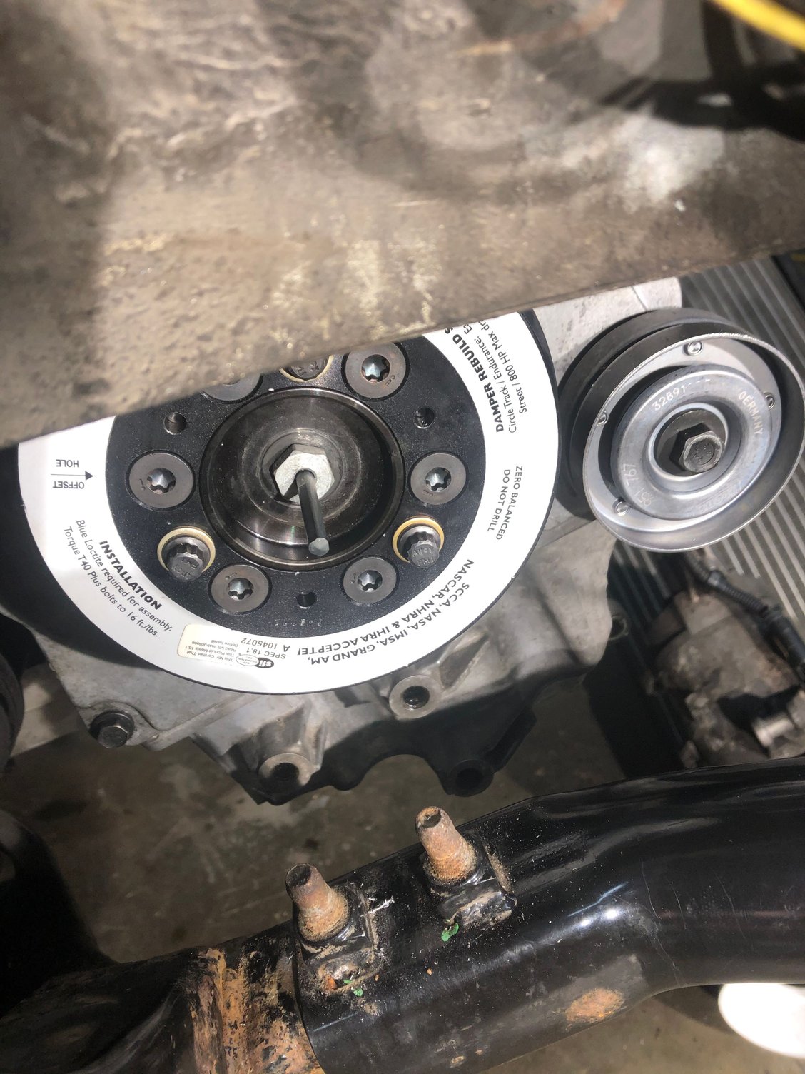

Well got crank pulley on straight, like everyone said didn’t go on too hard . But of course I had to keep going and do this ... such a dumb @ss!
Picture definitely worth a thousand words😐😐
any thoughts on how to get rest of bolt out? Drill center then easy out? Was all set and then gave myself hours worth of fun....

ugh, that sucks! I would say proceed with extreme caution. If you screw this up, you're looking at a new crank/motor. The method that I've had the most success with is using left handed drill bits and progressively larger drill bits. The first hole is the most crucial. you want it to be in the exact center, and the worst thing you could do is break a drill bit or eazy out in there.
Go slow with firm but not too much pressure on the drill and lube wouldn't hurt. I'm sure there's a special cutting oil, but I usually use wd-40 because that's what I have.
The other idea is to pull the pulley off and see if you can get a hold of the part of the bolt that's sticking out. just depends on if you think theres much sticking out and if you can get the pulley off.

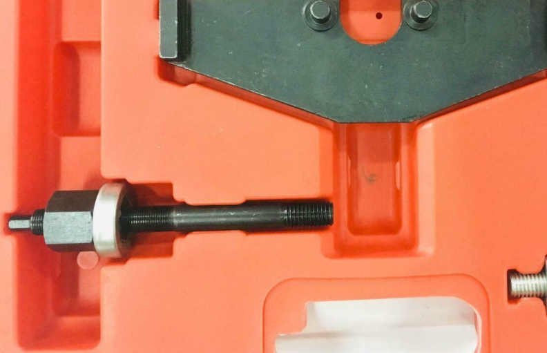

remove the damper and drill it out with a reverse drill bit and bolt extractor.
buy the correct tool to reinstall the damper, and make sure you heat up the damper before you install it, the correct tool comes in timing chain kits, it's the tool that's on the left of this picture. they have the bearing nut installed backwards on this picture but that's the right tool

better picture of the tool

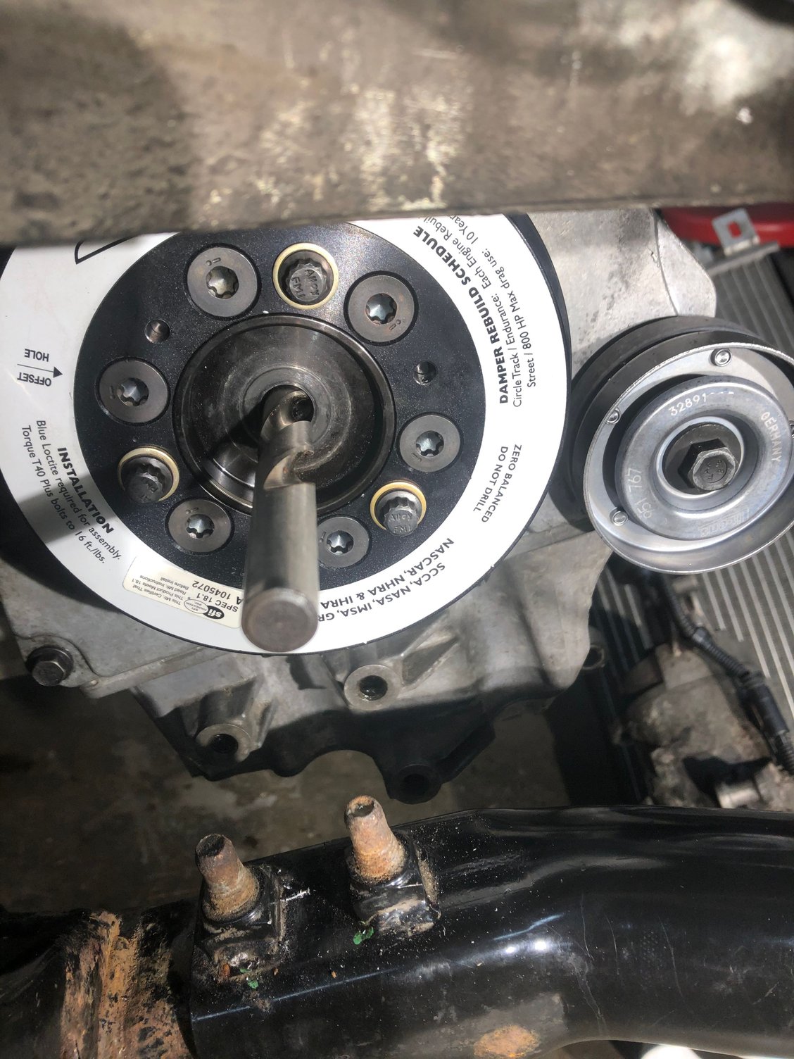

My fix
So after reading posts,I had the pulley on slightly crooked and once it was straight it went right on. I did heat it for 15 min to 250 degrees. Broke bolt by to much impact driver, should have used torque wrench. Here’s how I removed broken bolt:
1) used a 31/64” drill bit to put centering mark on the broken bolt, it broke where the threads start.
2) found a bushing ( it is a brake line fitting) wrapped it in electric tape slightly to make a guide for a 3/16” drill bit, drilled shallow hole
3) switched to 1/4” left hand bit and broken bolt came right out!! - 🤦🏻‍♂️ Miracle!!
Thanks everyone for all the help, hope won’t do something this dumb again! -E

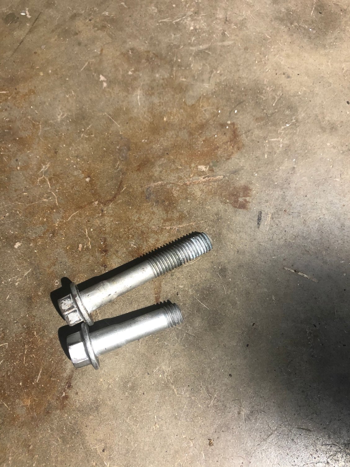

good idea with the brake line fitting! always a pain drilling bolts out, we need to see a picture of the bolt !

Threw the broken bolt in the bin, then couldn’t find it! Thanks again everyone!
