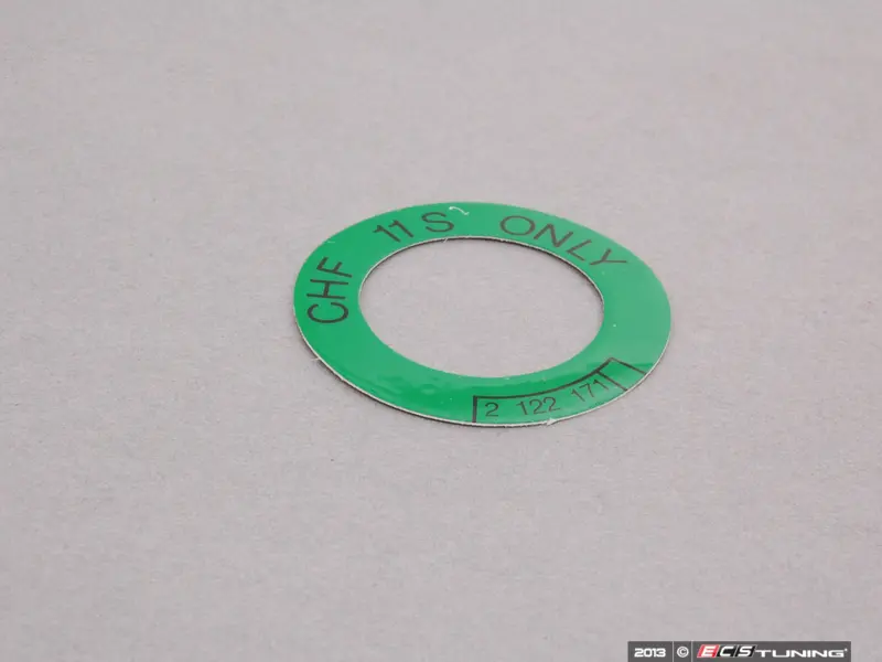

Yep they grabbed or replaced it with the wrong cap as its shared on some BMW ATF systems.
CHF 11S Pentosin stuff and thats the sticker. The filter is built into the reservoir also. We have an upgraded unit.
We have an upgraded reservoir unit. You can get that CHF11S sticker and put it on the turner unit.
https://www.ecstuning.com/b-turner-m...ni/c-steering/
Stock reservoir with filter
https://www.ecstuning.com/Mini-2005-...ing/Reservoir/
https://www.ecstuning.com/b-genuine-...212122171~oem/
