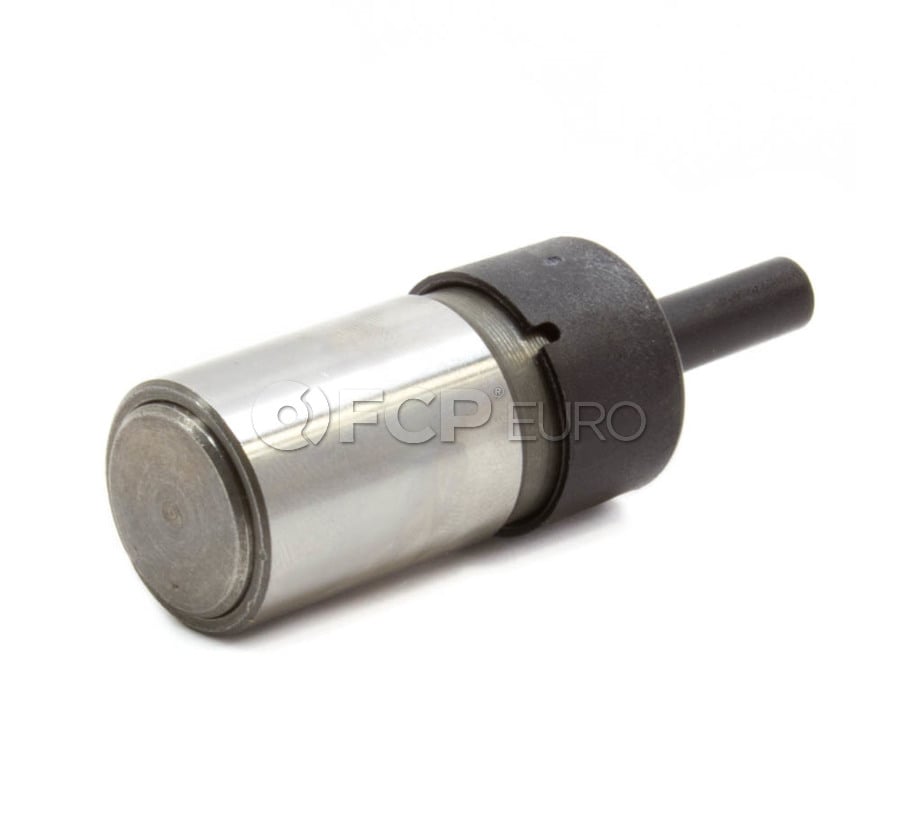

Is this what we are talking about?
Old Nov 18, 2020 | 12:07 AM
nd-photo.nl's Avatar
nd-photo.nl
Joined: Jun 2020
Posts: 1,146
Likes: 313
From: The Netherlands
Yep, also see
