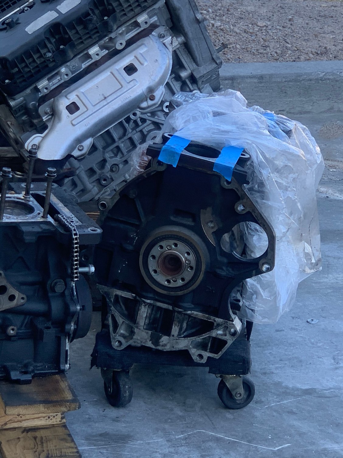

good luck with your build , as i am secretly doing the same as well, currently getting the block re-ringed honed new bearings rods , grind crank .. refresh head
