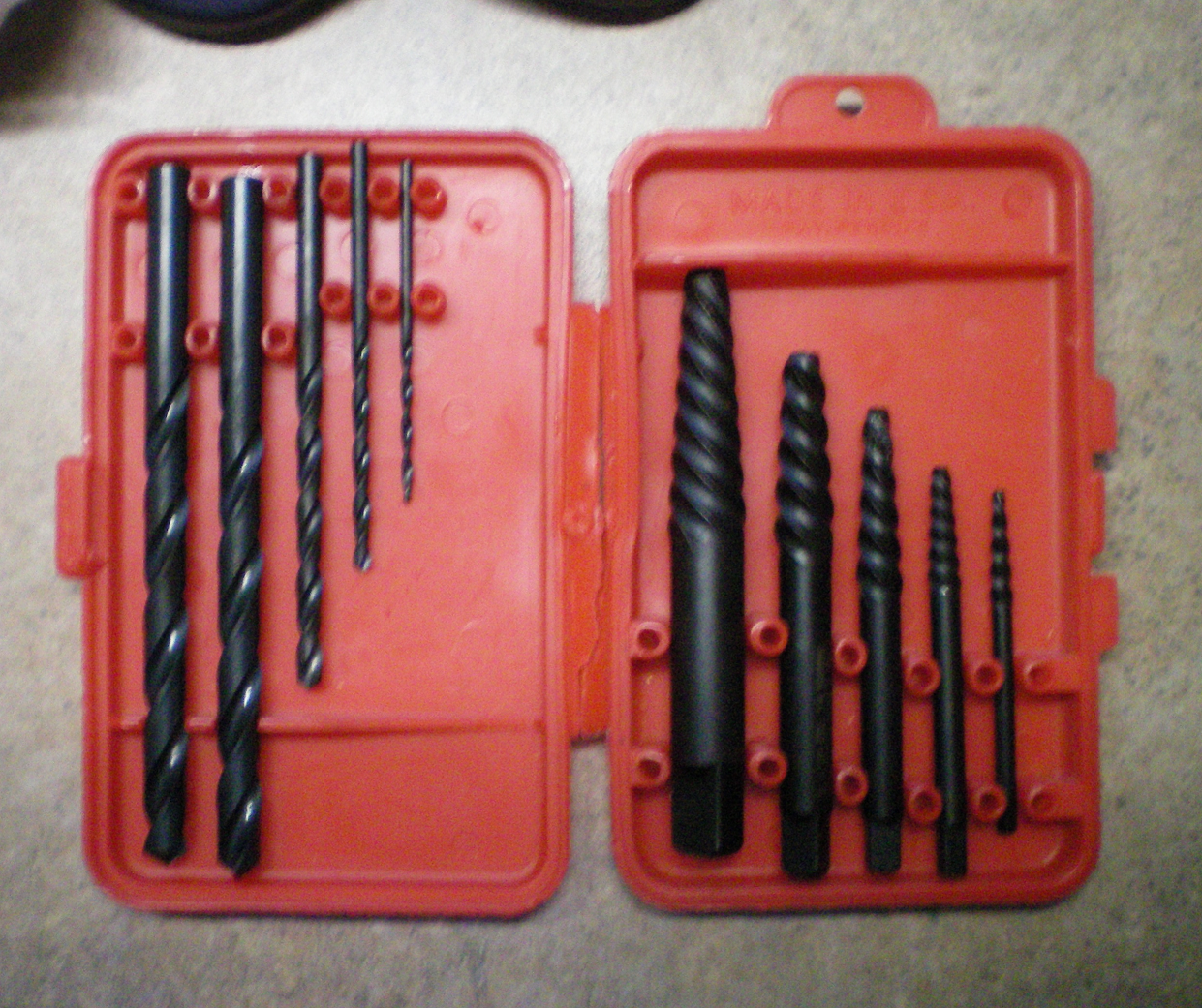

there's a correct tool for every task
set includes strengthened bits to drill the pilot hole (a center punch helps start things)
and the tapered extractors are left twist with socket ends in case you needed extra UMPH to break it loose .....
Amazon $14
