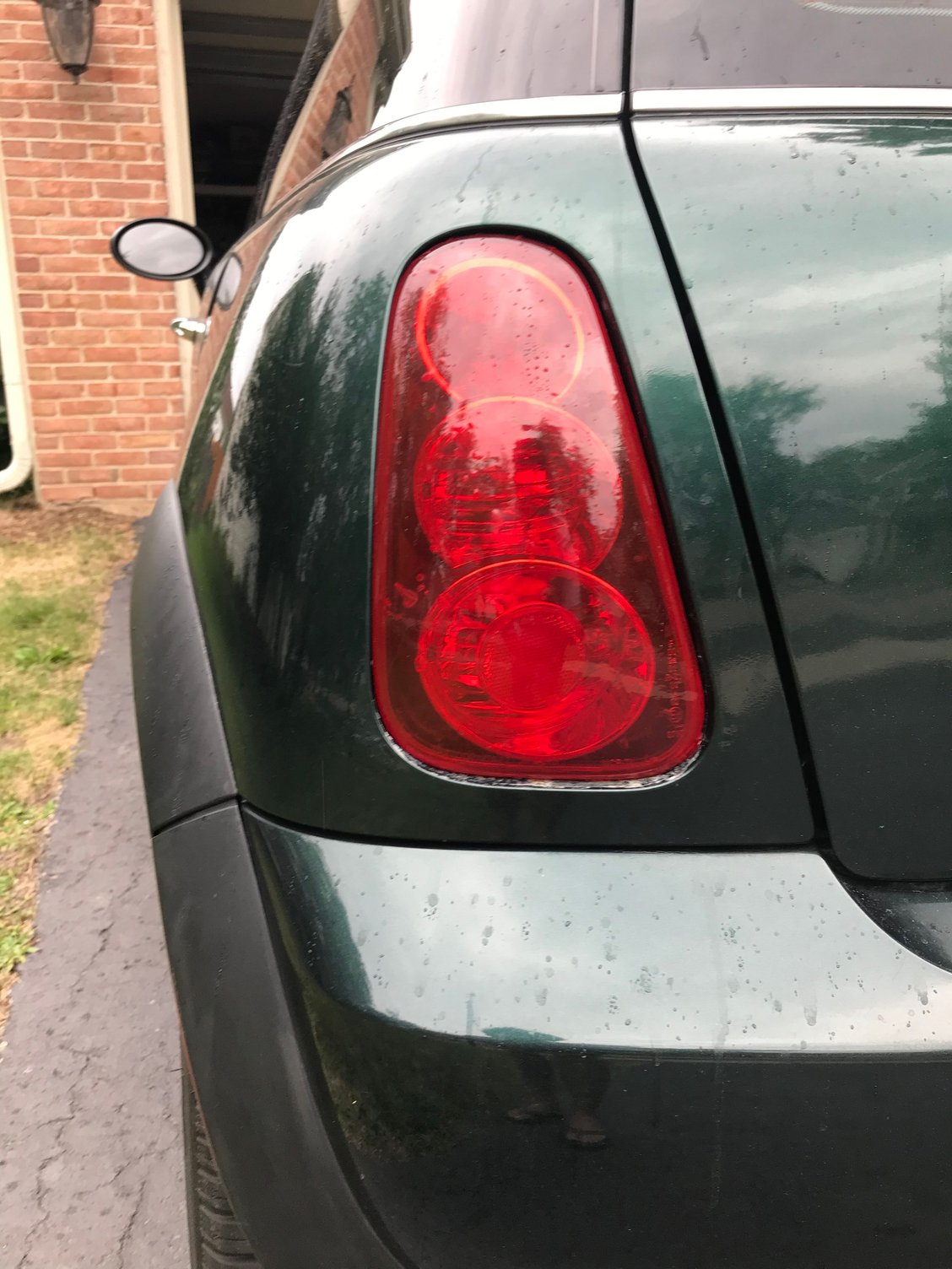

Pictures can be deceiving- looks pretty nice, but has the typical tailight rust, some door rust under the seals, and some rust on the bottom seam of the doors, not to mention underneath. All this will be patched up in time, but for now, I am hoping to refresh some mechanicals, and then drive it til things start breaking! I hope to use this area as a progress thread for what I do to it!

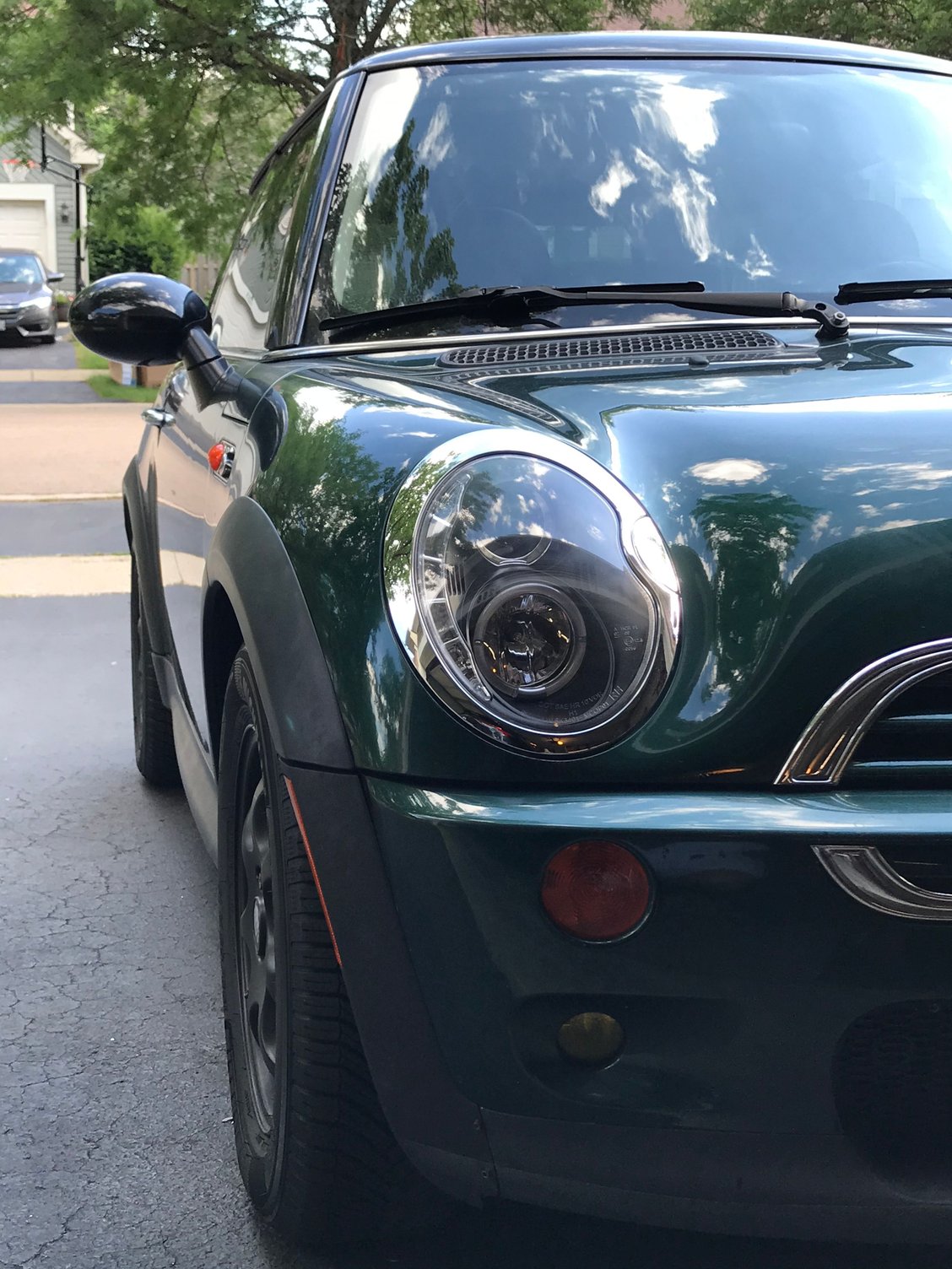

-Made the fog lights yellow, touched up the worst rock chips and scratches

-Cut out parts of tailight to determine extent of rust- ordered a welder and got metal-gonna try to fix it.

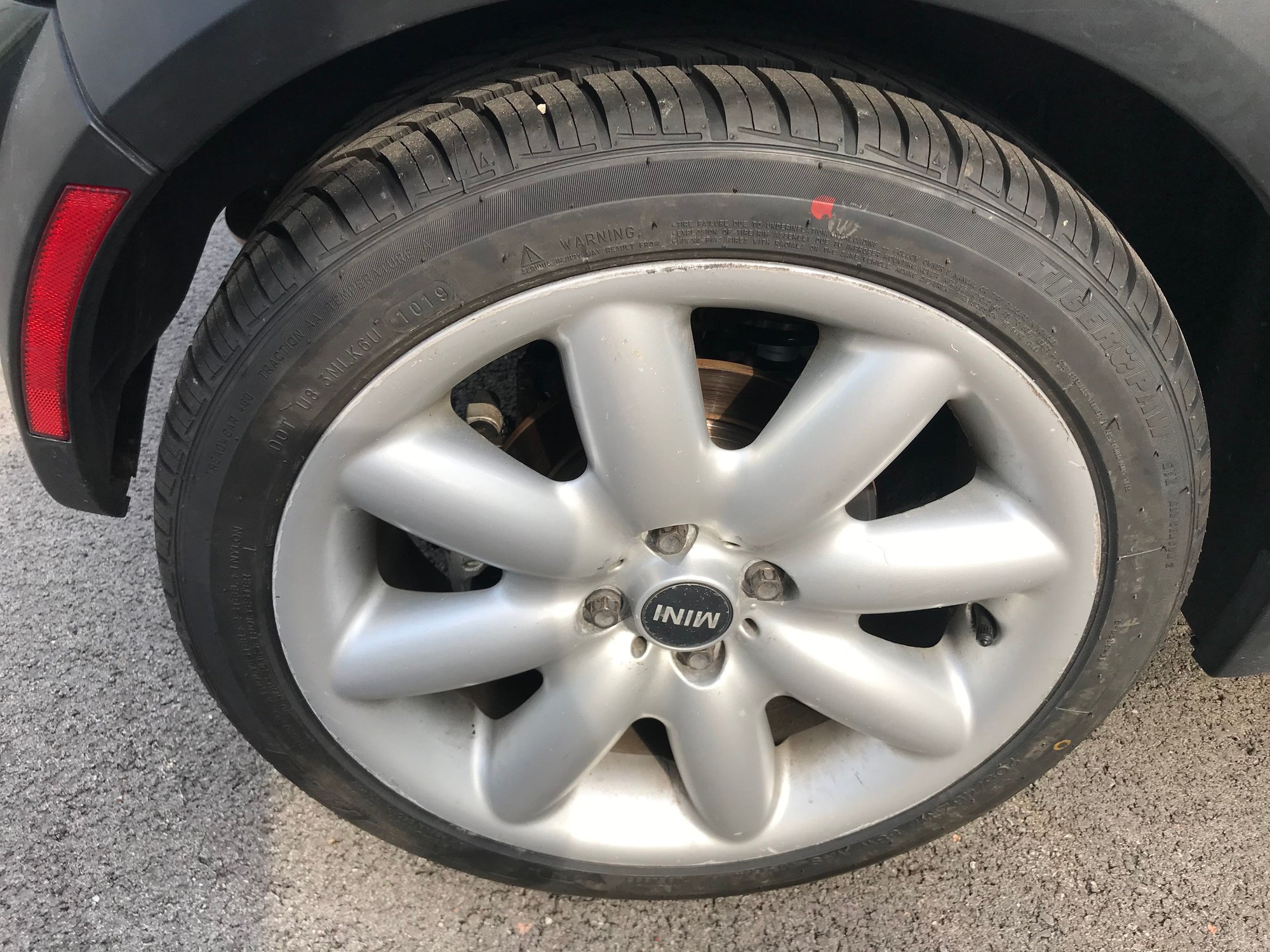

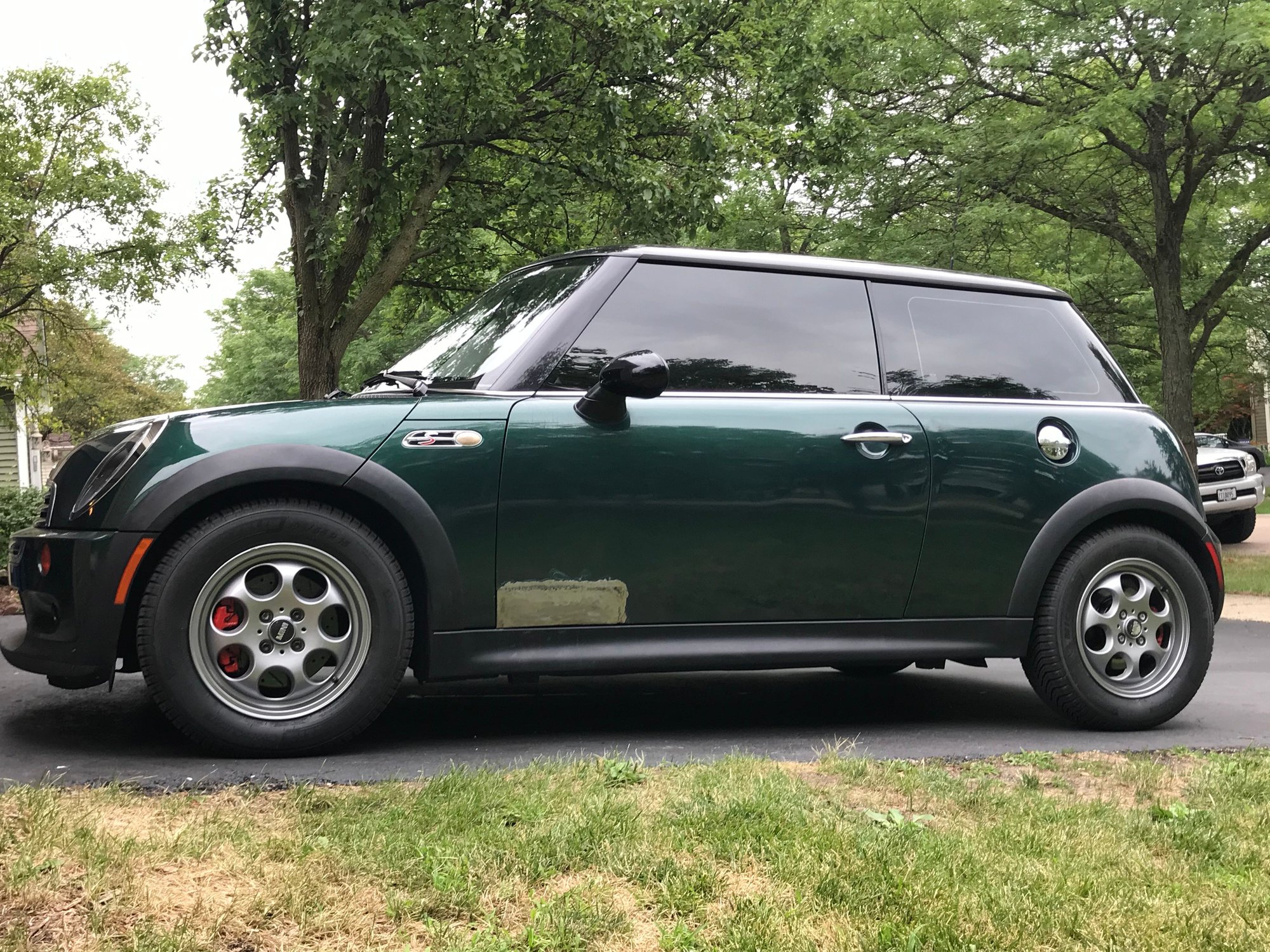

Here's one of the wheels til later...

Interior with new shift adapter and my TRD shifter! Love it- feels so right.
Both doors have rust creeping under the factory weather sealing- gonna require some ripping apart. I do not care about the factory appearance- just want to stop the rust!
Added killmat and vibro foam vibration dampner- noticeable. I also did this to the doors and back seat pan. I have an aftermarket exhaust (still not sure which kind?) and it is a little louder than I prefer, but sounds good. This helped me, but Im not sure it will change my neighbors opinions.
Looking a little rougher than when I started, but in reality is so much better!
Chop chop. Still gotta sand it to metal, bend my sheet metal and weld her up. I am thinking of making a bigger patch, cutting away a little more, and then just clearcoating the raw steel patch. Not really worried about factory appearance and want to embrace the frankenmini look. Tail lights would get the treatment when I cut and patch them.
This is the worst wheel- filed away all the high spots, will fill with JB weld and probably paint this wheel and just touch up the others.
New tire I mentioned before.
Engine mounts
Didn't use the washer that came with upper engine mount. Anyone else doing this? Did supercharger damper and bushings too.
Got some menards AC gap insulation and it fit perfect- both sides of radiator were missing.
Yellow fogs- I like them on pretty much all cars- have them on my truck too.

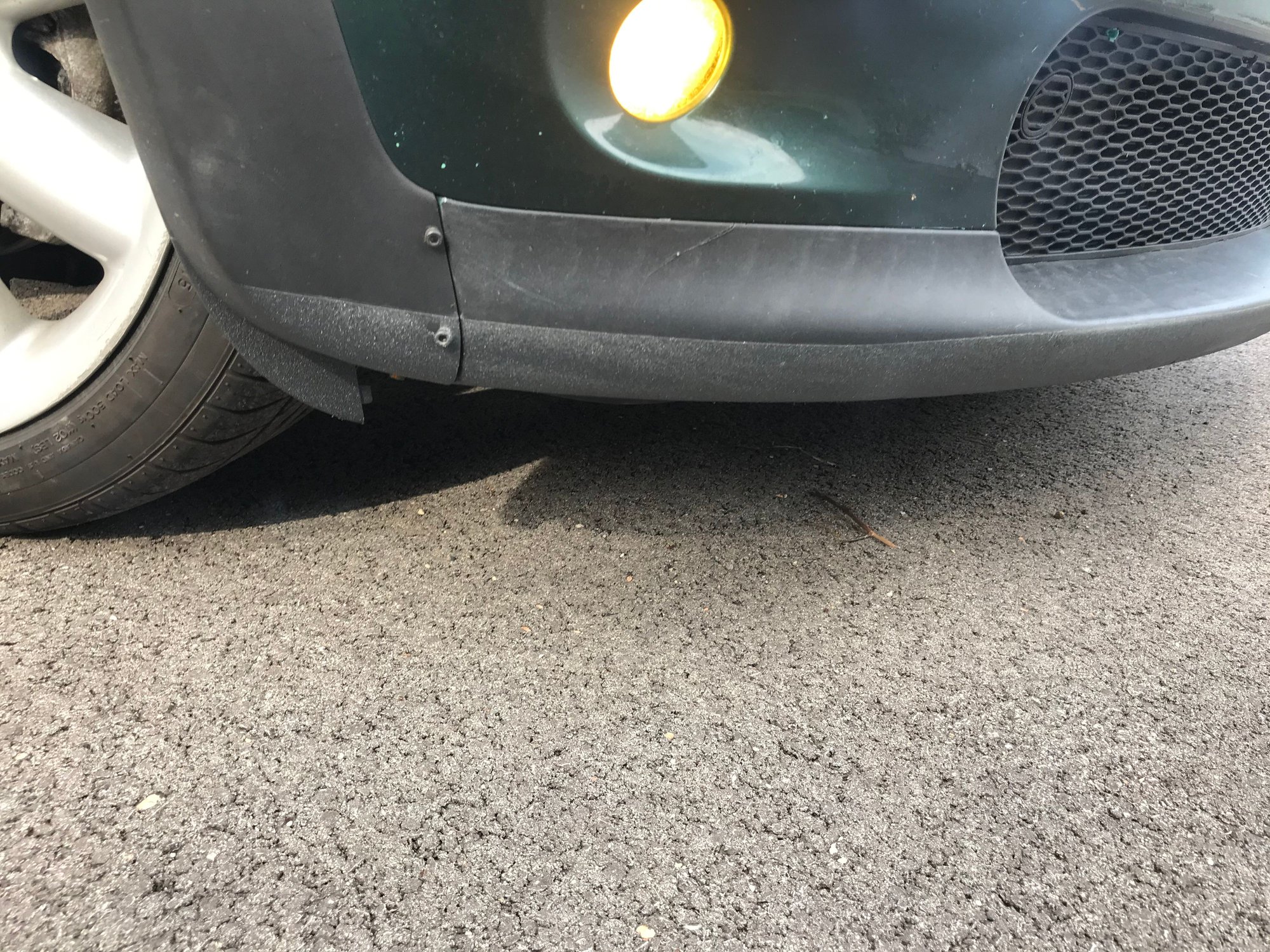

Bumper coated the lip, and did a little Frankenstein reinforment of bumper as mine had gaps both sides.
Thinking of painting these myself- anybody have gunmetal or grey r81 wheels on your ride? Suggestions for tire size? I will probably go with the biggest I can fit. 215/?/ 15? Ideas?

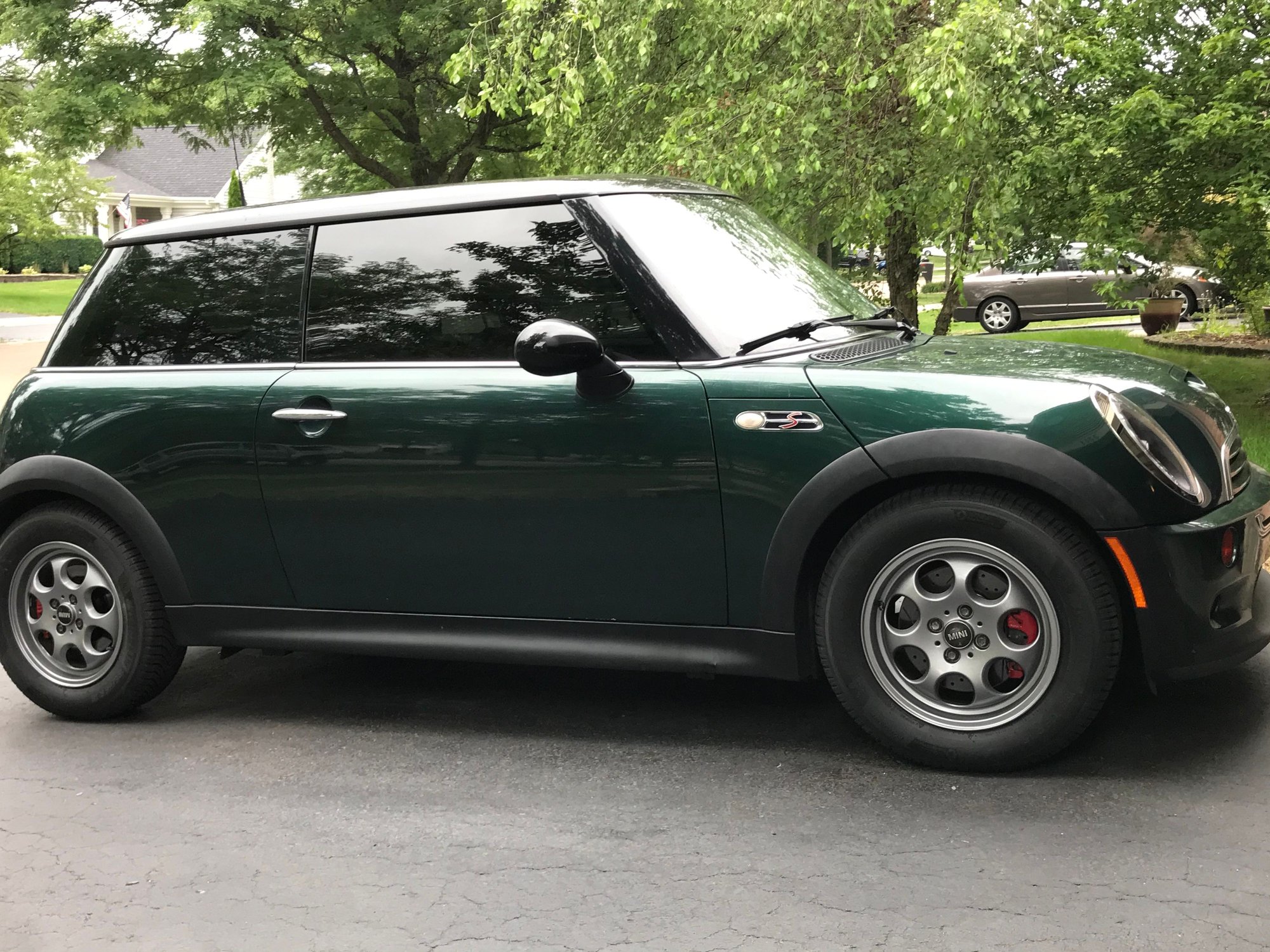

Wheel and tire switch

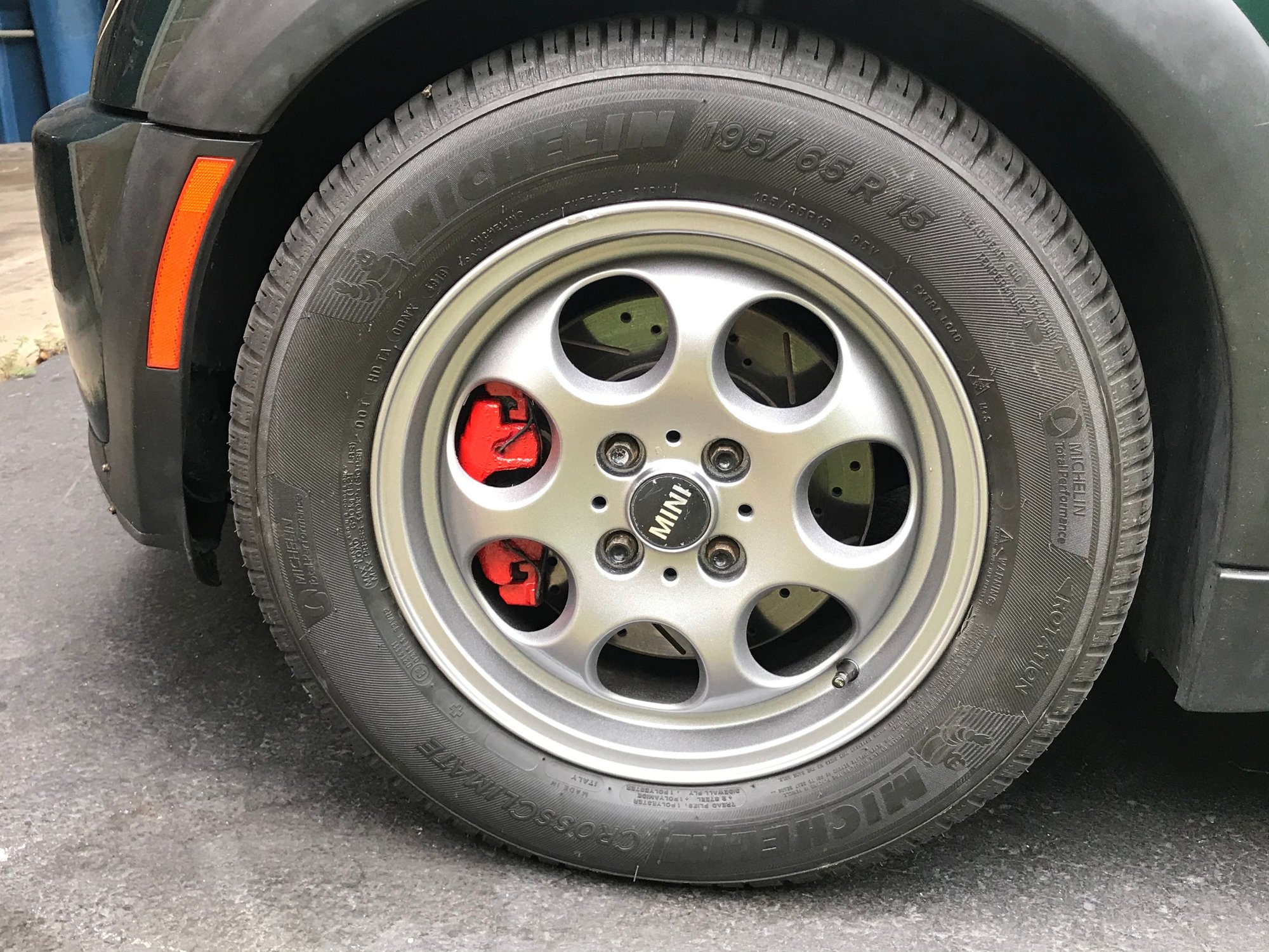

Just wanted to add to this thread for anyone shopping tires and wheels. I had found posts of people with the r56 saying this size cleared, but nothing definitive for the r53.
I had s lites with 205/45/ 17 on and switched to the r81 Imola wheels With 195/65/15 and they clear with some room to spare. Haven’t hit any hard bumps to see if they clear fender liners on suspension compression, but I can slide my hand behind every part of the tire lock to lock, so I suspect I am ok. Can already feel the difference in weight of the wheels and power steering- I think I’m gonna love it. Don’t care too much about the taller sidewall compromising cornering. Will update with a picture shortly- car getting aligned now.
one note- I am on almost brand new stockish suspension (bilstein b4 with stock springs) so once things settle fully, might be a little closer!

Tires
New tires are Michelin cross climate in 195/65r15.
80$ each corner from discount tire. Should save about 20lbs per corner vs the s lite setup:
s lites were about 26lbs, r81 about 13
good year summer tires in 17in were about 25lbs each, new Michelin’s are about 18lbs each.
on 17s- 51lbs per corner
on 15s- 31lbs per corner

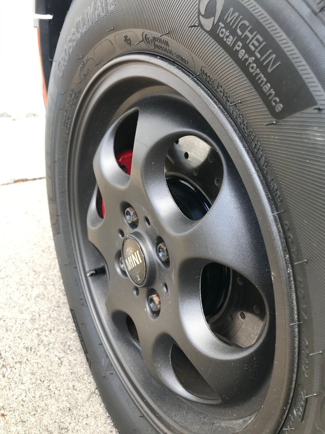

Pictures

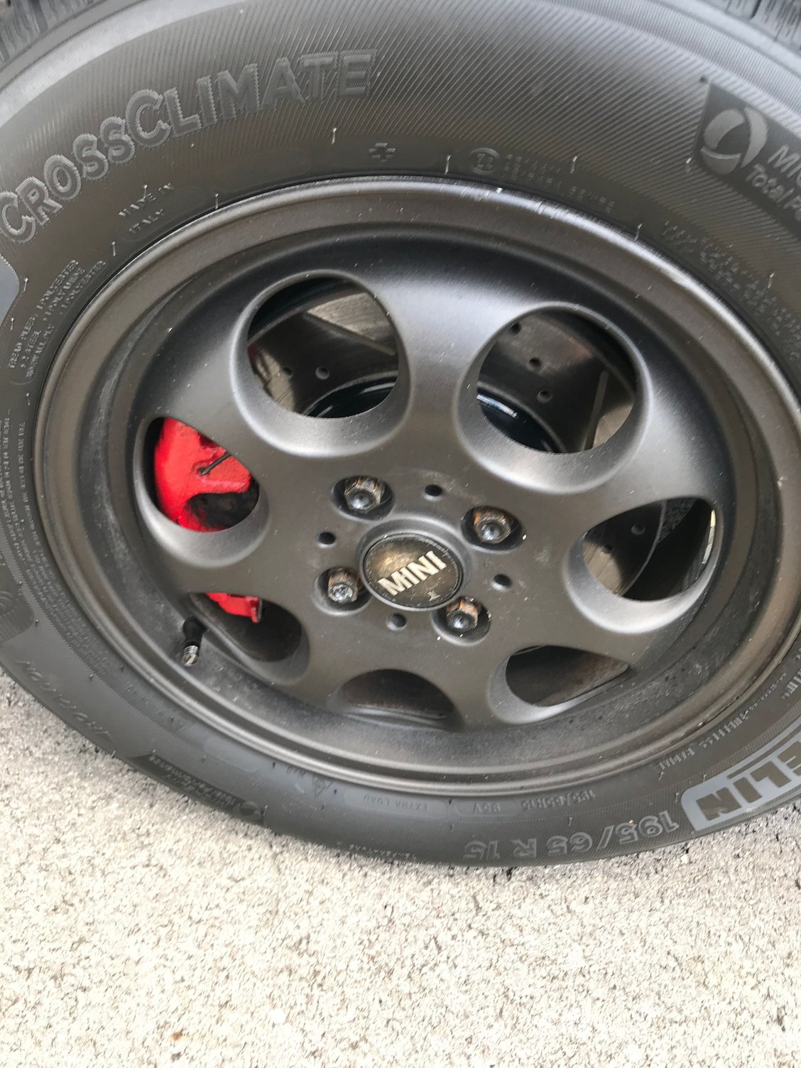

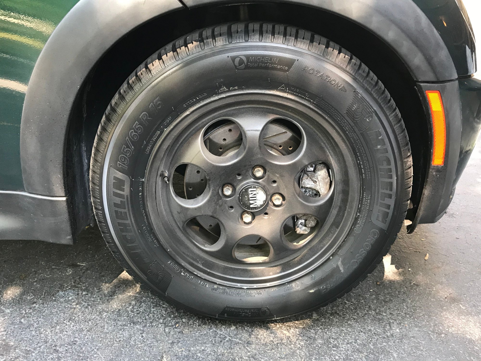

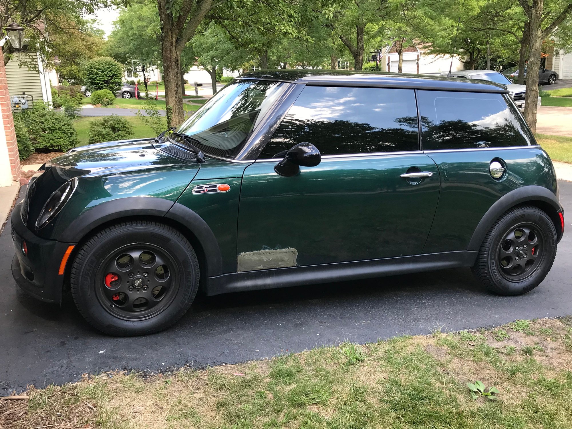

Wheels look black right now- hoping they will wear a little. Color is oiled bronze rust oleum paint and primer spray with a matte clear coat. You can see the bronze in the sunlight.

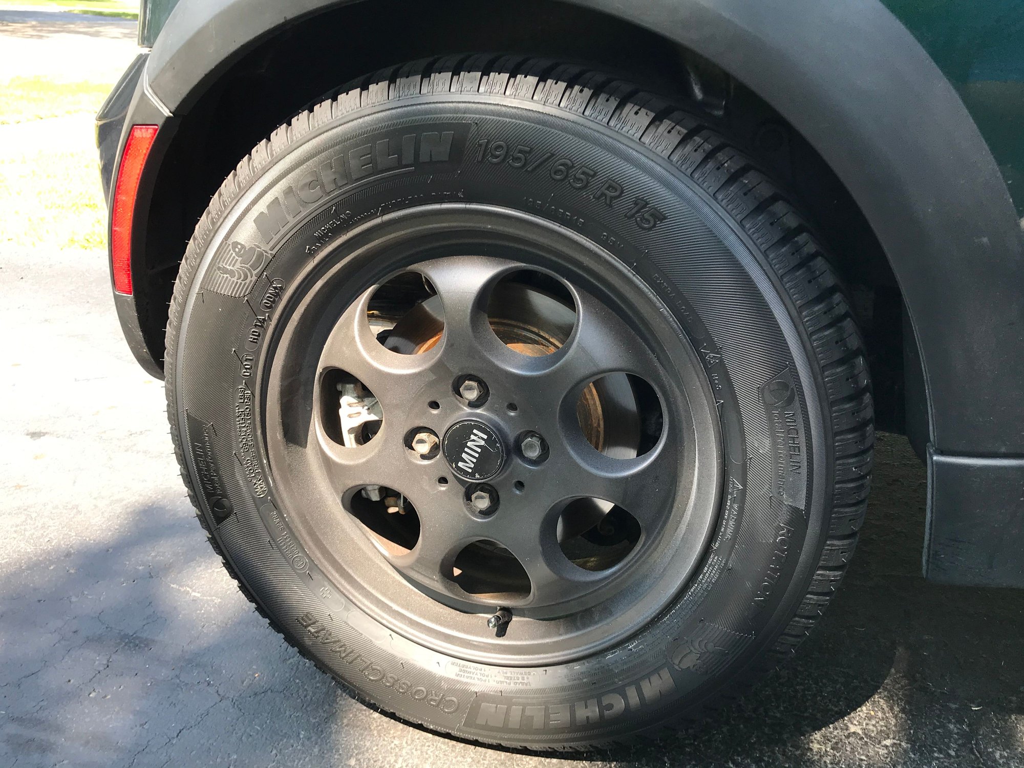

Lots of sidewall! Definitely a cushier ride than the 17s.

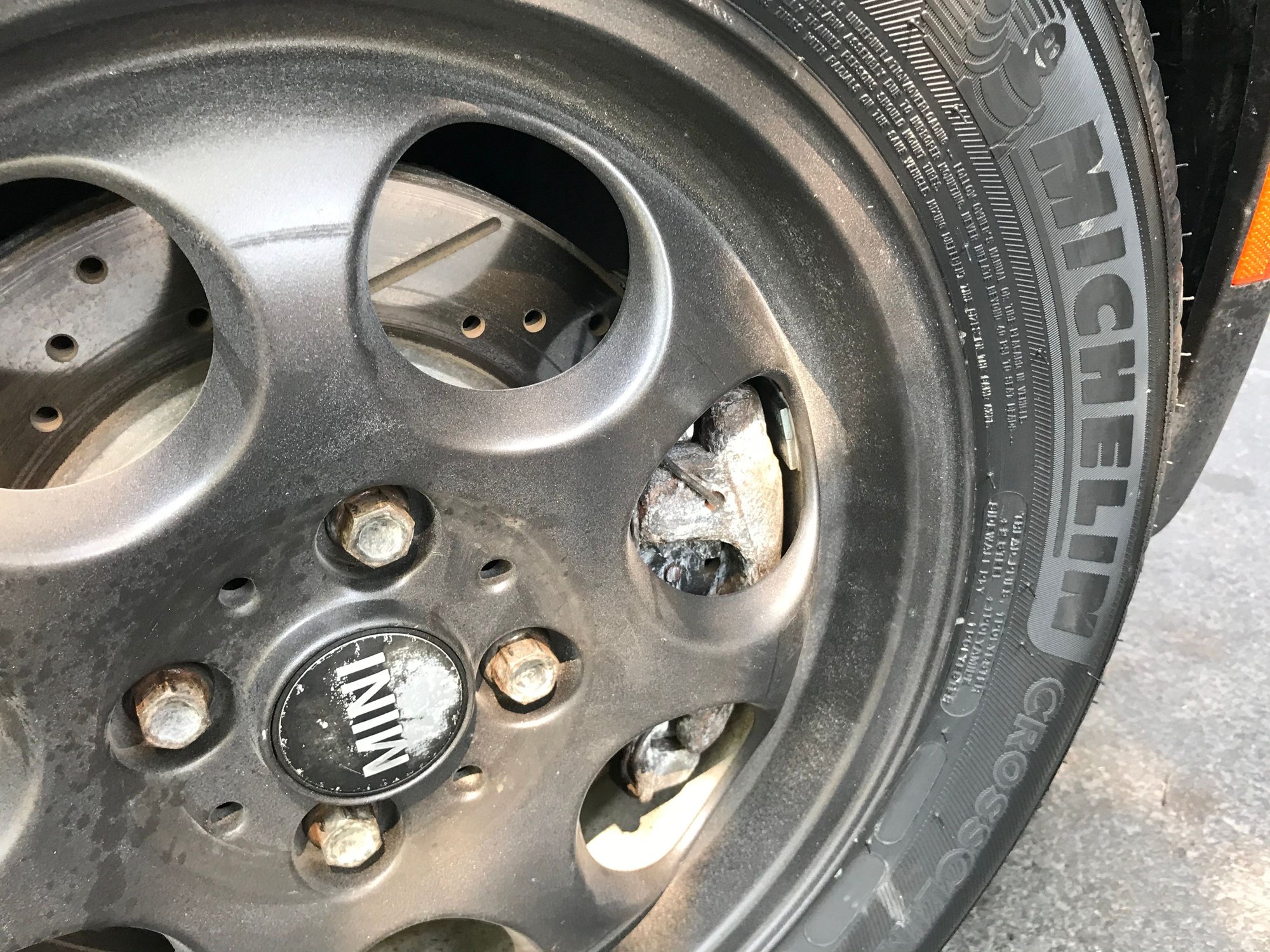

So little brake clearance! With the wheel weights there are just a few mm of clearance from the caliper!

Hey, thanks! I wet sanded them once and that helped knock down some hazing from the matte clear. Might still go over them with gunmetal from that same line of rust oleum paints, but the oiled bronze is growing on me!

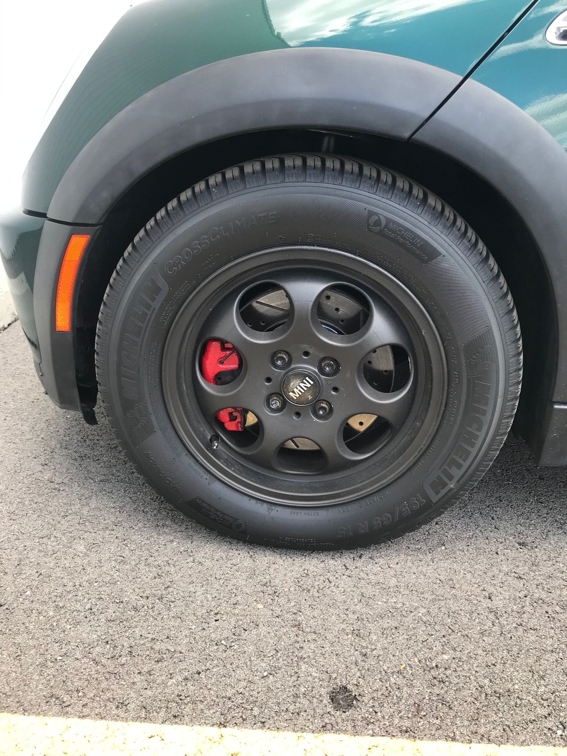

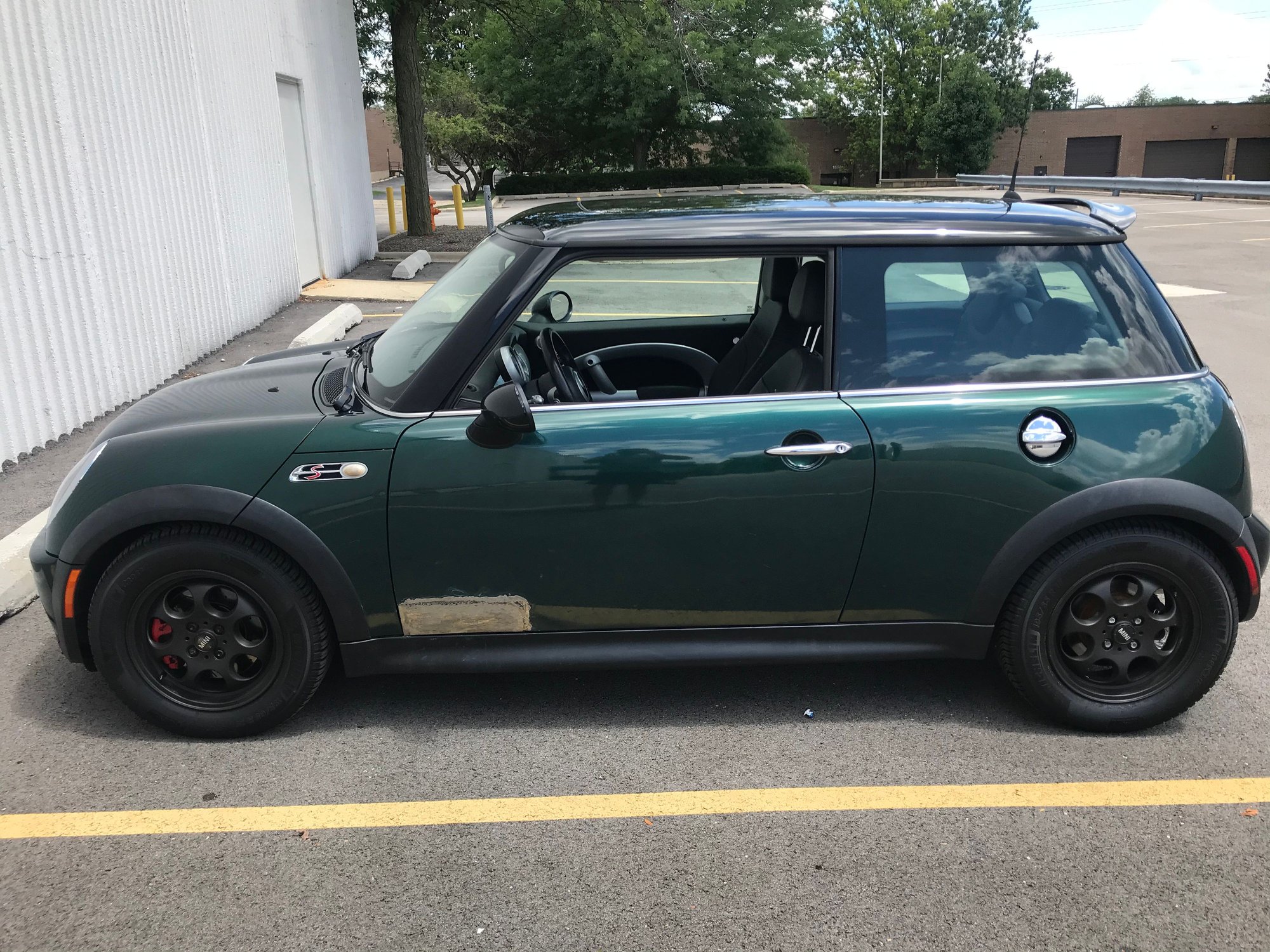

Painted calipers and blacked out the hubs. Planning to repaint the wheels in a gunmetal color- these are just a little dark form my liking.

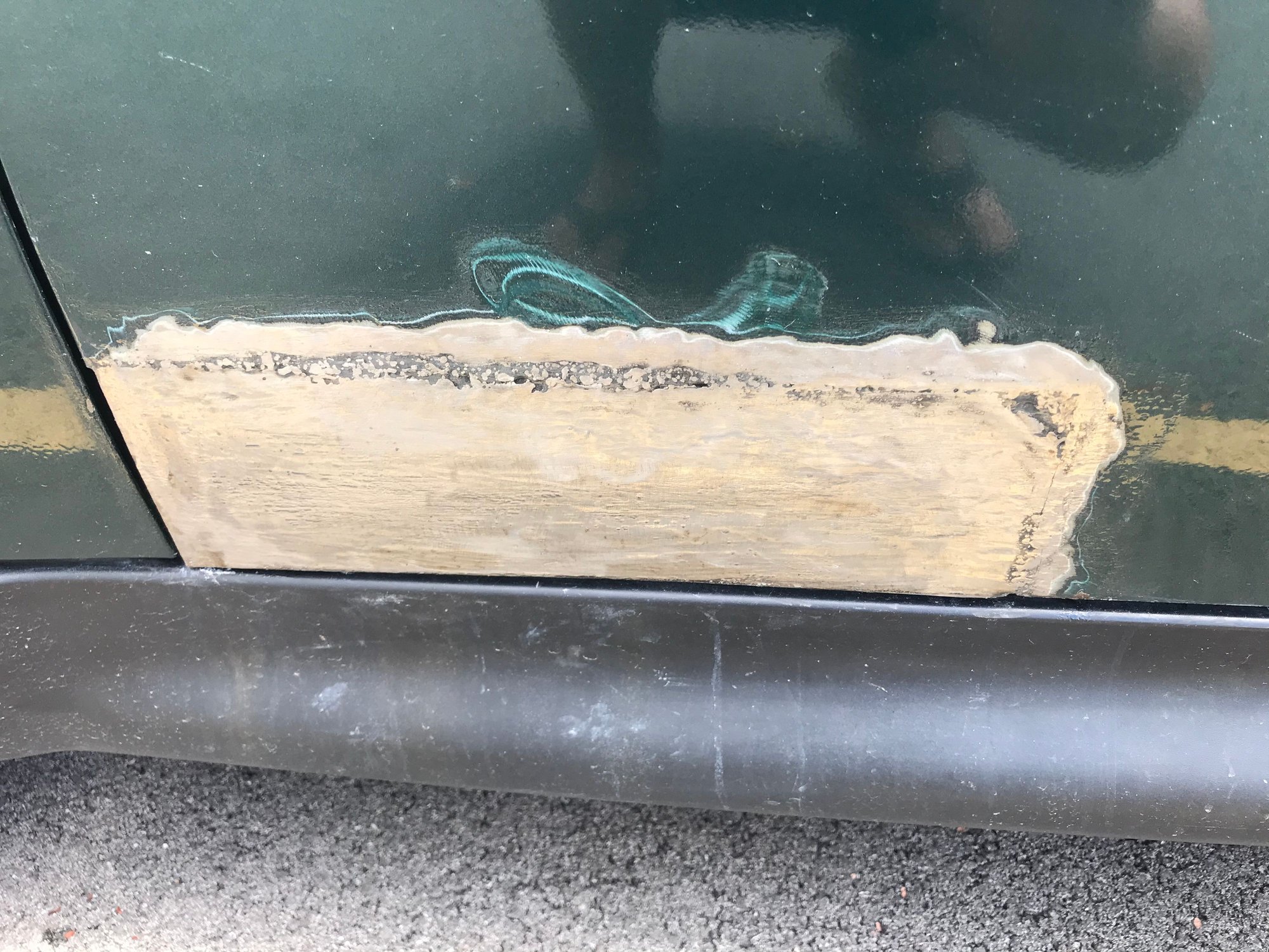

Finished patching the door- welding didn’t go to well. I had a flux core welder and it is not ideal for this. Lots of burn through and grinding.
I used some clear epoxy to fill a couple holes, then epoxy coated the raw steel. Inside of the door got epoxy and por 15. Will probably do the same treatment to the rear taillights. Eventually I may get a replacement door- there are several on car-part.com for around $100. Tails are a little more complicated so I hope I can weld them well enough to make them look a little nicer than my work on the door.
Like I said before, I’m not picky about the factory appearance, but I hate rust. Will probably just leave this as is unless I get bothered and get a new door. Need to do: -oil filter housing seal to block - change out my crank damper

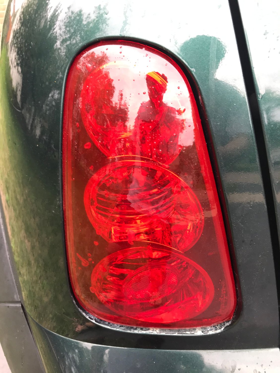

Preparing the taillight. Gonna start chopping soon. Getting windows tinted tomorrow- not sure if I’m going 35% or 20% all around. Also ordered some lamin x film in red and orange. Red will get used over the taillights. Orange will go for signals in the bumper as well as the markers in the side cowl. Haven’t decided yet if I want the reverse light to be red or orange. I love lamin x- stuff is so durable that several times I have peeled off one car and transferred to another

Also, don’t want to speak too soon on the tires but have gotten no rubbing on fender flares. Not a lot of room for snow under there, but it looks like 195- 65-15 is a fit (albeit a tight one) on the Stock suspension r53. Hope that helps somebody.

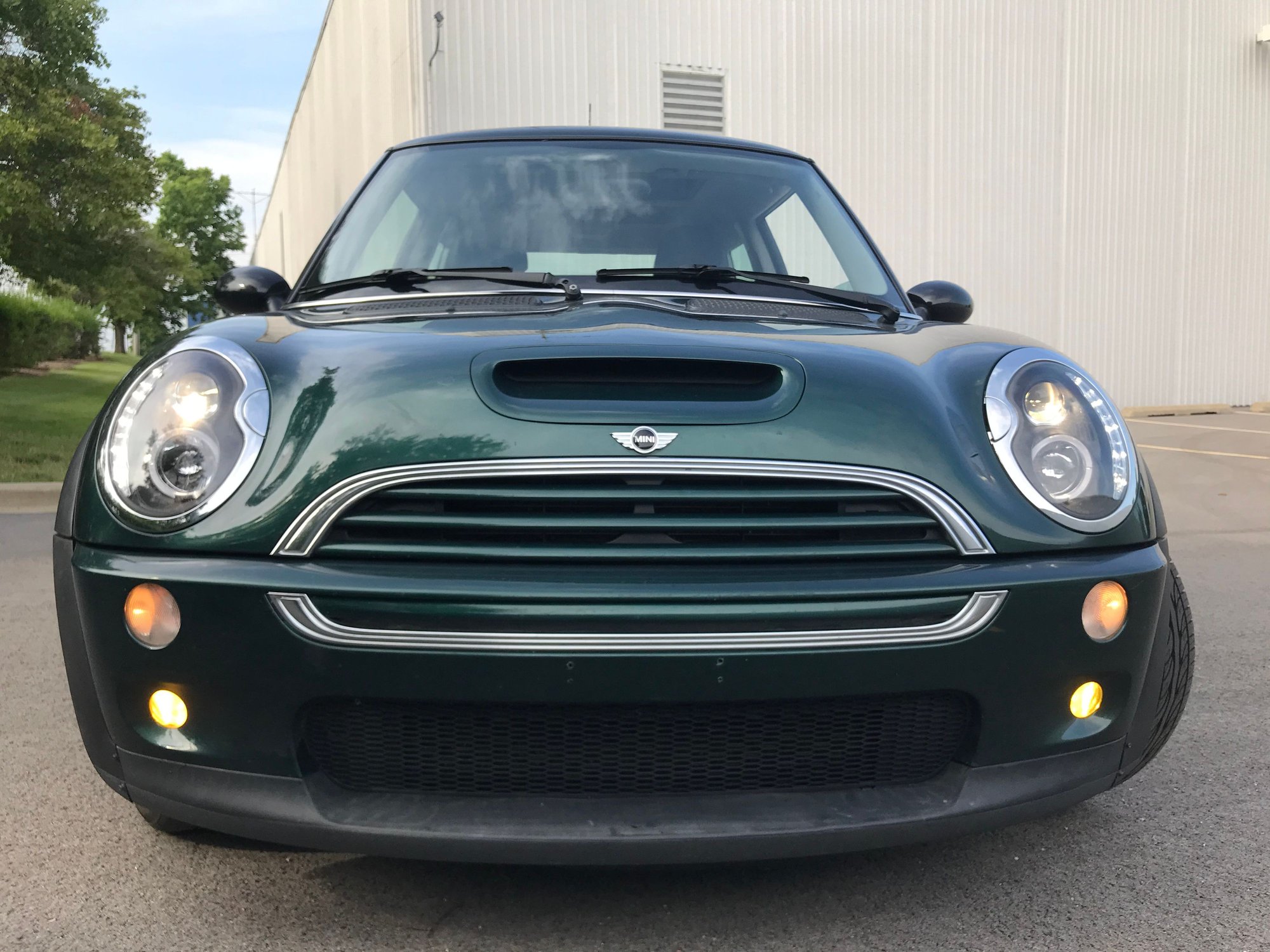

Tints of all kinds
Looks a lot better with tint! Went 20% all around and am pleased with how dark that is. Not enough to ruin nighttime visibility, but dark enough to noticeably reduce heat and give some privacy.
I’m a big fan of all orange over turn signals. Not sure if it’s legal, but I don’t think it’ll attract too much attention.
Side markers are passable, but not great. Few wrinkles because of the shape of the bulb cover. I broke one off and had to super glue it back on.
Went orange for the reverse light. Again, is it legal? Not sure, but it works for me. Red tint should be here soon- not a huge fan of these taillights, hopefully the red will clean it up!

Wheels and a few details
Painted the wheels with rust oleum dark metal primer and paint spray. Then high gloss clear.
Tint just dry enough to roll windows down. Few bubbles on driver side and not perfect around the dot matrix, but it was cheap!
Put about 2 lbs more air in tires all around. Fronts now about 34Psi rears 36. Feels less squishy- hopefully not overinflated. I tried to get an alignment but my tie rods were rusted on and they wanted $700 to change them. I said no thank you. My right front is a little out of alignment, but it’s not very noticable. I will Post the picture of the alignment sheet. Curious if you guys think it would wear tires significantly.

Depends, but overall that is to be expected yes. Also a bad alignment (front) can amplify torque steer behaviour. It's always best to get it aligned properly off course.

Maybe I missed this, but why did you decide to go with 195/65 R15 instead of 195/60 R15?

these wheels are so much lighter when you take them off the car! I am really surprised you can’t tell more in acceleration. In the long term it will probably help mpg but not too noticable in power or acceleration exactly, more noticable in low speed turning- lightens up the steering wheel a lot.
i will get all the rust. I may have mentioned this, but as i have been repainting/ needle gunning, naval jellying everything I touch and see with rust, so the condition of things is improving, but I suspect I’m not improving the resale value of the car with my home brew welded door panels and tail lights
i am debating between doing a refresh on the 17in Summer wheels with the same paints (mix of oiled bronze and dark steel with some high gloss clear. After I redo them, I will probably just sell them. You think someone would buy them for $400? The tires are about 85% and they have certificates of replacement from discount tire to go with.
Thanks!
I was considering the 195/60 size but ultimately, this tire fit the bill (or claims to) for exactly what I wanted:
-a year round, snow capable performance touring type tire.
nothing in 195/60 seemed to do that at exactly this price point. I looked at the Cooper cs5 ultra touring in 195/60. I think it would have been $75 more, but they didn’t claim to be as good in the snow, although probably a stiffer sidewall than these. These have a 50k tread warranty, I think the coopers were like 70k? Those would have been my next choice.
overall, the snow/ year round performance marketing and the additional height (.5 in or so taller?) size of the Michelin make for a little more squish/ suspension. I live near some railroad tracks and drive over them multiple times a day, so every bit helps. That, in combination with the price and local availability sold me. Mount and balanced I think it was $403?

Cant recall if I posted this, but covered these in lamin x. I could’ve done better, still some very visible bubbles of air. Was also starting to rain, so may look worse than it is in reality.
You can see my naval jelly rustproof we turning the rust in the taillight seam white. It does this and sort of turns the rust to a powdery white dust. Makes it easier to Prep for paint. I this case probably not necessary, but I am in the habit of just hitting anything I see with rust until it’s gone.
Not a big fan of these taillights. The red looks a lot better, but harder to install without bubbles on the larger lens than say a turn signal or fog light.
