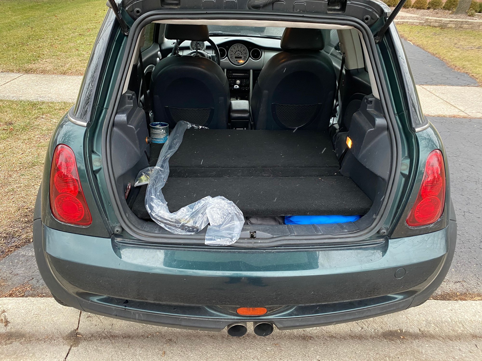

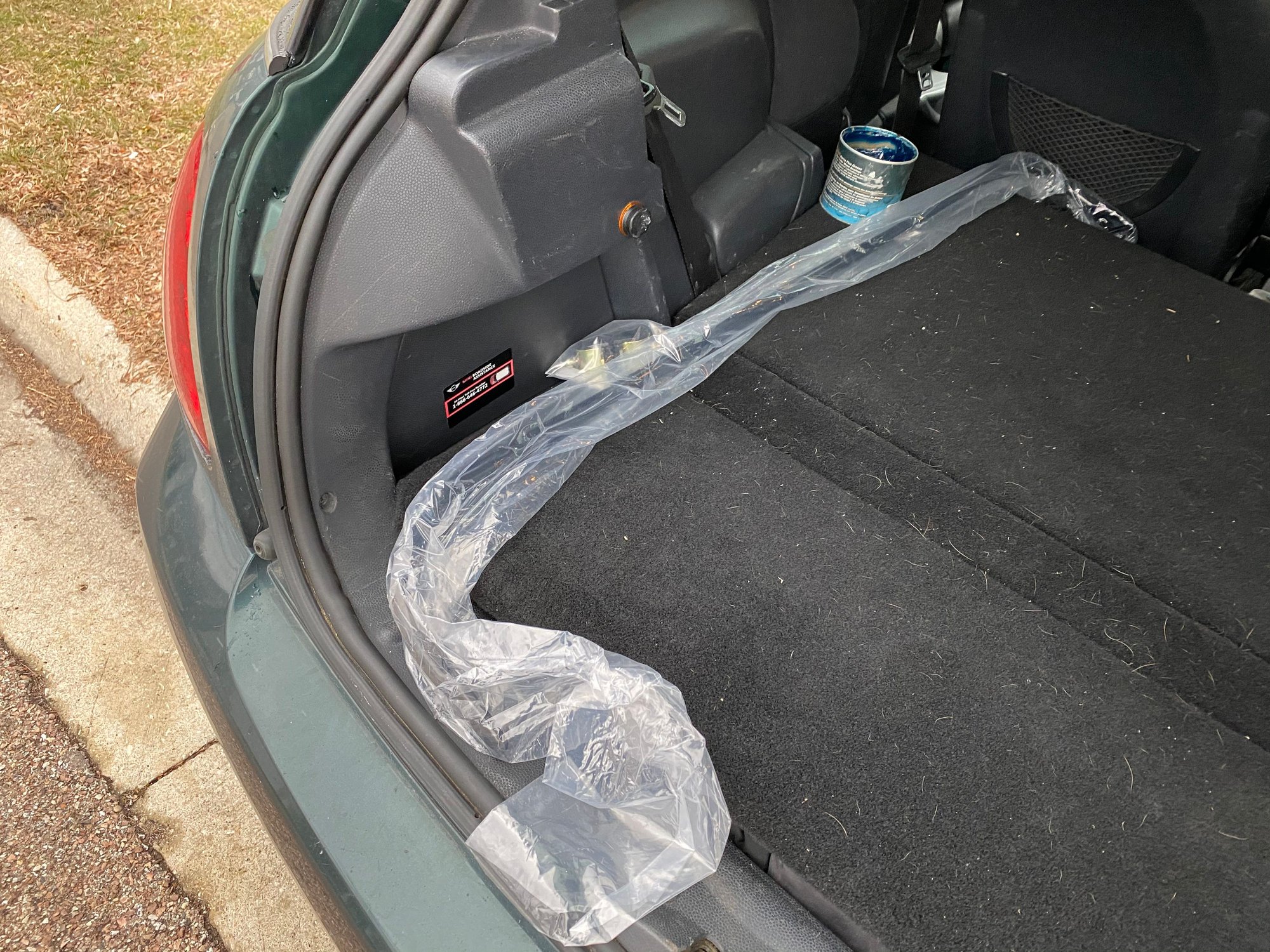

Got the parcel shelf and the oem shift **** from a member here. Parcel shelf isn’t really installed in this picture, just sitting loosely, but it will fit great and matches really well. Will probably do a blue sea high speed usb/ voltmeter in the left blank. Already have a left over one from my Tacoma, just need to find it now...

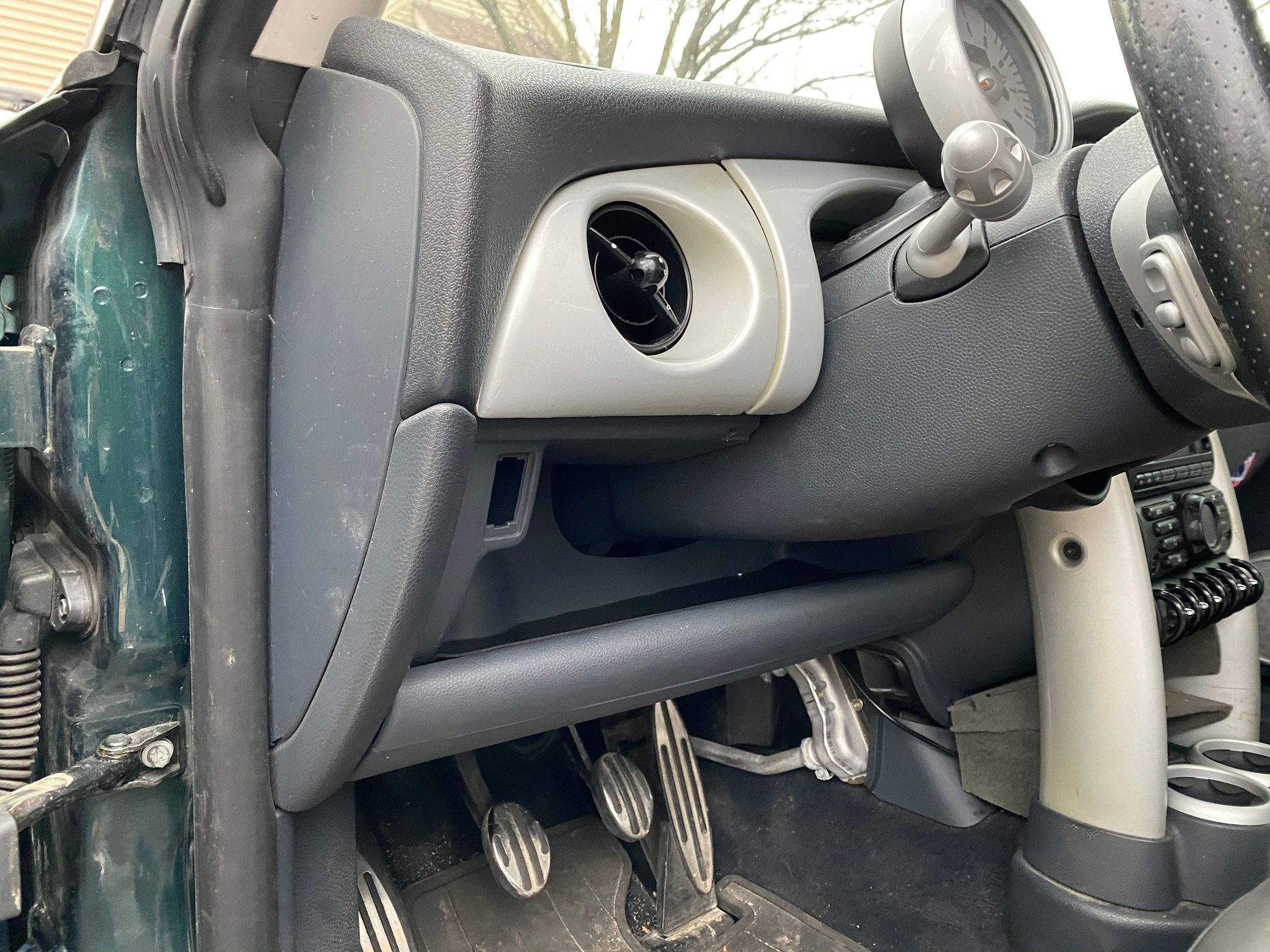

I ordered the heater matrix cover panel from mini seattle. Should clean up the look and keep me from burning my ankles when I have my flip flops on (yeah, it happened. That thing gets hot!).

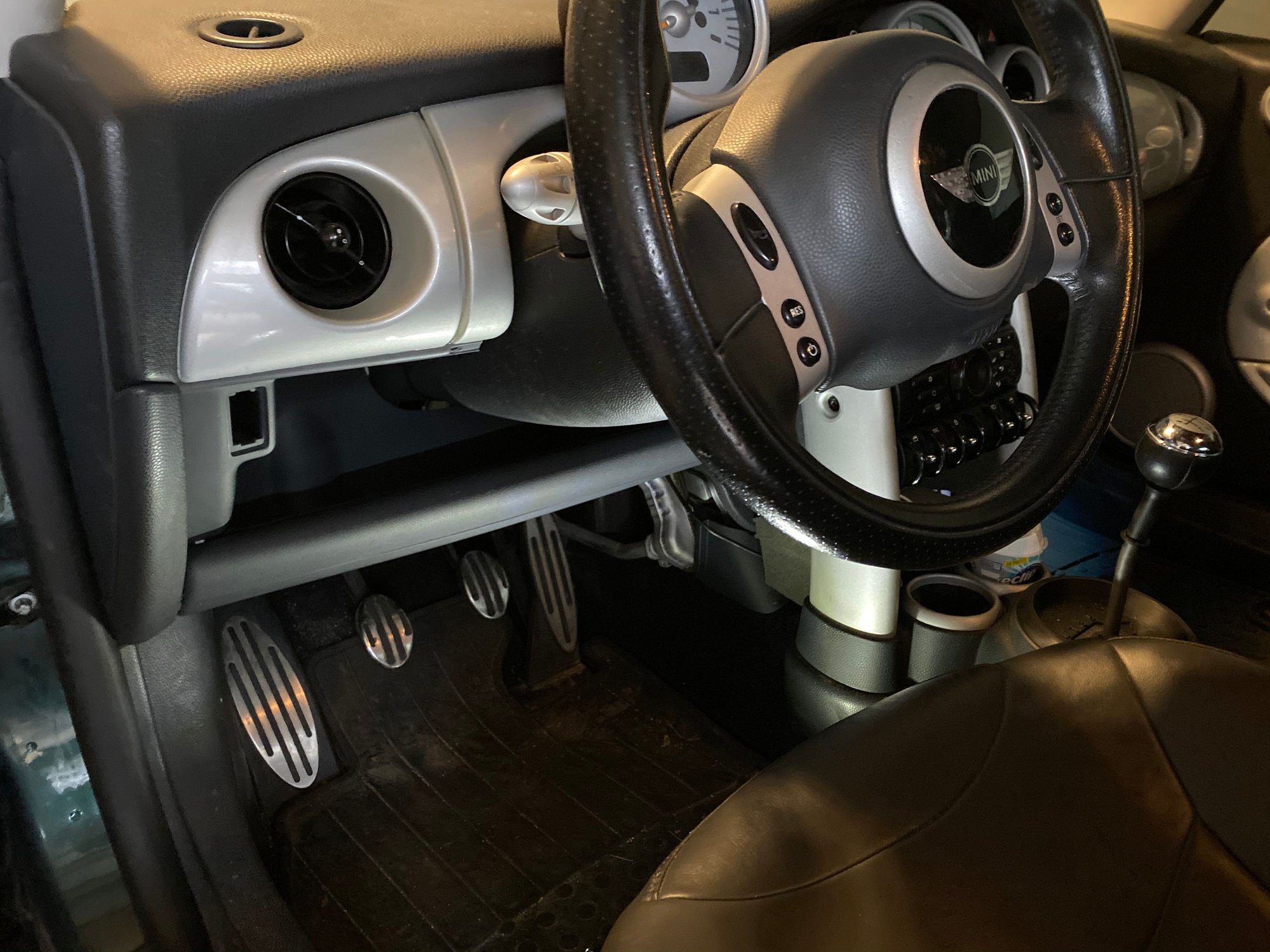

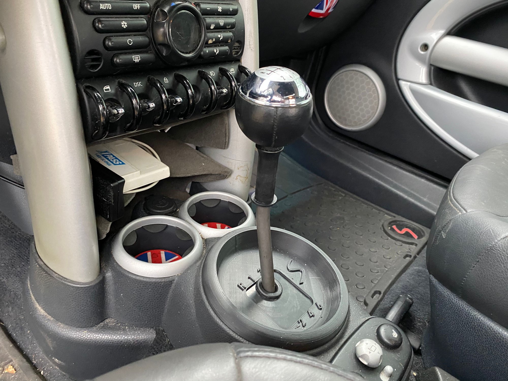

Black flag USA shift boot delete. They were great- first one was broken in shipment and they sent me out a new one right away. As for the product- I’m not wild about the fact that you have to now take the whole lower dash and tubes out to get at the shifter box. The 4 screws that hold it in attach from the bottom, unlike the stock one with the 4 pegs you can pull up on.

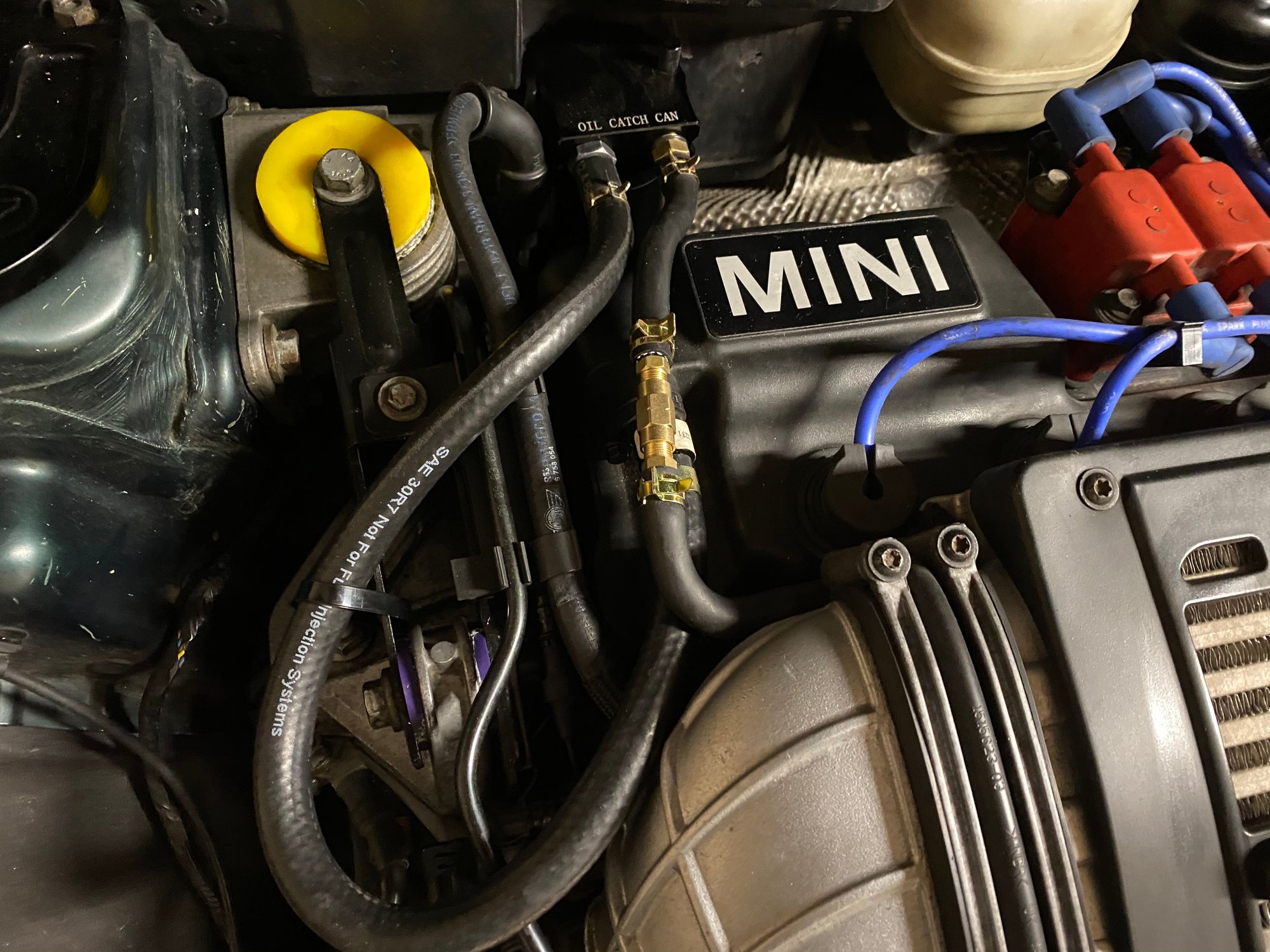

Catch can

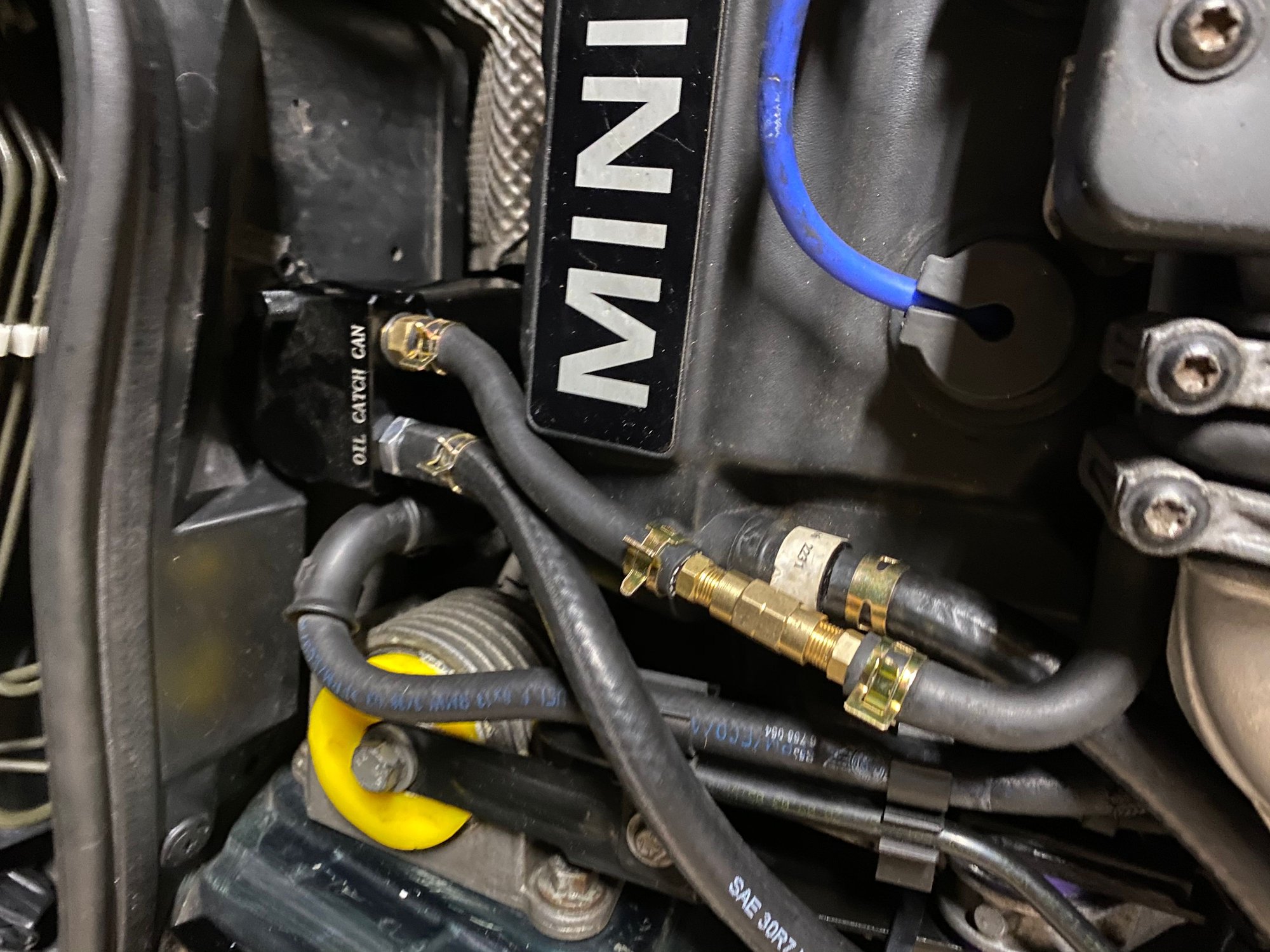

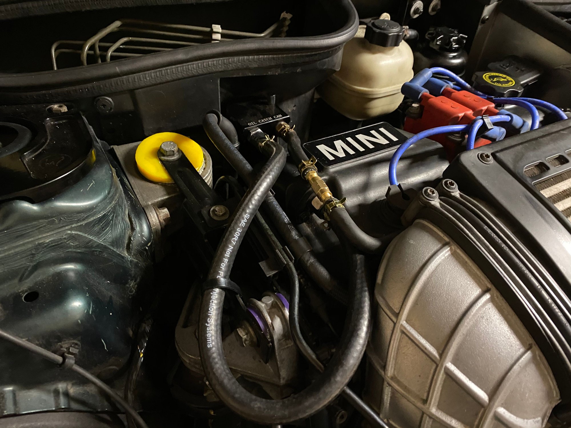

Got my catch can finished, mostly. I need a couple spring clamps that fit the larger hose. Not super pleased with the way the hoses are sitting, but it works.
Notice the zip tie to the motor mount- not super happy with that.
Left fitting on the can is larger because hose needed to for pcv. Spring clamp on left fitting doesn’t fit over it, so I’ll grab another later.

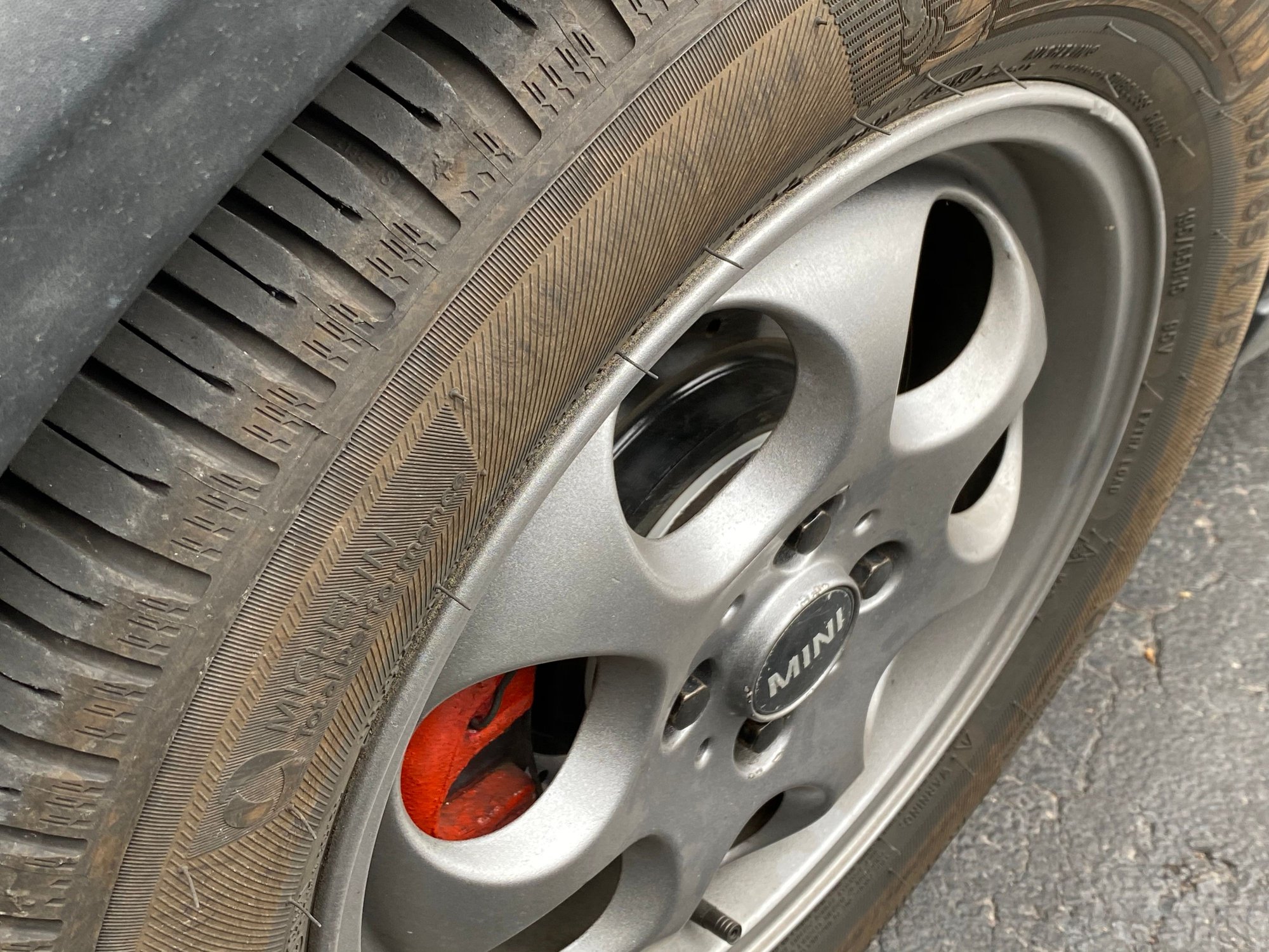

My mom bought me some 5mm spacers off my Christmas list- I threw them on yesterday ( see the silver in between the hub and wheel?)
I don’t have a perfect before and after, but it is just barely noticable visually. Could be my imagination, but steering felt a little lighter too somehow- maybe my butt Dyno is off

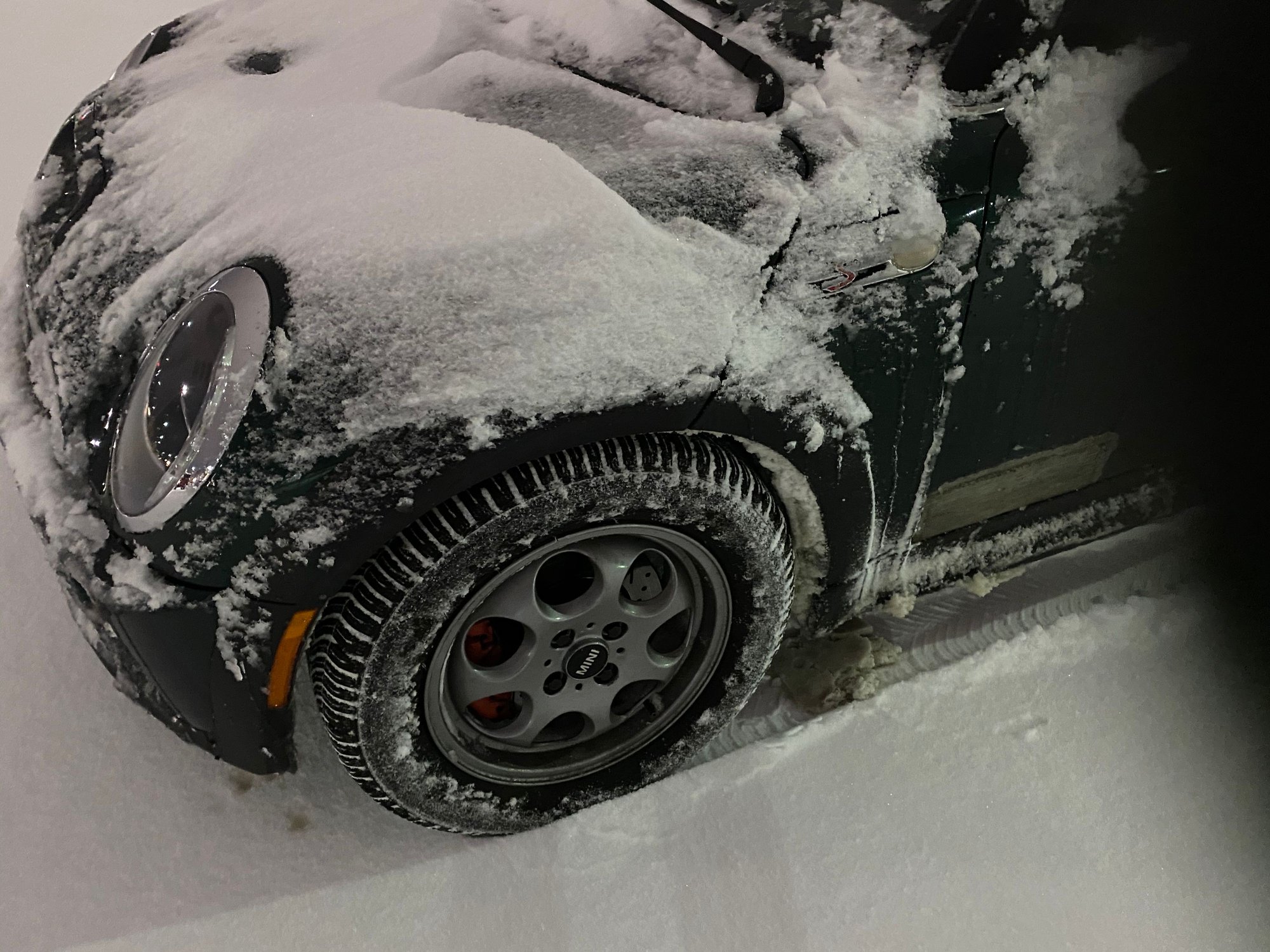

Snow
Did great in the snow and ice! Really made me want to get the limited slip diff though. You sure can feel the torque steer bad when the wheels spin. Overall, it’s maybe the best fwd car I have driven in the snow.
glad I have the skid plate installed. Also glad I did the fluid film/ woolwax underneath. Will wash and spray fluid film again- crazy amounts of salt on the road today.
As anticipated- not a lot of room for snow buildup under the wheel wells.
Love these wheels.

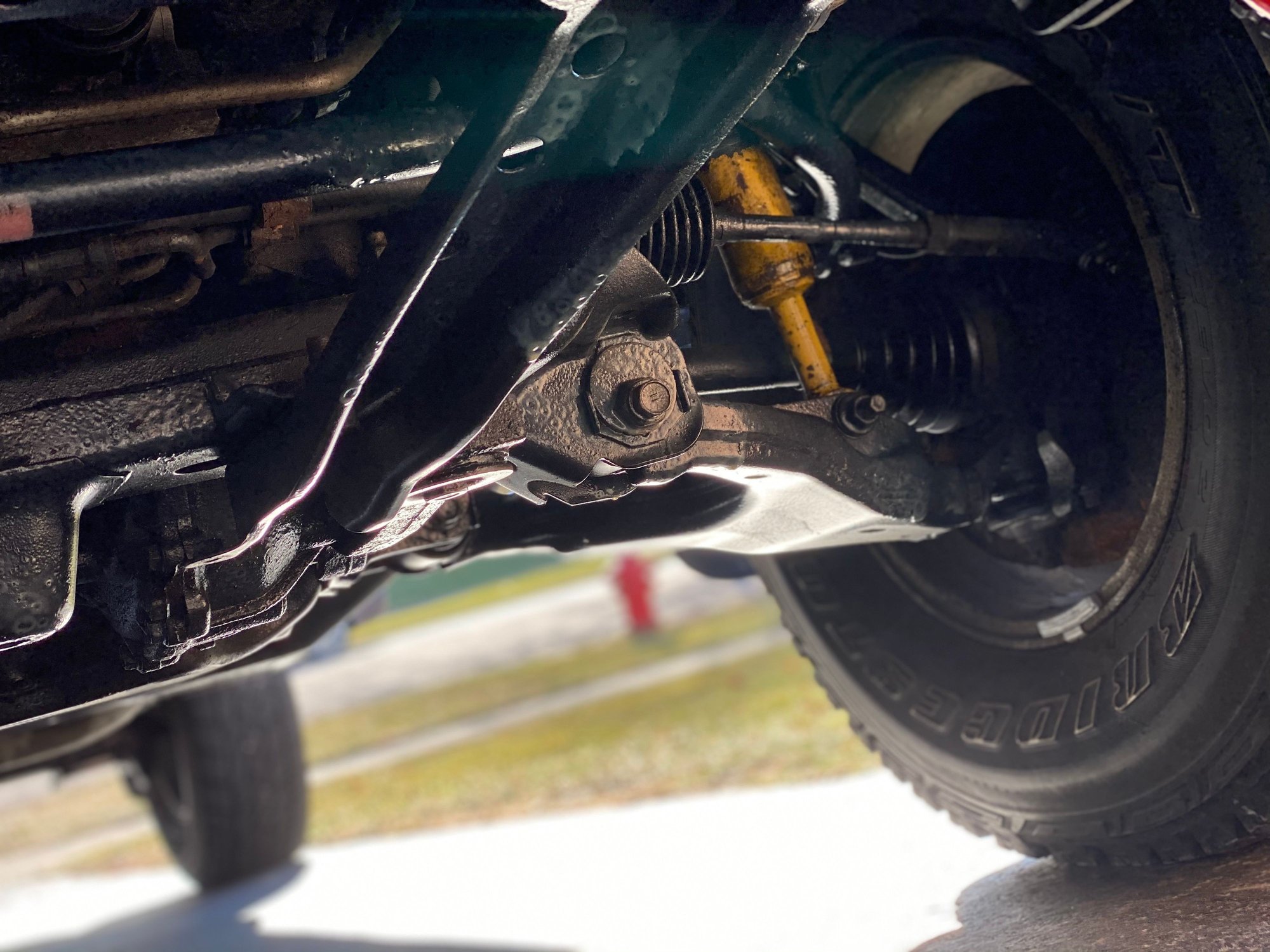

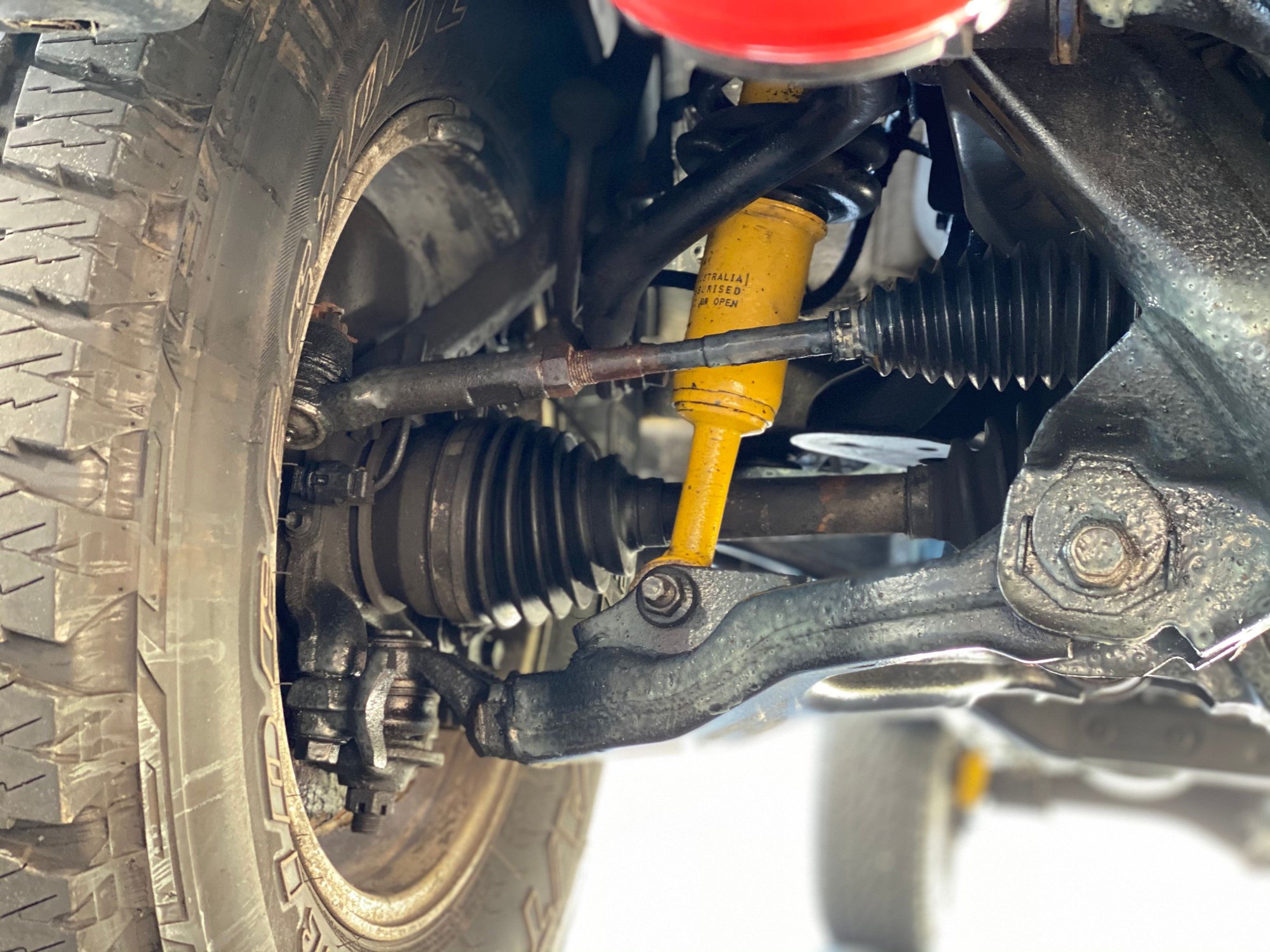

You can see the impact of fluid film- those shocks have been through 3 IL winters.
If you know what the underside of a Midwestern Toyota Tacoma or 4runner usually looks like, this is an indicator of fluid films effectiveness.
