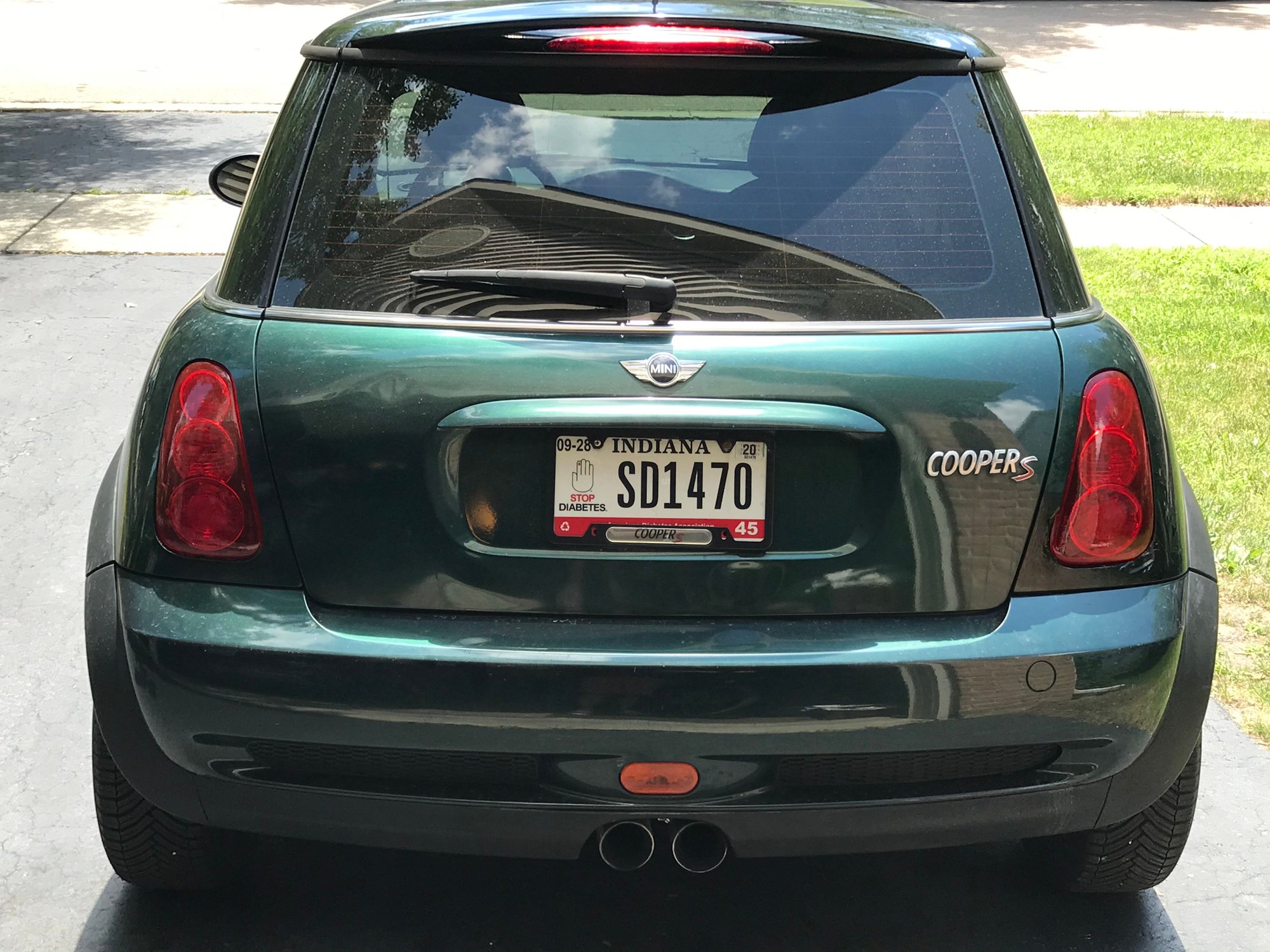

This light went better. I was much more patient doing the tint film and I did it in direct sunlight on 90 deg day. Very few bubbles.
That still doesn’t blend, but I’m into it.
On a sunny day my black rust oleum painters tape right taillight housing really blends with the brg
Got tired of looking a blue painters tape and mismatched tail lights. Used grinder to cleanup surface rust, put 2 layers of rust oleum, one layer of painters tape, then one more layer black rust oleum over the tape. Have done this before- is pretty damn waterproof. This way I can go through the car wash, not have it be a total eyesore. I don’t plan on welding/ grinding on the tails for a while. Want to finish all my mechanical projects before school starts in a few weeks.

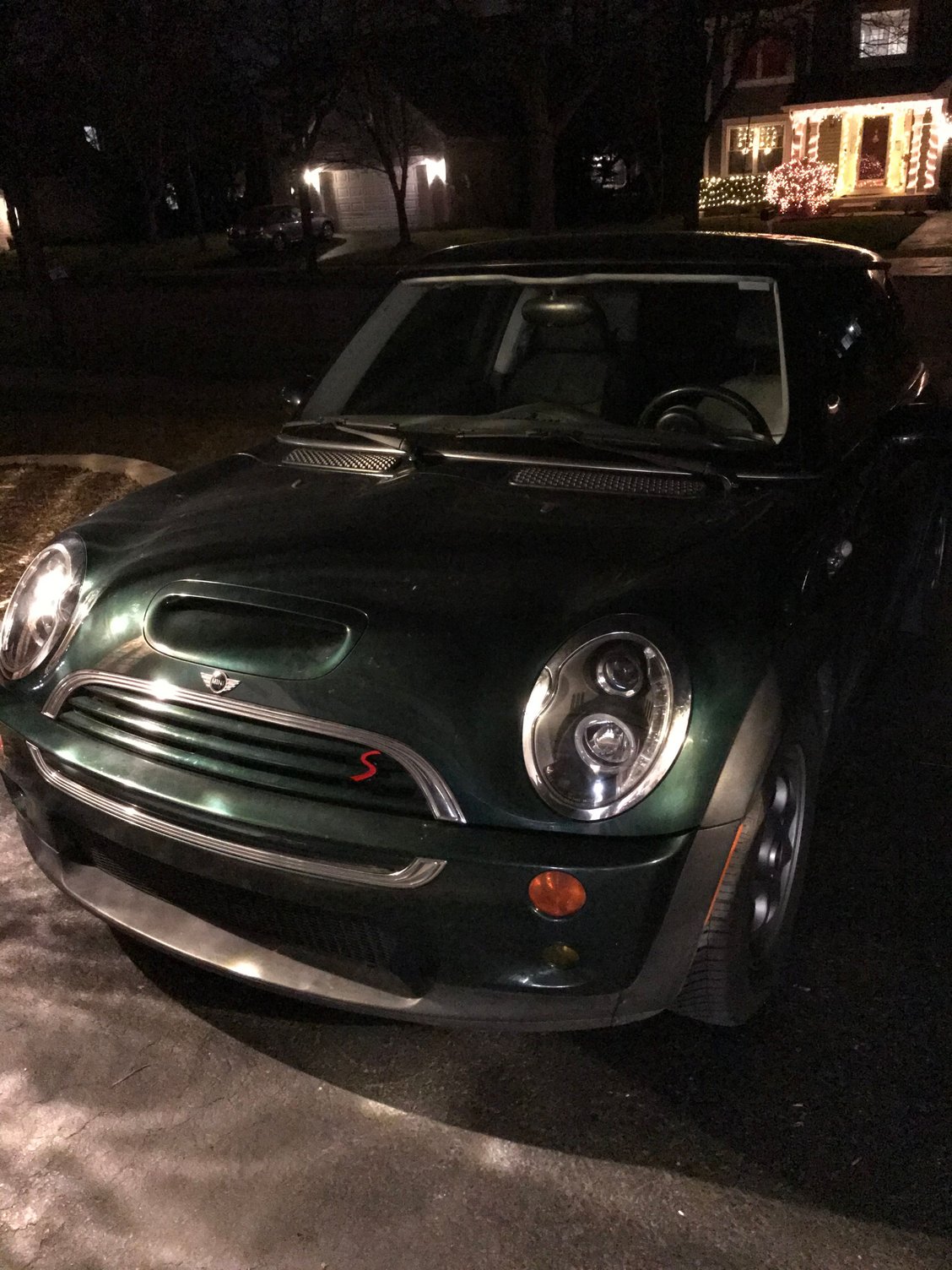

Added the little red S! Have had the WMW quicktune for about a week. It really smooths things out. Way recommended against getting a DT bypass valve and I can see why- seems unnecessary now that the tune has been in. Not sure I can really notice any more torque or hp gain, but it is smoother all the way through the rev range, and maybe even a little smoother at idle. The little idle stumble that happens and then corrects itself after sitting idling for a couple minutes is still present but bette
