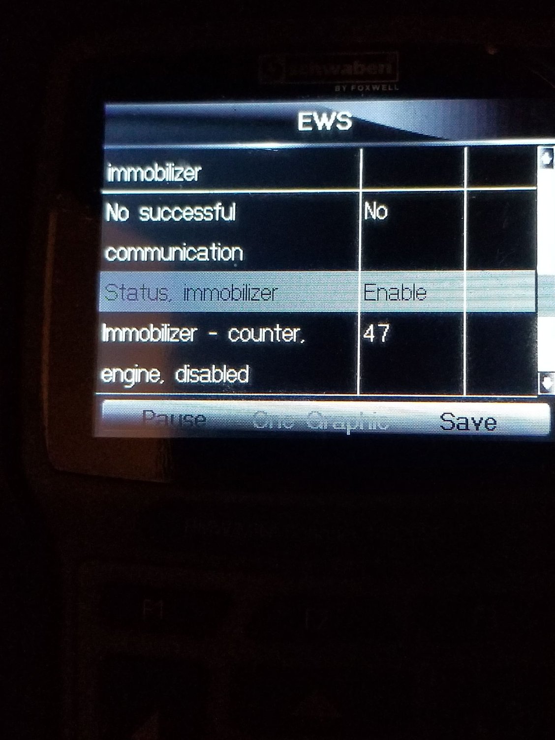

Hey guys, need some help on this on. I've put Scarlet away for the winter. I put a trickle charger but some how it got unplugged, battery was of course dead. She was running before I put her in the garage. Charged the battery, turned the key and did not hear the fuel pump engage. Put her on the Schwaben scanner, everything was clear except for the following: Starter disabled due to p/n . She does crank, but no start. The scanner also reads: Starter Enabled:NO I'm figuring it has something to do the Battery being dead and the system needing to be reset? Any thoughts?

Okay, when I step on the clutch the "Starter disabled due to P/N" message disappears . What I do get is message stating the Immoblizer is enabled
Does anyone know how reset the Immobilizer?

When I run INPA and synchronize the Immobilizer Seed, it says that it was successful, yet when I go back to my Schwaben scanner. it still states the engine is disabled....There does not seem to have e an option in INPA for me to register the battery. I'm going to see if I can get another version of INPA. This seems like a whole lot of work for a dead battery. She was running when I put up for the winter

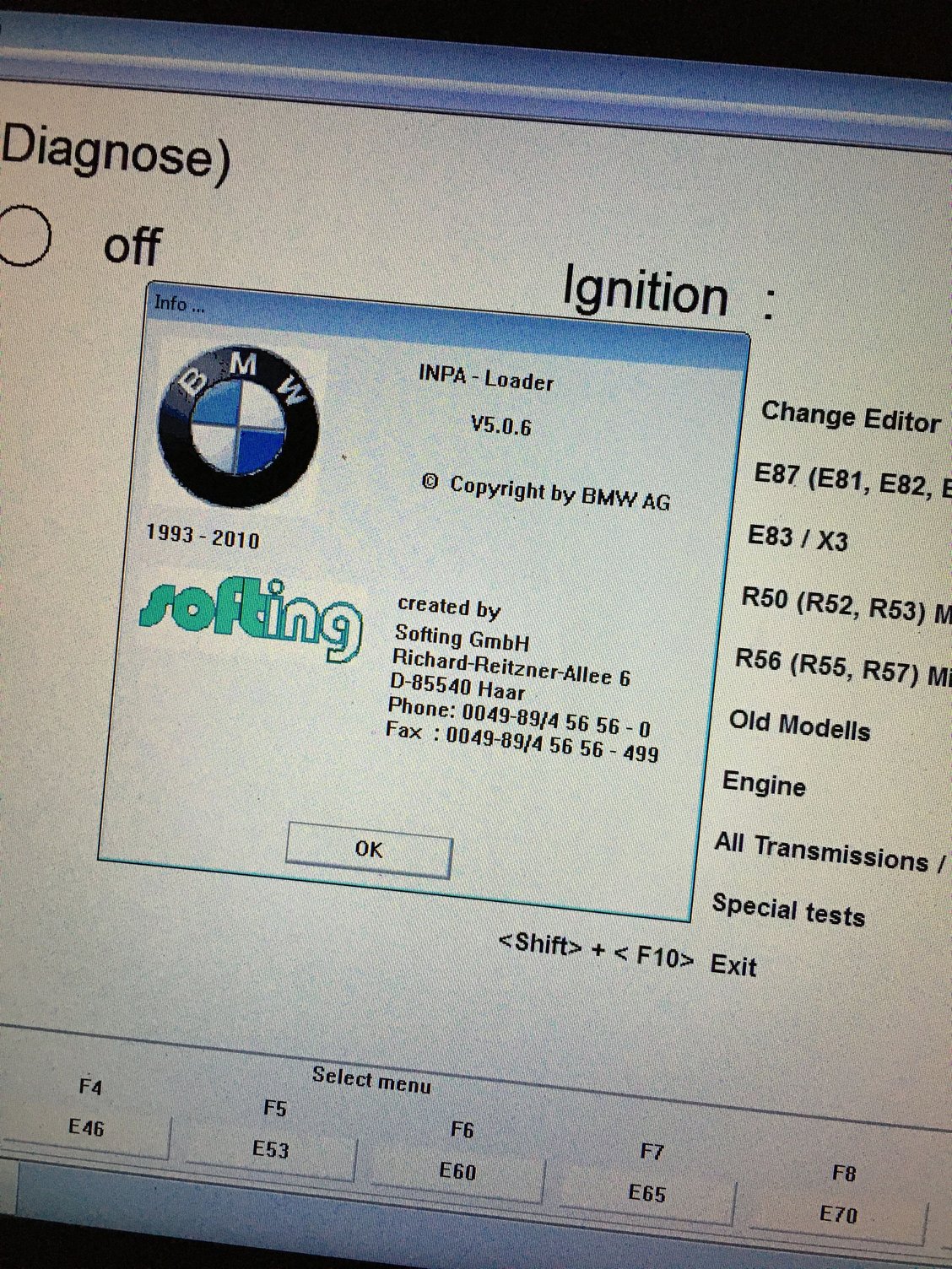

looks like 5.0.6 when I go to “about” on the top left of home screen. When I go to “information” it says 5.00. Pics attached. Sounds like we are on the same version?

Don't need another INPA version,it doesn't help you, maybe your DME died.It happens sometimes.The solution is to buy a DME with immo of and same sw inside, or to buy a complet start kit , mean keyfob, immo, EWS, BC, from an identical car.
