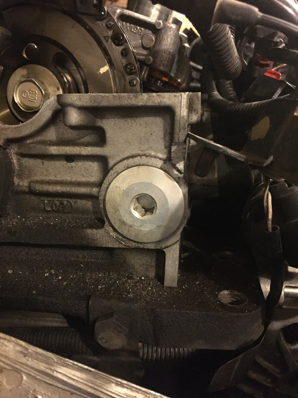

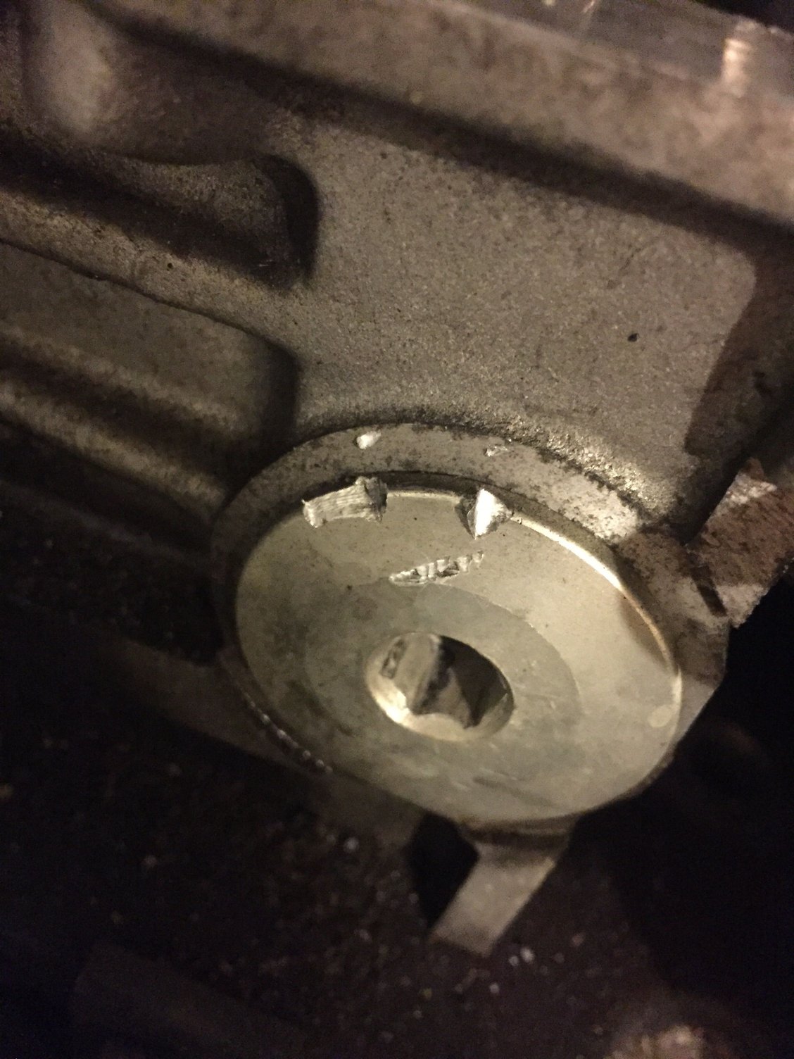

My Allen wrench plus a little heat and a hammer only made the Allen wrench dig into the oil plugs a little.
Anyine with advice on getting these plugs out? I’ve alreadt stripped the head off a pinch bolt and had to drill it out. Please advise.
Tried to use a chissle....
I’ll try to have a helper on an alen wrench while I tap

Can you get a manual or electric impact wrench on it? Definitely soak it with PB blaster, and heat is of course your friend, but it kind of looks like an aluminum plug in a steel/iron casting so you might be dealing with some galvanic corrosion.

I also agree heat is ur friend, but make sure u r heating the correct part. Dont want to expand the plug, just the outlining case. Just start the car and let her run a few minutes. Also, make sure u r using the correct allen size...some are very close metric vs standard. Lastly, I would buy ( unless this is what u r using) a 3/8 drive allen socket. Way better leverage.
I do love PB Blaster too. Havent found anything better over the years, apply liberally, even soak overnight. Really does work.

That looks like a torx bolt to me. A hex wrench will just slip.

Damn it. I think you’re right. I saw mod mini use what I thought was a 10mm Allen wrench. I’ll learn what it is and post a complete update with pictures on this repair. The information is out there but it is sparse. I’ll be doing the chain, cam, and crank sprocket replacement by the end of February and I’ll make a detailed modmin esque video.

That is a hex head. What size wrench were you using? For example, if you were using a 3/8 inch instead of a 10mm that would do it. They look pretty close to being the same size but aren't.

i was using a 10mm, not only did I pull the 10mm Allen from its correct position in my tool rack, I always check on the tool that it is exactly what I believe it is. So yes I used a 10mm hex, andbif you are sure that it is a 10mm I’ll assume the ppl that came before me over tightened the plugs. The ppl before me over tightened plenty, and cut corners more than once.

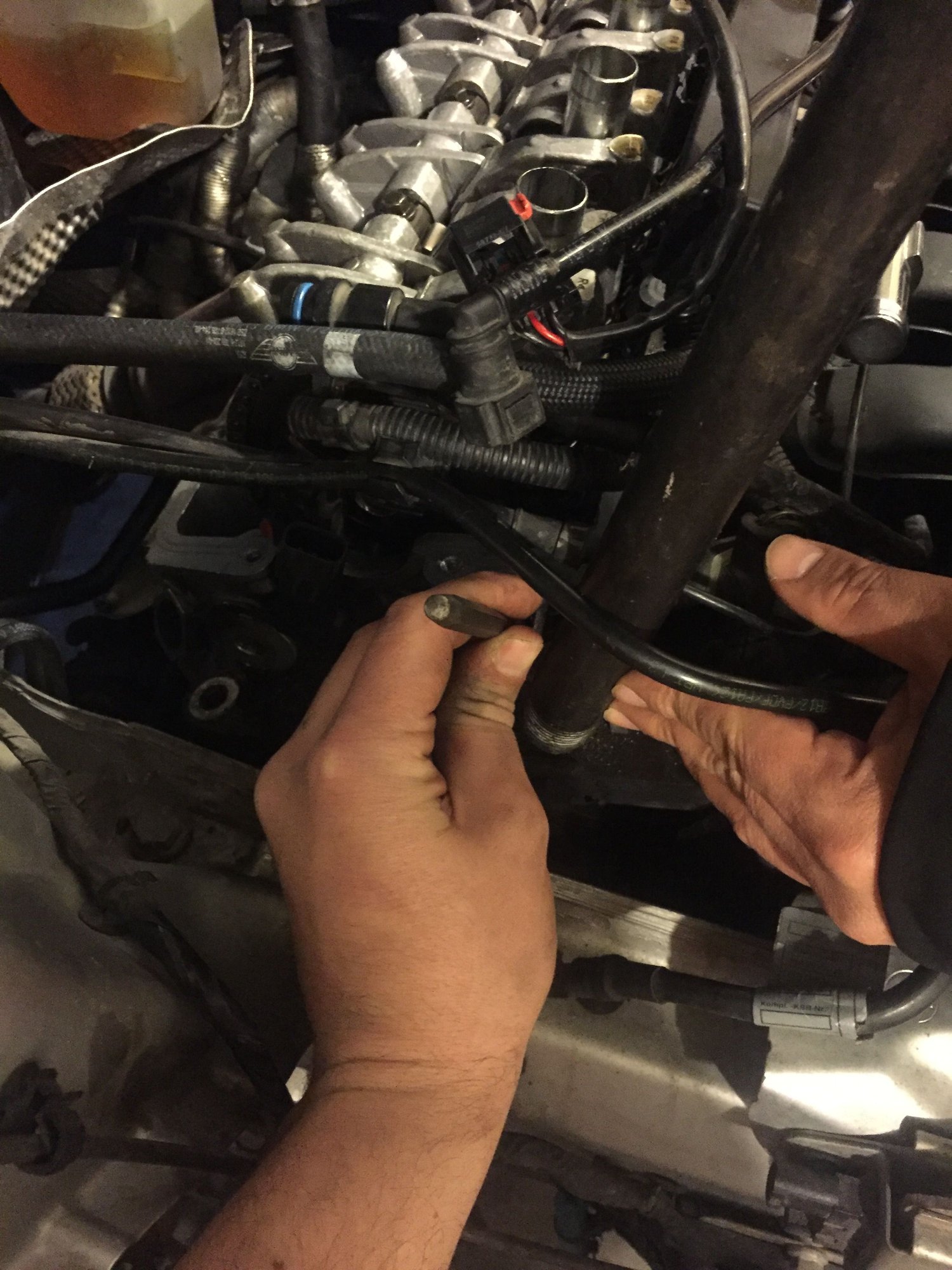

I tapped the chissle while my helper pushed.
