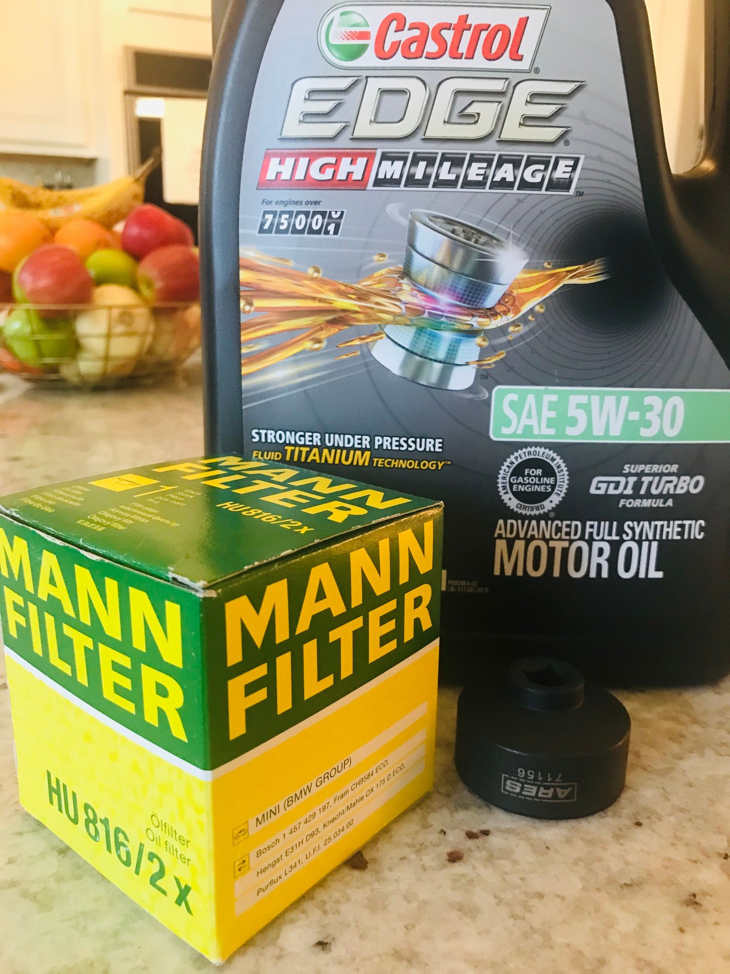

Yep, I'll do it this weekend. Just ordered the short 36mm socket, filter and 5w30 full synthetic high mileage. Seems simple enough. Previous owner installed the Fumoto valve so that is a win!
