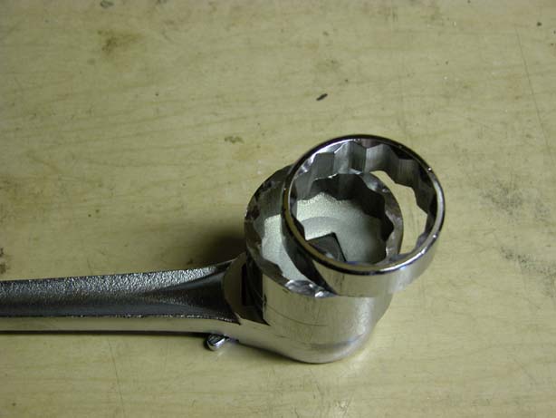

What's a recommended overall length for the 36mm socket? The home depot socket says it's 4.5" long , but an ebay auction I saw said that they were selling their 3" because it was too long?!
I'd prefer the Craftsman so that it matches the rest of my set, but there's no detail on that one and one of the howto's I ran across mentioned the Craftsman as too long. Hmm.
I 'modified' my Craftsman though now having done it, it's probably not necessary, but it does give a bit more room with a 1/2" drive.
