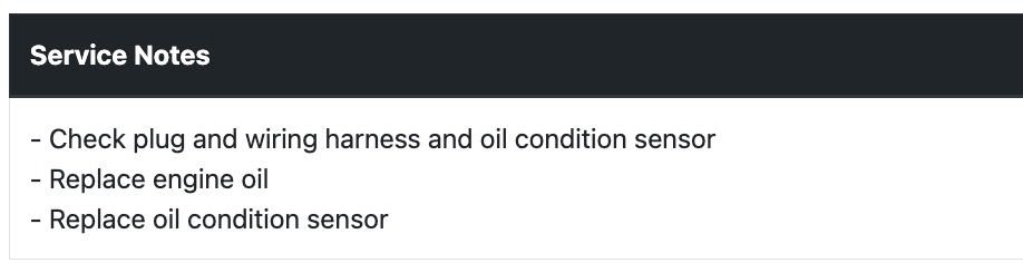

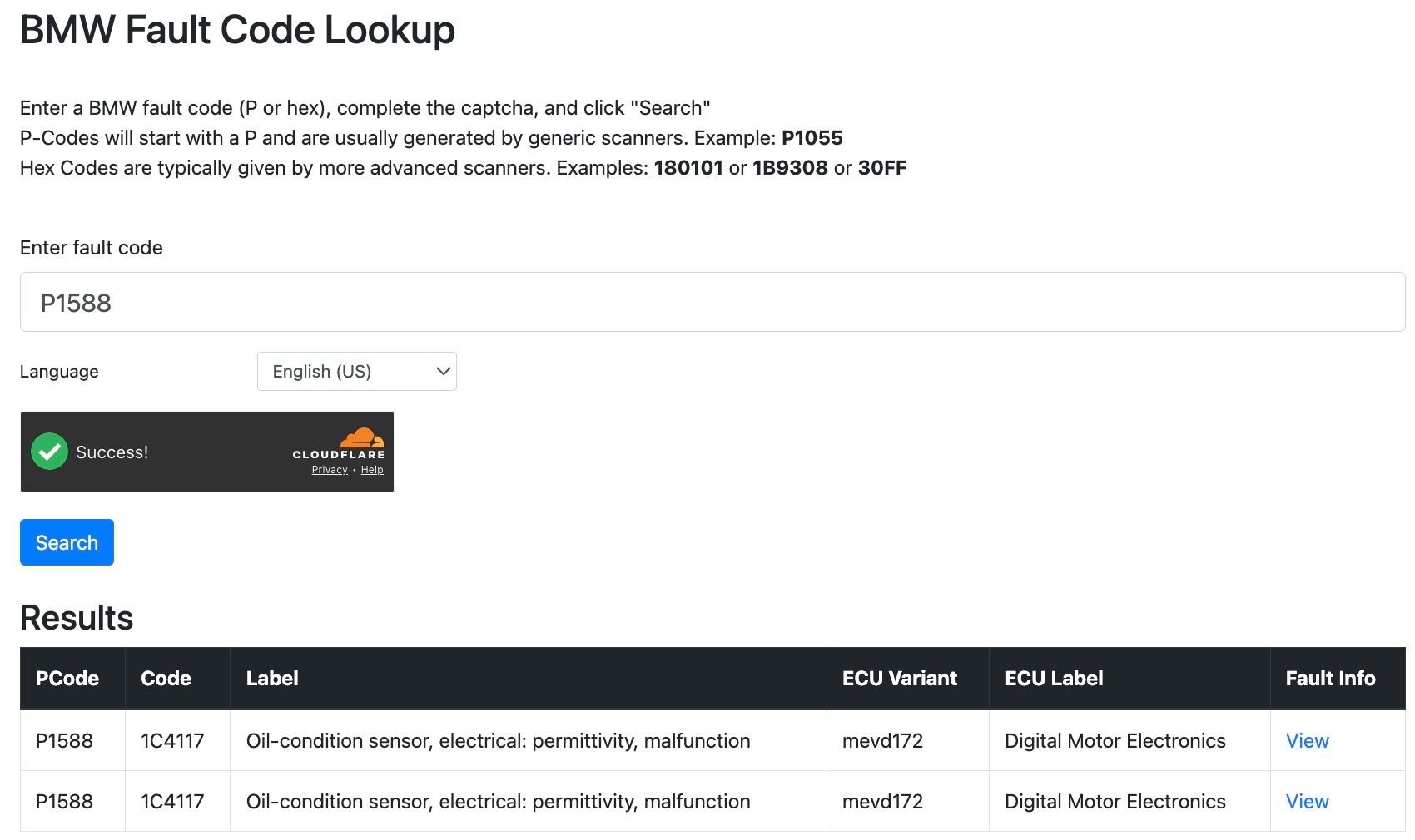

***Code P1588 shifts the diagnostic direction of your thread. The oil condition sensor, alternator, and intelligent battery sensor (IBS) all communicate with the DME on the BSD bus network. The oil condition sensor is shorting out and taking down the entire BSD bus network. This likely explains all of your car’s symptoms.

Thank you for the information. Quick couple of questions: wouldn't the oil light come on? which hasn't. Also, so this sensor is the cause of all the codes that I've gotten? What about the codes from the BMW/Mini scanner? Thanks again for the help.

Good questions. The oil pressure sensor and oil volume/condition sensor are functionally distinct sensors.
Yes, including the O2 sensor codes. The alternator is on the BSD bus network. Taking down the BSD bus prevents proper alternator charging, which in turn leads to a general under-voltage condition.
What causes these problems? The oil volume sensor in the oil pan wicks engine oil that creates a local sensor short and that can travel along the wires all the way to the DME connectors and DME. It's a well known BMW/Mini issue.
