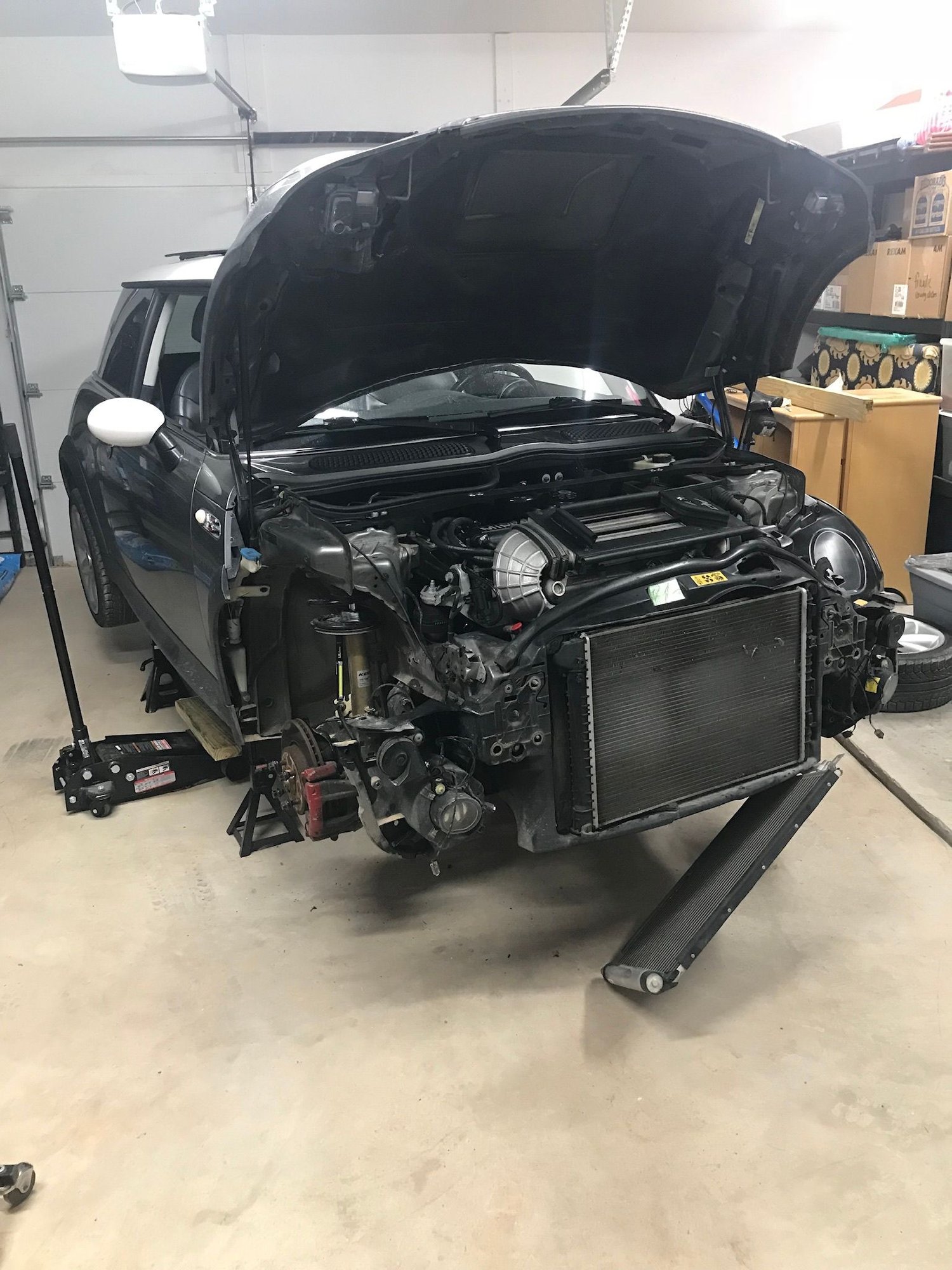

you can definitely do it in front end service mode, that’s how I did it, I just think that if you need to change the coolant, you may as well remove the radiator to give your self more room to work and you can make sure you empty the radiator.
My car mid alternator change
Mod mini removing the alternator with the compressor in place.
