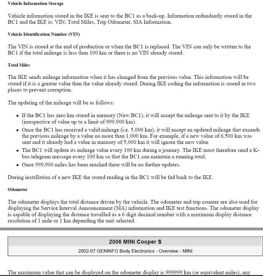

@A383Wing
The VIN in KOMBI is checkt by BC1.
If there are differenes, you`ll get a fault message.
You have to flash the VIN an Mileange by changing Clusters

The Datas are stored in MINI not like on BMW in a separate EEPROM. They were stored direct in Chip. And this Chip is secured. At the moment I only found one tool that is able to read and write without fault. 2900$ + Adapters for connection. 🤮
The bad guy 😡

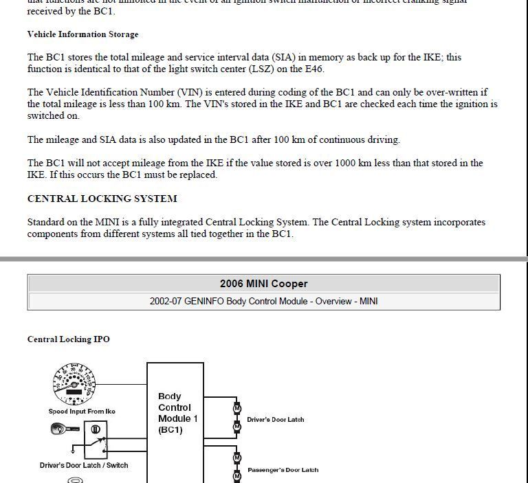

1: my understanding is the kombi has a write once eprom chip for the vin, the dealer cannot get around this, neither can ncsexpert. I searched a bit and never found anyone that could erase the vin so ista-p could program it as a new module
2: if your new kombi had different options (dsc vs asc) you need to address this in ncsexpert, dump the old module, and then dump new module and make sure the options are setup the same, then use ista-d to reset the steering angle

the oil temp/pressure is fake anyway, it's a calculation in no way connected to reality. I would imagine the pre-facelift ECU does not have the tables, so the kombi wont see the data no matter what you do.
you can program modules without the radio with the dealer software, I've done it, and it sounds like they did it too, and it's not "through the stereo"

A few guys over on the BMW side with the same chips seem to have de-soldered their originals and put them in replacement kombis with success.
I wonder, where would you find someone who's really good at soldering chips? Like a computer repair shop or something?
It'd be neat to use the chrono pack I got but that extra 20k miles is just a non-starter for me.

you could get pre-facelift nav with 2 gauges that's what I retro fit into my 2005 single gauge and stock speedo, be careful with the asc settings when mixing facelift and pre, they are different
then I removed the nav and stuck a Pi screen in its' place, runs my racecapture data logger

Pretty sure its that big 112 pin MCU. Not so sure my soldering skills are up for that challenge either! Haven't had a chance to do much digging. A quick scan in our forums doesn't reveal much, but the bimmer forums do bring up some info.
[EDIT]
Here is the data sheet for the chip - https://www.nxp.com/docs/en/data-sheet/MC9S12C128V1.pdf
I have a hot air rework station, if this is the chip it's only 15 $ and looks easy enough to reflow (lot easier than BGA), any way to be sure it's this chip?
