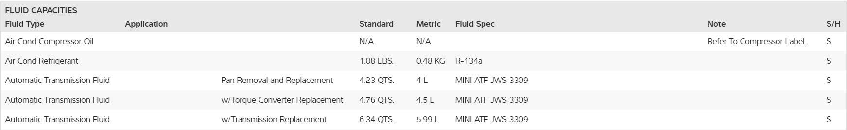

This is the specific fluid you need for your transmission.
From Mitchell1

Valvoline import multi-vehicle full synthetic ATF

Interesting! That's for sharing that! I'll bet the Valvoline is a lot less expensive too!

Yeah, the Valvoline ATF is currently half the price of the Mobil ATF on Amazon.
