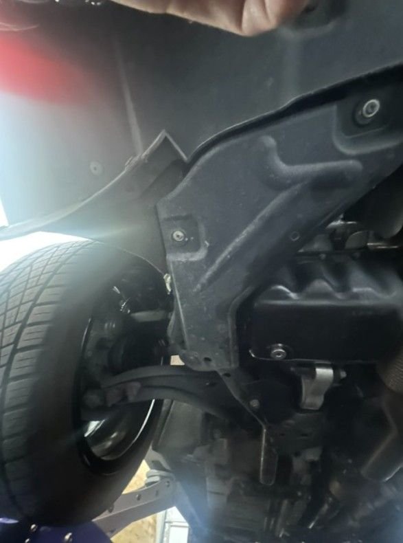

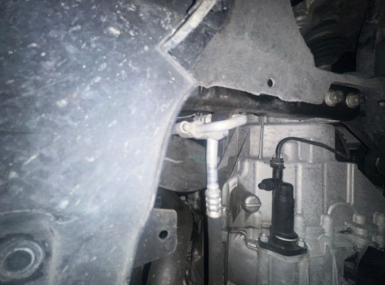

Changed the oil a few months ago, and noticed there wasn't a lower engine cover on my 2015 Roadster S. I see a bracket on the right front, but not one on the left. Just bought a new stock lower tray, and it didn't come with any fasteners. Looked at Splash Shields for 2015 Mini Cooper | Mini Parts Direct and couldn't find where they list the left bracket needed to attach the lower cover. Could anyone help me with this?
Right side in place:
Left side missing:

Your 2015 Roadster is a 2nd gen Mini. That lower cover is for a 3rd gen Mini. Its not going to fit.
On the 2015, there is no left side lower cover, and only the small lower cover on the right side. If you want a full under tray, then you need to upgrade to the GP2 tray:

Last question. Will I need to remove that solo stock bracket in my picture above, before installing the GP2 Cover?

This piece? Yes.
