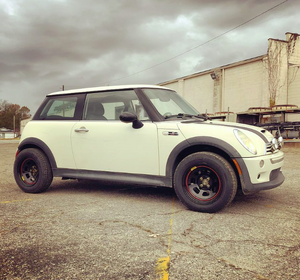

Clicking on this thread,
I expected to see something like this:
Hopefully they will settle --- I've read some previous threads where that was the case.
Maybe someone with personal experience can weigh in.

I was expecting to see a photo by OP similar to this. No photo to humor us so I have to find one. Harder than I thought.

I know I needed pics, but didn't have an opportunity to take any last night.
Any of the above would be good representations of what I felt like I had. Hoping it looks better in the morning light.

OK, looking at pictures, I may be exaggerating... but from the driver's seat, it feels noticeably taller.
BEFORE:
AFTER (trying to get as close as possible to the same shot; camera is a little lower this time, I think, which might make the fender gap look bigger?)
Struts are definitely seated in the knuckle fully. What a PITA. Glad to hear I'm not the only one that found these a challenge to get into the knuckle. That's why I don't really want to do it again!
Original mounts were in surprisingly good shape. No tears, not deformed. The dealer told me during the PPI that the towers were mushroomed... Not by much, if at all. Had no problems getting new plates in without having to do any 2x4 straightening of towers; you have to put a straight-edge on them to see any deformity (the PPI was money well spent to give me a heads up on the kind of service I could expect from the local dealership :( )
Things look a little better in the light of day... It's not like I've got extra $$ to burn to change out everything if I don't like it.
