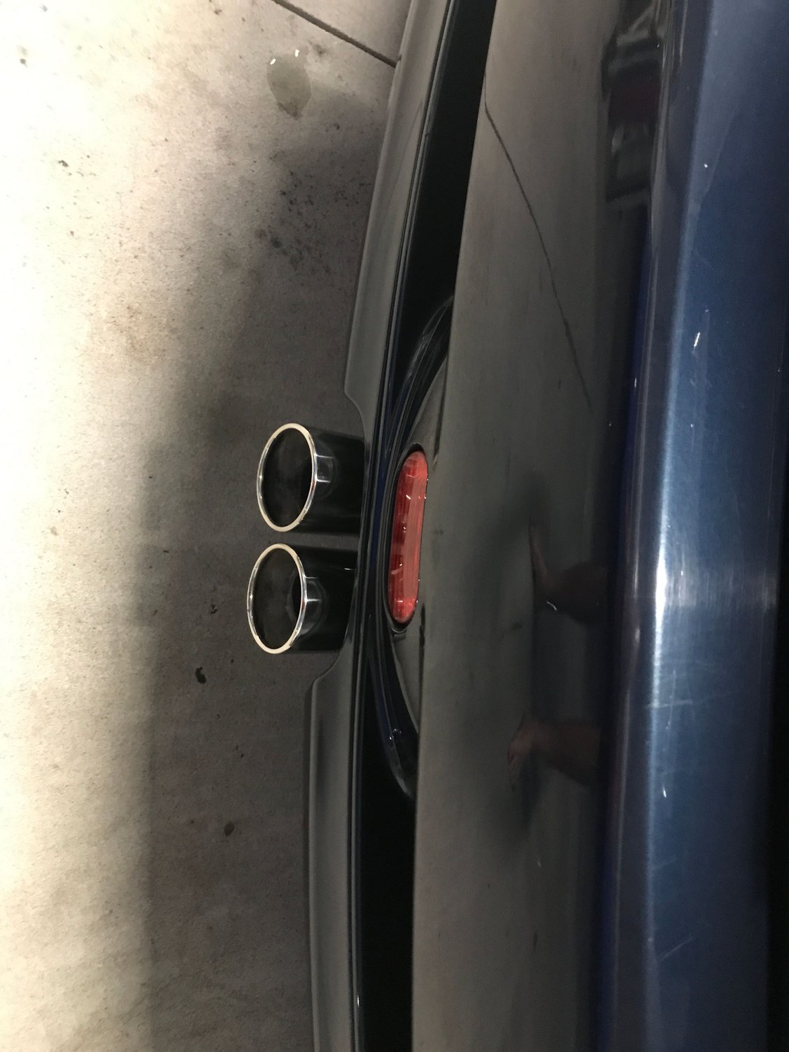

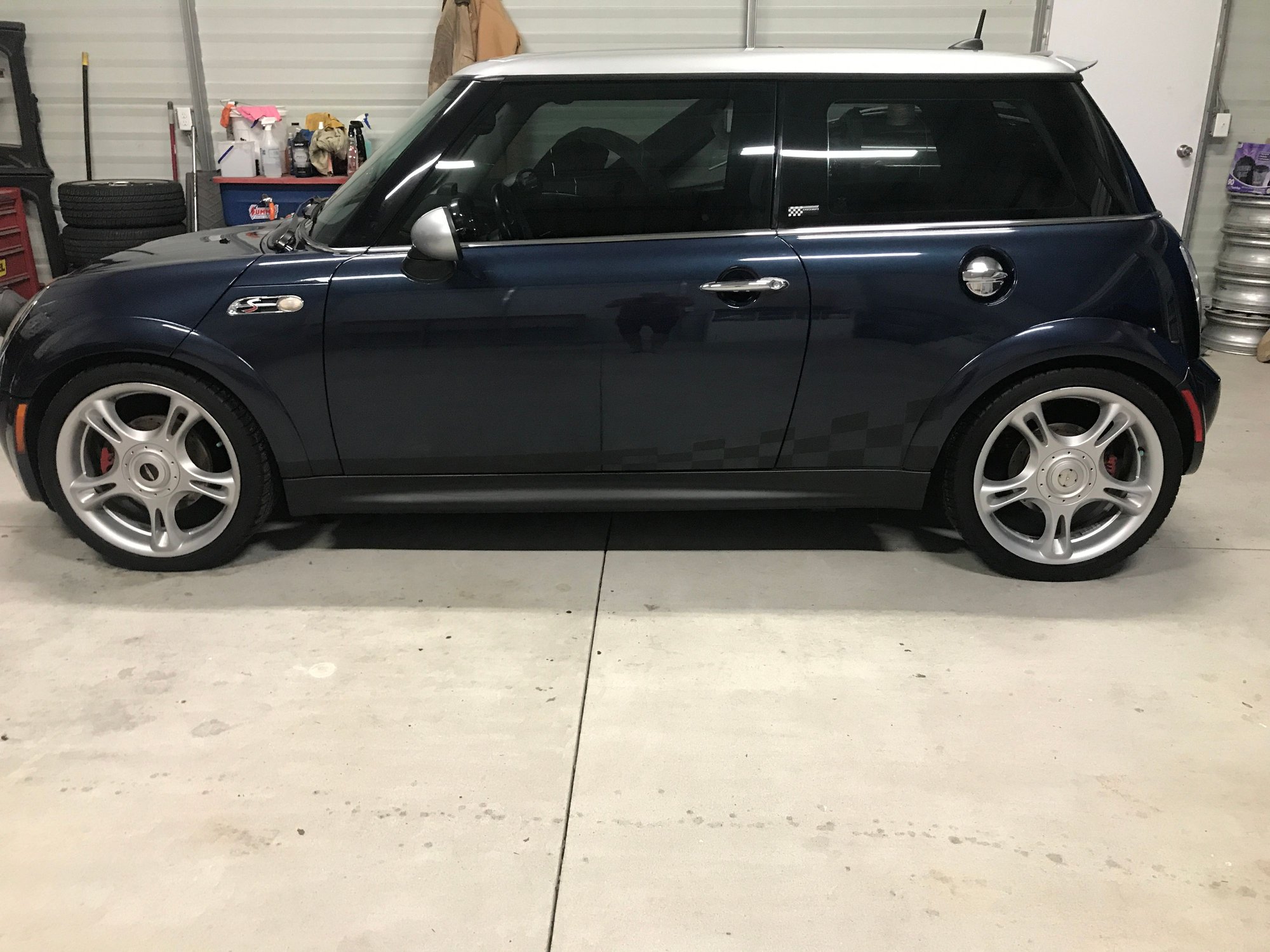

A couple days ago I put the JCW R95 wheels on my car to make sure that the wheels ran true. Before I put them on I put on the JCW springs, rear sway bar and sport exhaust tips. Well today I washed up the car and cleaned the wheels after about 3 months of neglect and I have to admit these wheels are growing one me. I have two sets for sale my R98’s and these, and whatever one sells first I will keep the others. I just wanted to say how well the JCW springs ride with the B4’s I am sure with the car being lowered it will wear out the shocks faster but well worth it.
Over the past week I have put all of the part from the parts car on my car minus the JCW brakes, I am waiting for the cash to buy the rotors. This cars looks and handling have changed a bit from just the little bit I have driven it, I am in love with this car again....I have installed the armrest, factory shift light, auto dimming rear view mirror with home link, rear foglight,alarm and the sport tips. These are the reason why I bought the parts car, and now just waiting for the program from Germany so I can code all the added stuff.

I have to say I really like the look of the car with these wheels, and yes Black is the way I will go if they don’t sell. I ordered some rotors and brake pads go I can get the JCW brakes put on next weekend

I love the space blue arches and the ghost checkers at the bottom! Very nice...

I'll be honest, I'm not a fan of the wheels.... but as mentioned (didn't even notice them at first), the colored arches and the checkers at the bottom are SPECTACULAR! Nice looking car!
