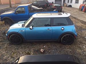

So hello everyone I just pick up a Mini with a blown head gasket for 500 bucks, with lots of knowledge of v-8 engines I decided to complete the job myself so here is where I was to where I'm at now
1. The car was running making noise around supercharger --- Investigated and found issue was prob water pump PTO which caused the head gasket issue
2. I found I was right purchased another supercharger at a good price on this one was from 2005 with good gears
3. So did the head gasket however I replaced and or upgraded the following
A. New type supercharger 2005
B. Head gasket with ARP head bolts torque to ARP directions
C. New water pump
D. New thermostat with Housing, when I removed old housing there was no thermostat
E. Upgrade to 17% pulley, Belt, and colder plugs
F. New Belt tensioner
G. When I was replacing Head used mini timing tool and replaced timing chain guide rails and new chain tensioner
H. Cleaned throttle position sensor (throttle body cleaner)
I. Cleaned intake (throttle body cleaner)
J. New oil
H. New Coolant
Here is where I was
A. Every time Started the engine idle jumps to around 1500 comes down then runs rough
B. getting throttle codes being too high or to low a and a few MAF sensor codes
C. After seeing really rough idles verified all items with MAF and throttle
D. after a series of clearing codes check engine light went out but I still had a rough idle
Here is where I'm at
A. Thinking possible valve issue I pulled valve cover check the timing mark and verified torque on (rockers keepers) sorry don't know what the exact name is / I was a little worried I jump timing as the chain mark on the chain itself I had previously made during the original timing evolution was over like a tooth from the timing tools and sprocket mark. The recent R53 timing question has eased that suspicion a little as it stated the chain will not always line up due to the length of it compared to gears.
B. Pulled plugs found 1 and 2 were fouled and 3/4 were fine
C. Found I installed the fuel tank evap valve on upside down ( this could be the issue, however, I haven't verified my thoughts it could be this as its connected to throttle body) Will check after a compression check
D. Will be verifying head compression once I receive compression tester tomorrow.
E. will be getting some 93 octane fuel as the tank is almost empty and I don't know how old it is
My questions
1. Anything else to accomplish besides plugs, belt, and pulley, when doing the 17% reduction
2. What should my engine compression be so I can verify
3. Any ideas what to check
4. Since I never owned one of these how much pressure comes out of exhaust? mine feels like a bunch
Thanks any help is appreciated
