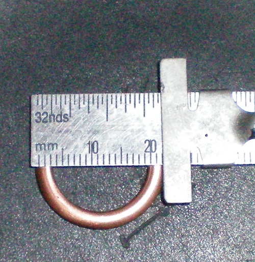

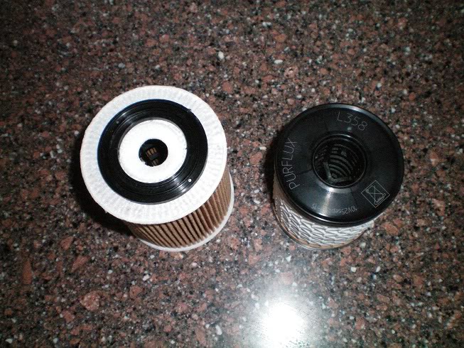

Old Apr 24, 2016 | 10:44 AM
Capt_bj's Avatar
Capt_bj
Posts: 7,037
Likes: 283
From: Melbourne, FL
Size:  107.6 KB Name:  100_0081.jpg
GEN1 filter left ... GEN2 right
as mentioned GEN2 comes with a copper crush seal
GEN1 does not as the plastic seal is built into the bung and the bung should be new each time . . .
note - these are both OE filters
