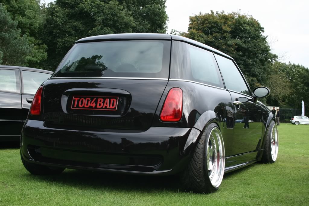

Can somone tell me what taillights these are (I'm specifically interested in getting rid of all of the chrome accents on my 04 Base MINI) and also what front bumper? I think it's the AERO front - but doesn't the AERO have holes for lighting???

Those taillights are just factory MINI taillights from 2002-2004. They introduced a new design with the facelift in July of 2004, which I assume is what you have. Those taillights integrate the reverse lights into the bottom corners of each light, and the rear fog lamps were moved to where the reverse light used to be. So if you want that older style, you'll need to do some rewiring to get your reverse light to work and the fog lamp if you have that option.

Both look like factory lights that have been "Joey" modded. You take the lenses off, paint the parts you don't like, then glue back together. The aero bumper looks like the parking lamp holes have been filled, or the lenses just painted or smoked. I can't see the pic too well on my phone.

^ I think that might be the best answer bc I couldn't find the factory lights that look that smooth even when I searched only for the 02 models. Thanks for that.
I'll get AERO stuff ordered and on the way. I'll be running some fogs up front. Thanks guys!!!!

Hard to see, but it looks like he added aftermarket brake ducts in place of the fog lights, too.

Another interesting this is that I can't see an exhaust on this at all. I'm pretty sure it's a base - but maybe he has a turn-down under the car.

Yea the taillights are early model 2002-2004 joey modded.
https://www.northamericanmotoring.co...ail-lamps.html
Then its a Cooper ( NON S ) 2002-200 hardtop with the factory aero kit. There is a kit w/ and w/o PDC, PDC is the parking distance control, which if you have it there are 4 sensor in the bumper cover already. If not you dont have it,

They are stock tail lights. Not modded except for application of Red Lamin-x.
