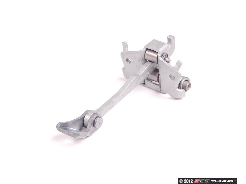

Anyone upgrade the up to 05/2003 door brakes to the from 05/03 door brakes on an r53? Mine are full of rust and creak/groan when you open the doors. Going to be putting some dynamat and led's in the doors while doing a rebuild, figure it'd be a good time to upgrade these, assuming the newer style are more durable...
More specifically, trying to get rid of these:
up to 05/03 (pn#51211166471)
https://c1552172.ssl.cf0.rackcdn.com/303679_x800.jpg
In favor of these:
post 05/03 (pn# 51217176811)
https://c1552172.ssl.cf0.rackcdn.com/329404_x800.jpg
Anybody? Will likely require some modding, but who doesn't love the chance to cut on their baby with a dremel?

Yea, there is an older design and newer design
https://www.northamericanmotoring.co...eck-strap.html

Thanks ECS. Have you heard of anyone upgrading?
Seeing as you've likely held both parts, do you see any reason/need to upgrade from the old type to the new type? Are they more sturdy/durable or is a swap not worth the hassle?
Cheers!
Old Apr 7, 2016 | 08:06 AM
Posts: 36,762
Likes: 2,551
Welcome,
Not yet , one guy tried and said it worked. But never showed pics
The new ones are smoother then the older design.

The holes that the brakes go through on the pre 05/2003 door shells are smaller than the post 05/2003 door shells. You would need to make the hole in your door shell slightly bigger to upgrade to the 'newer' style door brake. We have plenty of them available used and can ship first thing on Monday if needed. Here is a link to one we have showing on our website!
