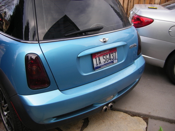

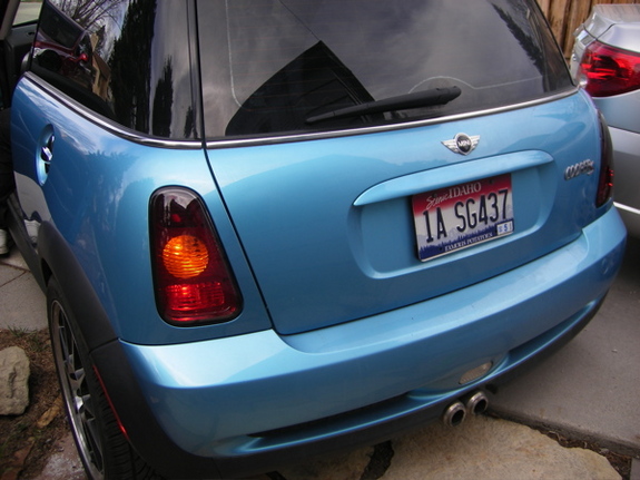

I de-chromed the waist line on the MINI and then had a go at de-chroming the tail lamps

are those OEM euro spec tail lights? here in the states there isnt a clear area at the top
Yes they are Euro spec lamps
The late 2004/2005 Euro model had these lights with the top lamp/lens orange.
The 2006 Euro model the orange section was changed to clear/white.
The late 2004/2005 Euro model had these lights with the top lap orange.
thanks for the info
you know, if you ever feel like getting in there again, you can actually remove the chrome with a little mineral spirits/denatured alcohol
just food for thought when you run out of things to mod
thanks for the info
Thats cool
I need a second set of tail lamps now
