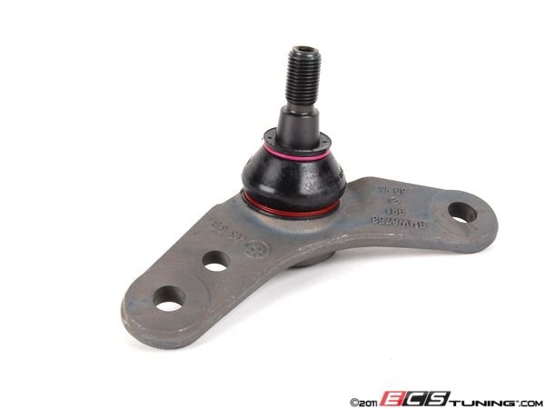

Get it all done at once , this is what i did : 31106779437 & 31106779438
https://www.northamericanmotoring.co...ll-joints.html
