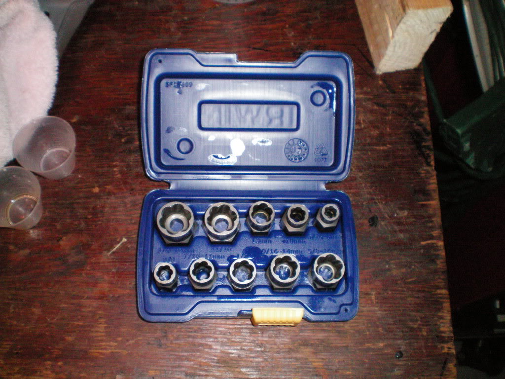

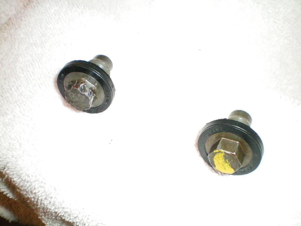

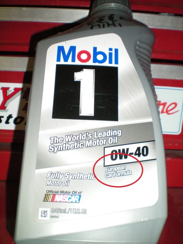

Old Jul 3, 2015 | 02:17 PM
Capt_bj's Avatar
Capt_bj
Posts: 7,037
Likes: 283
From: Melbourne, FL
for your consideration
